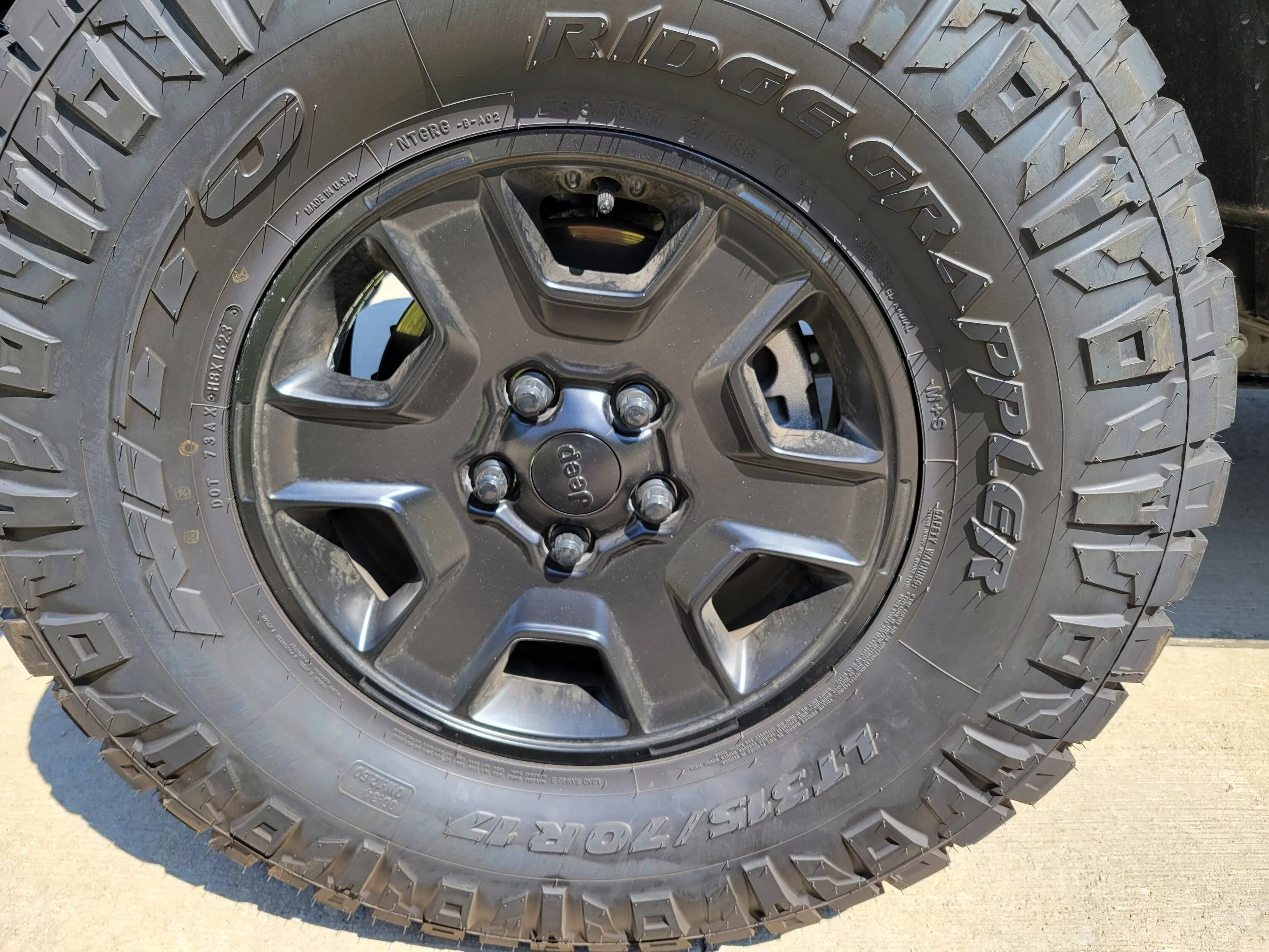

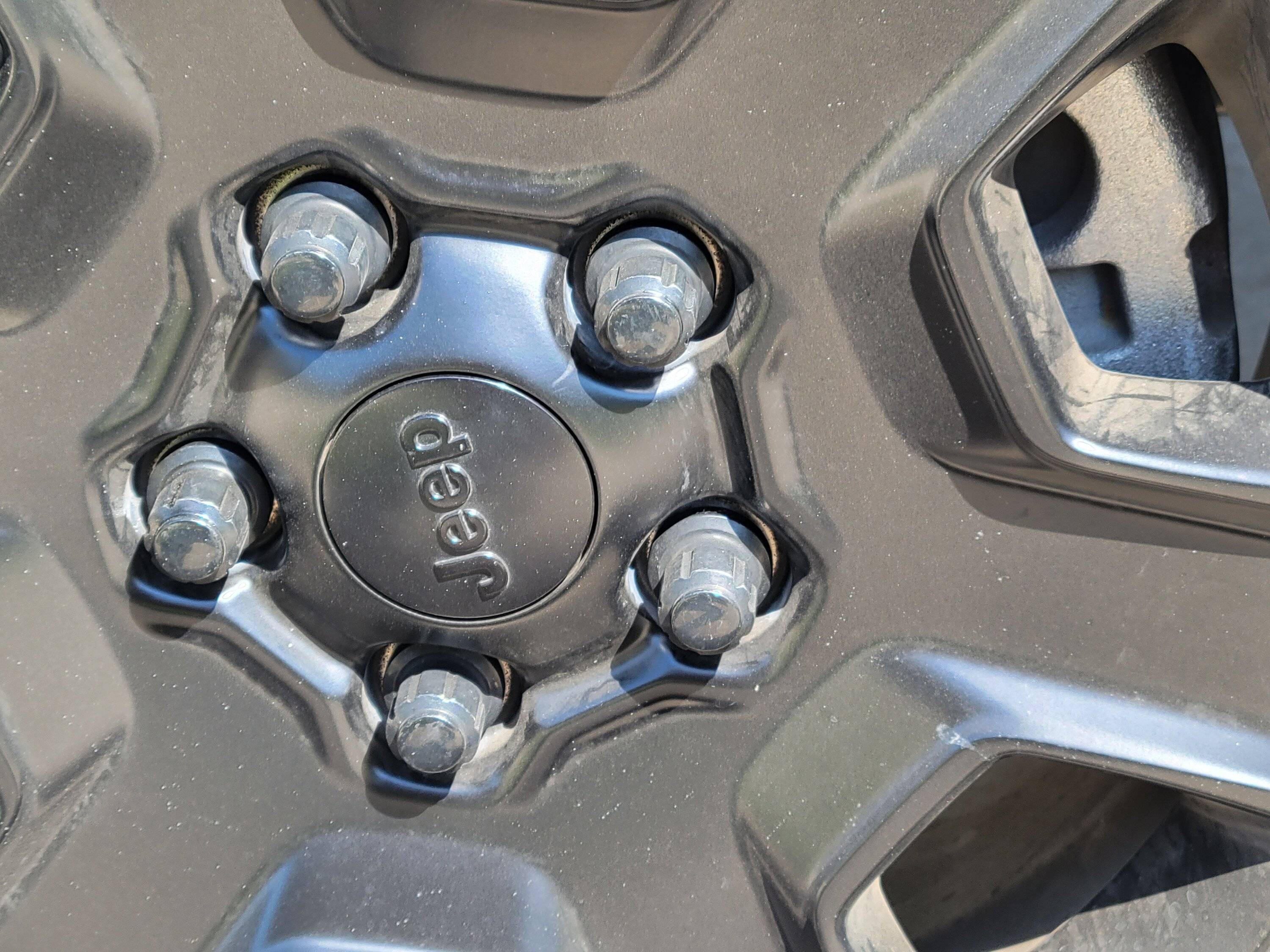

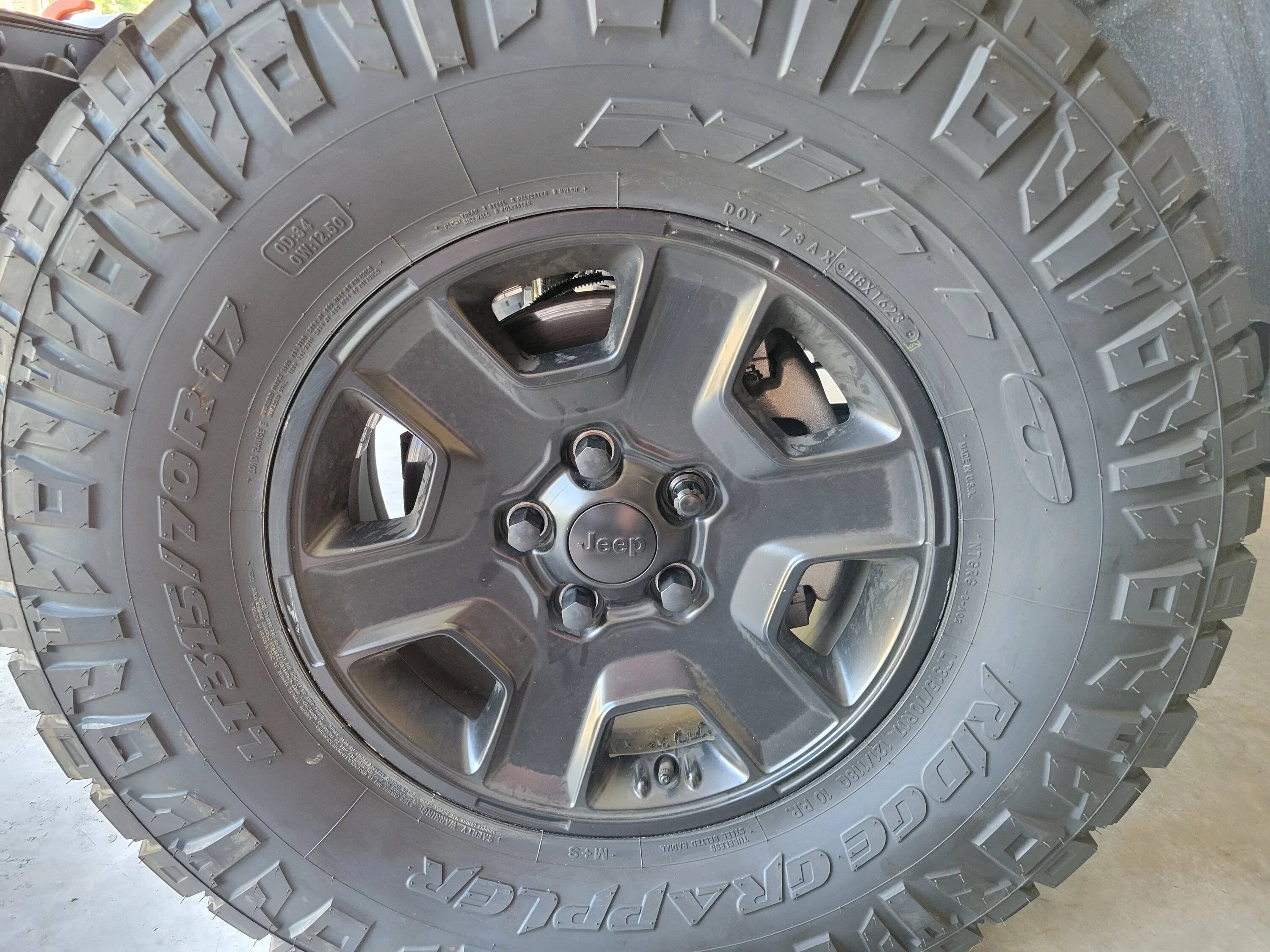

For my Mojave (Black, and It needs a bath), I went with this set of (20) all spline lug nuts, basically all locking lug nuts from Gorilla Automotive (96643BDX).
(20) black spline locking lug nuts for every wheel lug, for Stock wheels.
Gorilla Automotive Black Factory Style Wheel Lock System
