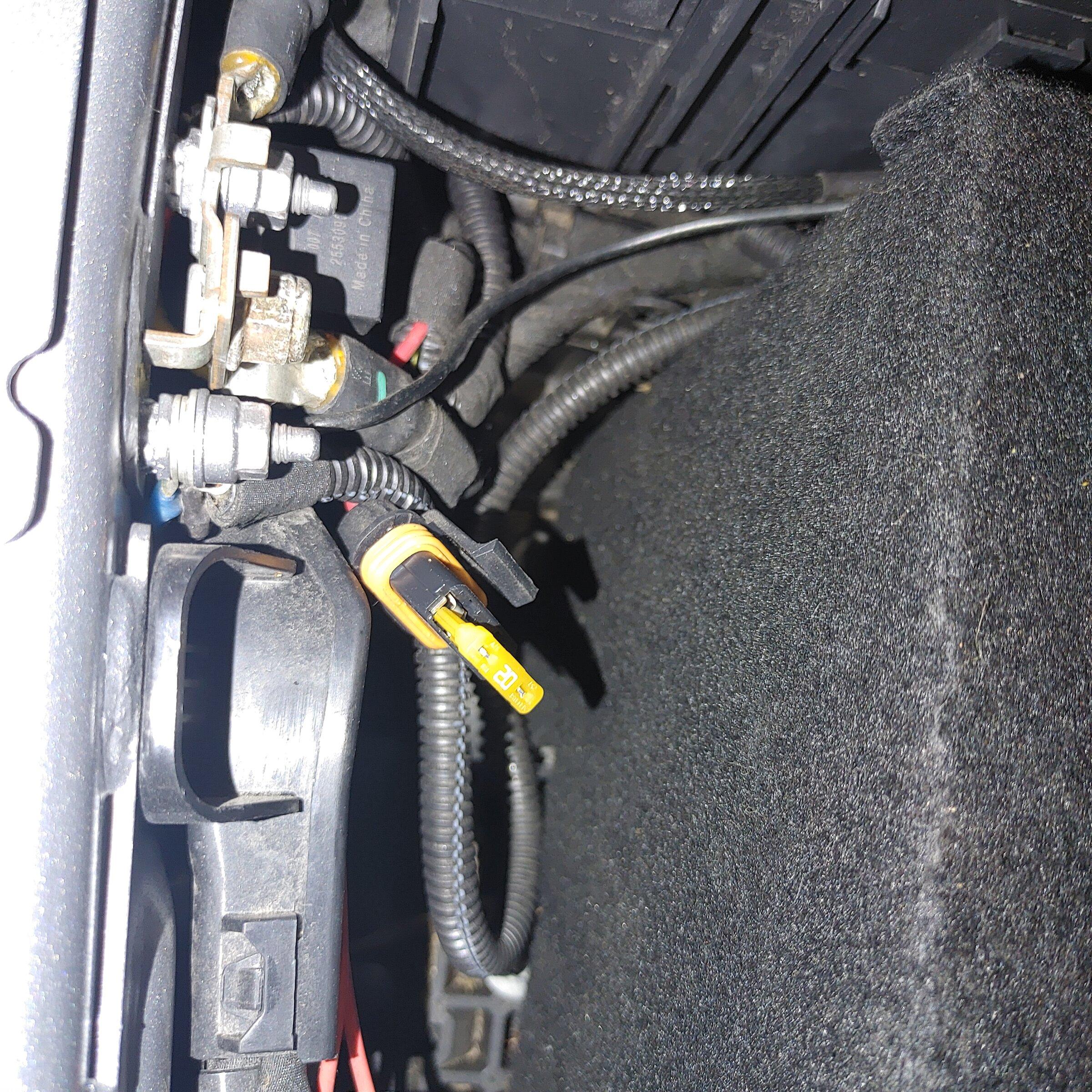

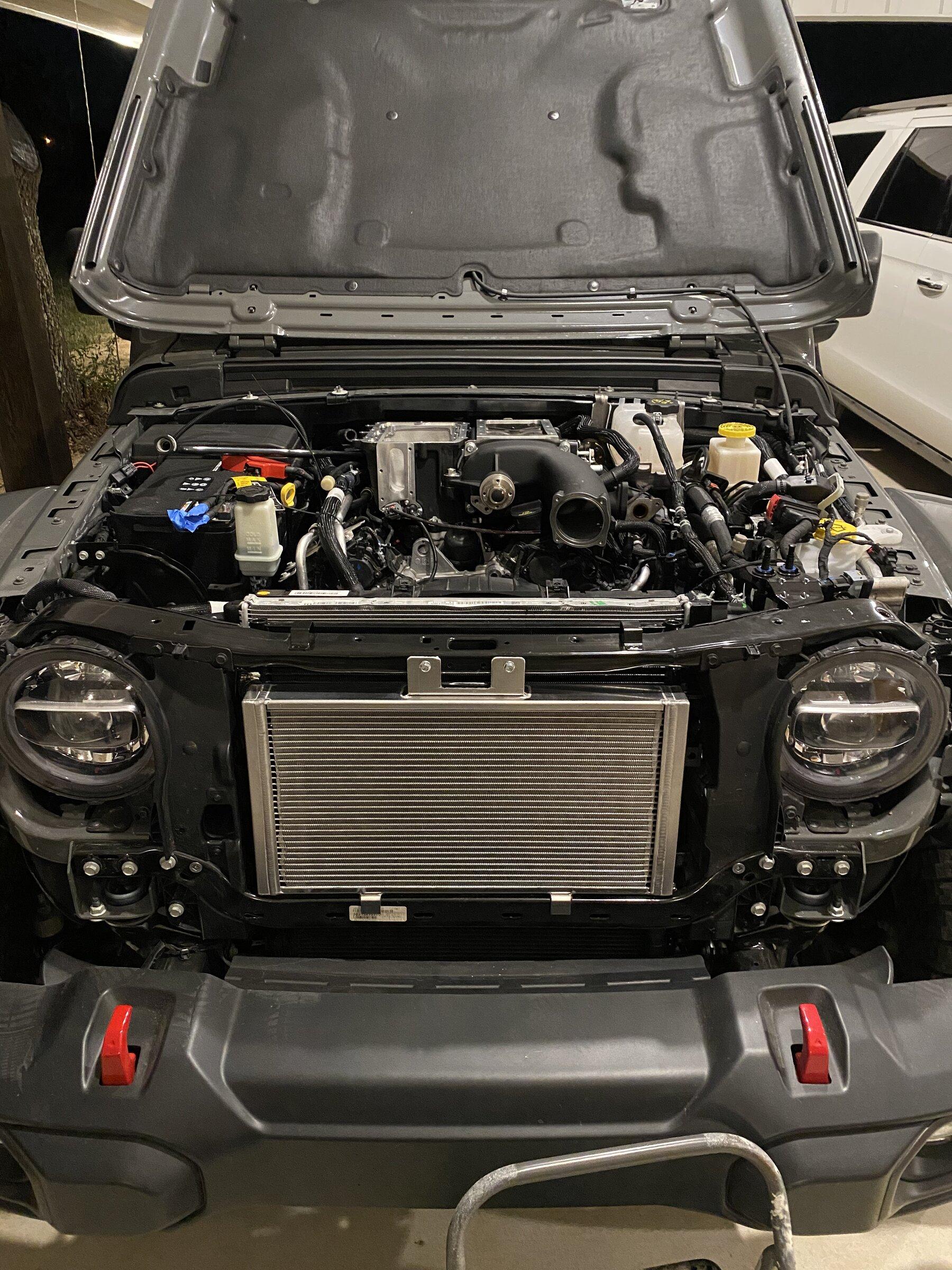

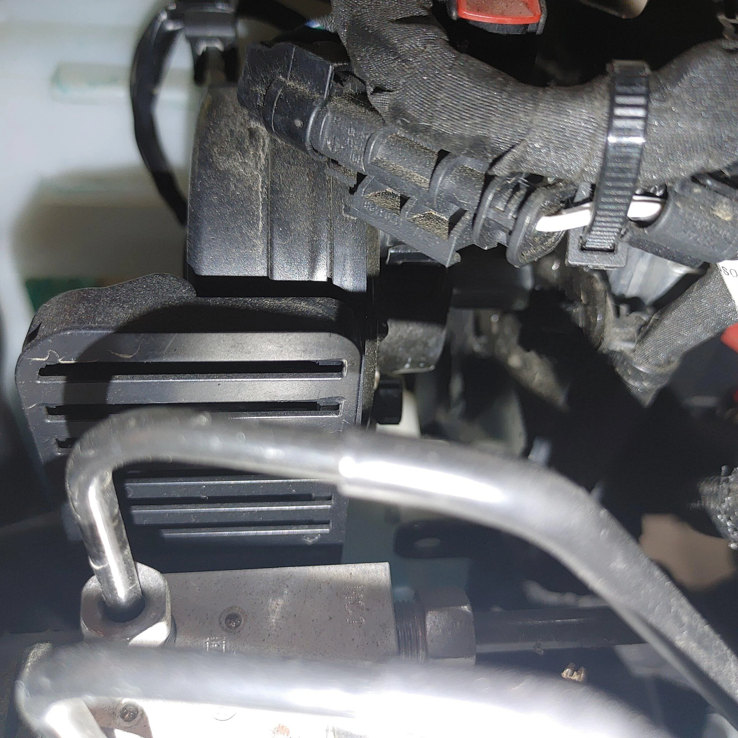

Got further along in the install today. I called it quits after I got the upper intake manifold on. My kids were ready for some attention, so Iā€™ll probably finish up tomorrow. I have a couple of questions for anyone who has experience with this install.
1. During the wiring process, the manual says ā€œInstall the provided 30 amp fuse for the I/C harness into fuse housing. The kit I have came with a 15 amp fuse. Anyone know what should go in there? The online manual says 15 amp.

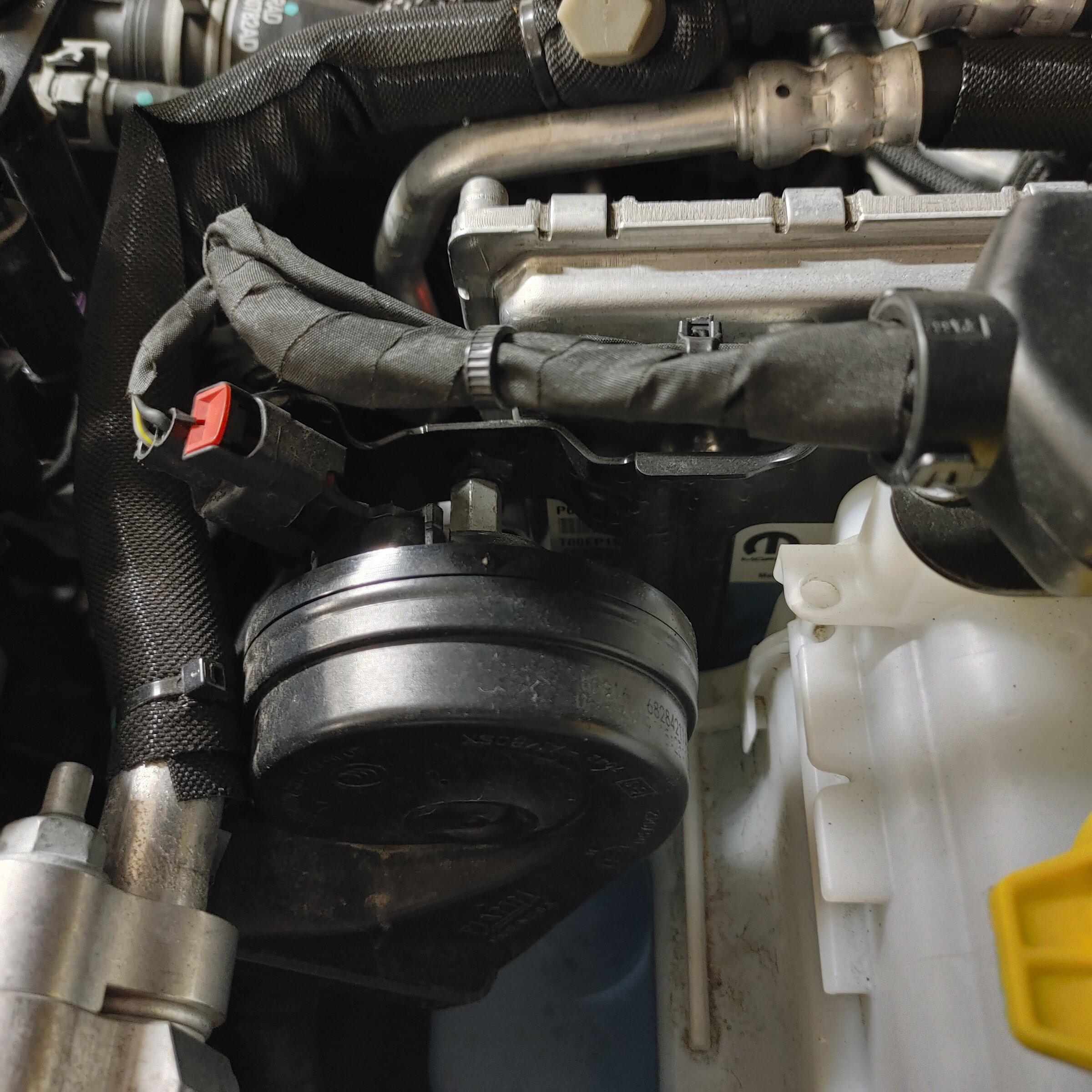

2. When relocating the horn, the manual says ā€œuse a 1/4ā€ drill to increase the size of 2 existing unused holes in PCM mounting bracket.ā€ I donā€™t know if it is specific for ā€˜21 models, but there is definitely no unused holes on my PCM mounting bracket. How did yaā€™ll mount the horn, or where did you relocate it.
Thanks for everyoneā€™s help.

Excuse my language, but today was a real bitch. I realized I forgot to install the spark plugs after I gapped them. Off comes the upper intake. I get them installed, and as I am re-installing the upper intake, on my last bolt, I drop it right right into the engine. Off comes the upper AND lower. I get the bolt out, and as Iā€™m putting the lower on, I strip a bolt. My torque wrench was set correctly. Anyway, after a trip to town, I got the lower and upper intake installed, and Iā€™m back to where my day started. So I got the supercharger installed and thatā€™s it.
On a bright note, my small pulley came in from Magnuson, and the correct Timken pulleys should be here tomorrow. Maybe my ECM too. That would be great. As long as it doesnā€™t blow up when I first start it, I will consider it a success. Big thanks to Dave for providing the photos on horn placement and what fuse to use.

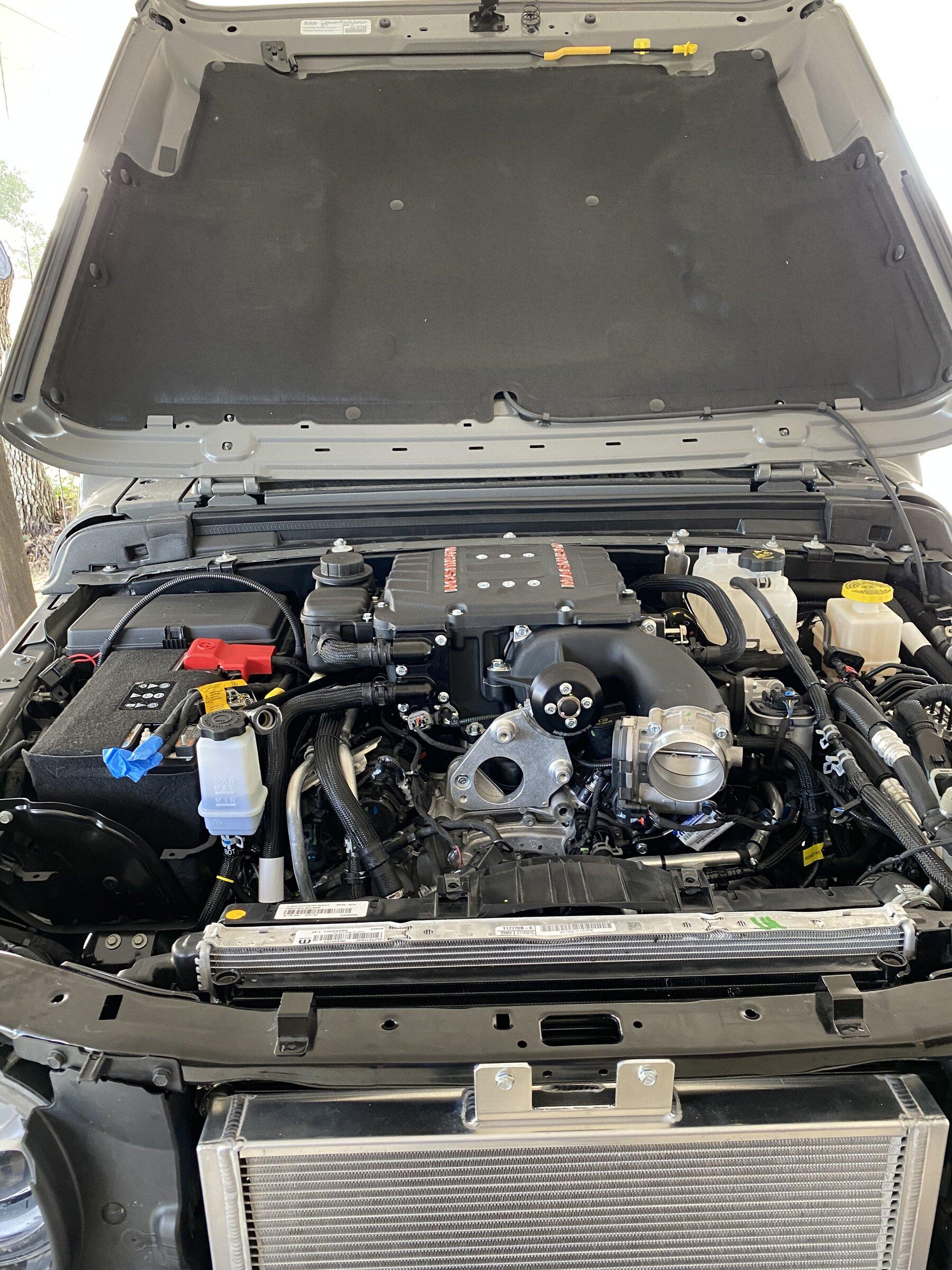

Got to work on the install today. Between watching kids and looking around for where I sat my tools down, I made it to step 92ā€¦of 282. Installation manual is great. They estimate it takes 10 hours to install. For someone like me, Iā€™d probably bump that up to 30.

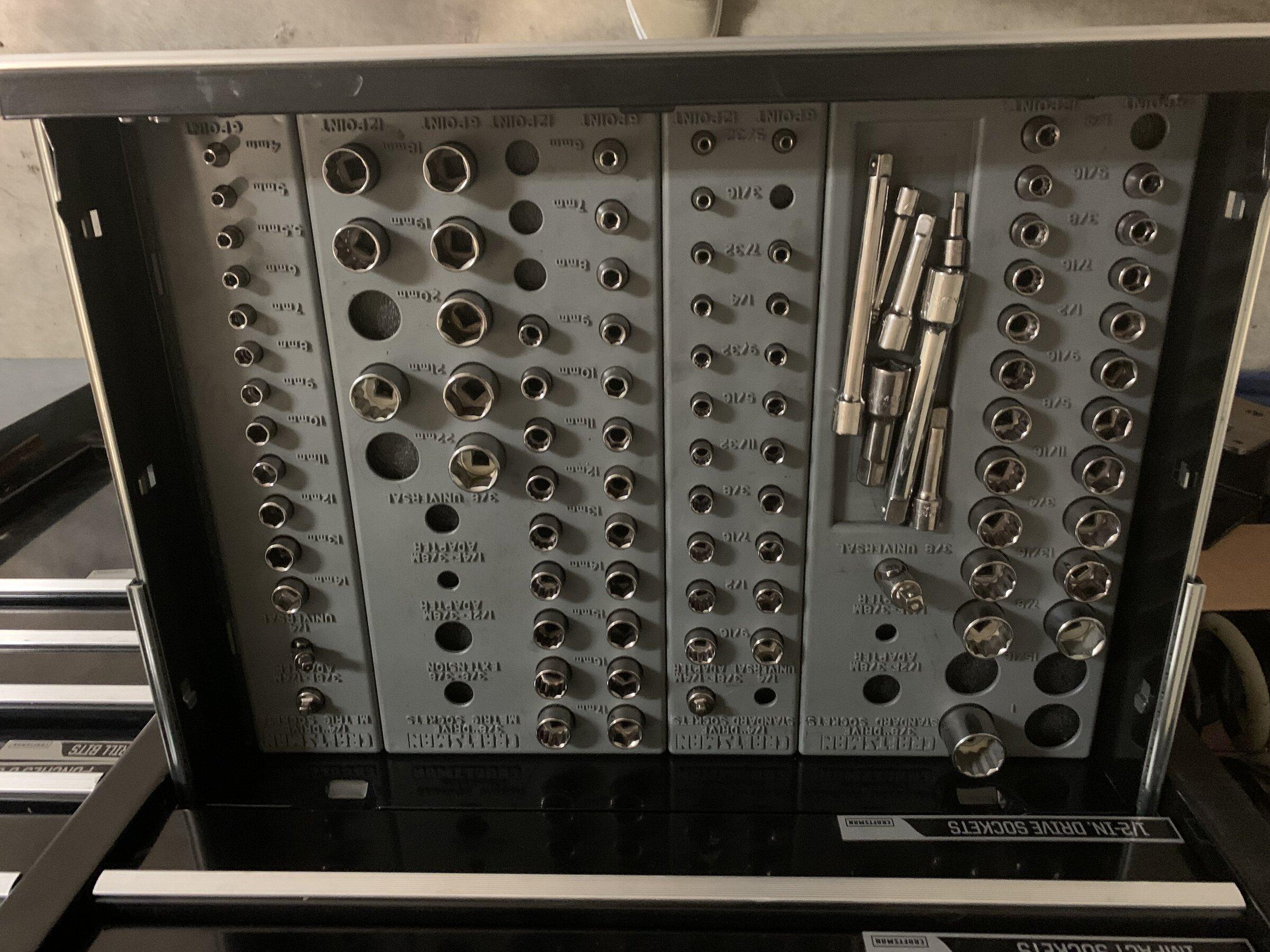

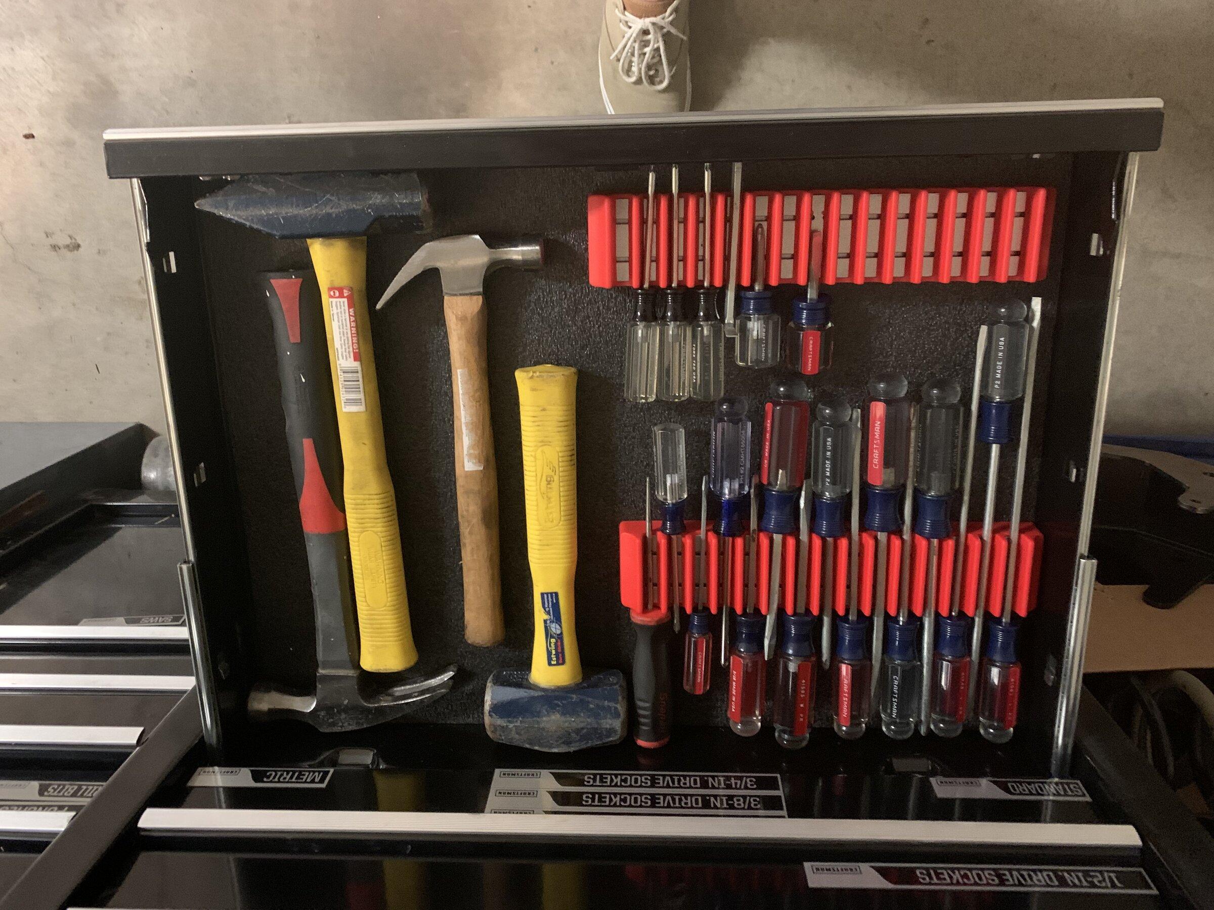

Looking good for sure, I want to use Daveā€™s tune, however never done any tuning before so a little apprehensive about it, Iā€™m sure Iā€™ll pull the trigger eventually. Reading your post though the line about tools, lol got me thinking of mine and how I became a little anal about them:
Thatā€™s a hell of a tool kit. Every time I start a project, I have the best intentions of keeping up with my tools. I always get a little lax about 3/4 of the way through. I am good about finding it all and getting it put up when the job is complete.
