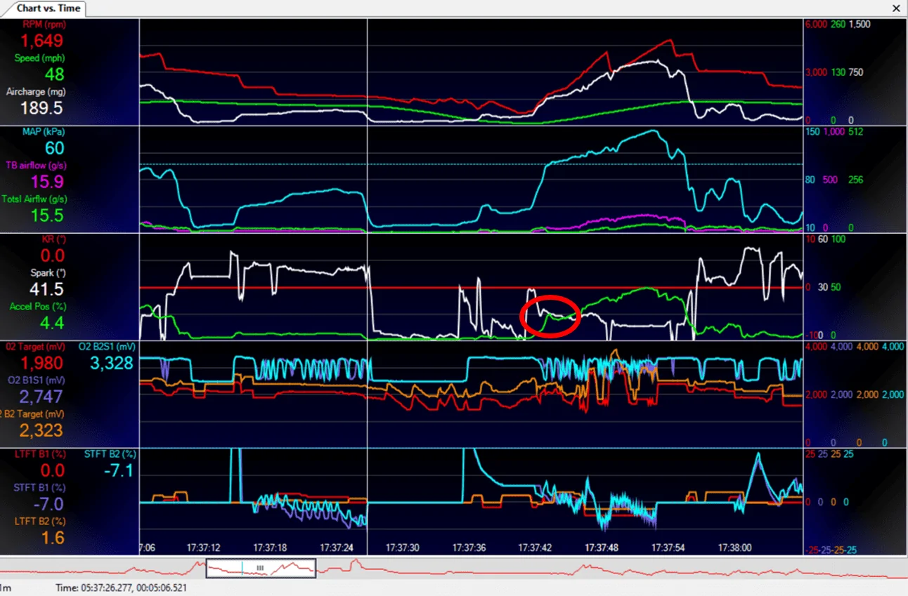

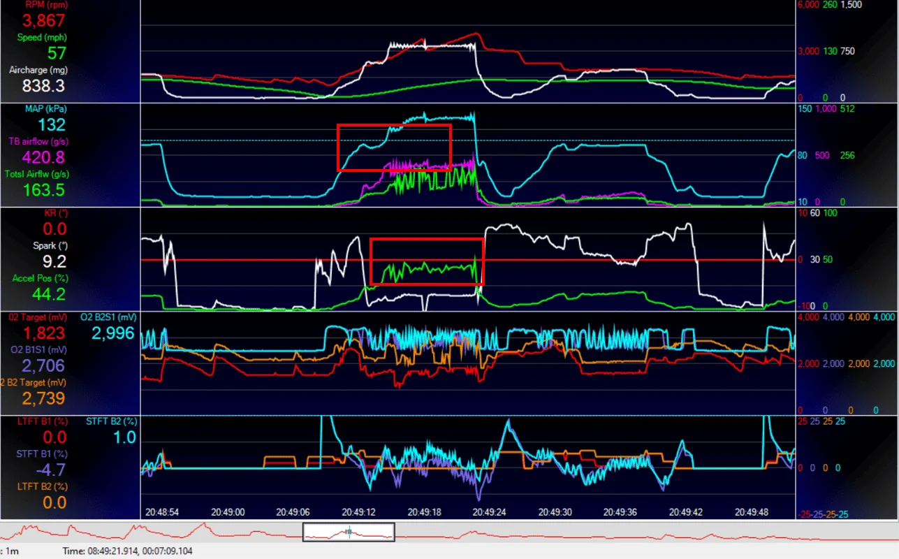

Got something cooking! Latest work I have one surge I am working on, but that is it, no oscillation and look how smoothly it transitions to boost. It feels awesome, except for the quick wick on the throttle it just soar through the RPM at part throttle. Just managing the transition to the bypass valve now. No stutter. It makes steam and lots of it. The graph below shows the throttle oscillation that shows up in my previous tunes as you transition to boost. The trick has been getting throttle feel off the line that is progressive and does not lag and then take off. The challenge had been that once you have that linear progression the throttle would go unstable as it went from vacuum to boost. This felt like misfires but actually it is the throttle blades fluttering open and shut.
Jeep Gladiator Magnuson TVS1900 Kit Available Now Evo 15
Jeep Gladiator Magnuson TVS1900 Kit Available Now old tune

Am looking forward to testing Davecs1 s tune! I live in Colorado and got my SC installed 2 weeks ago and I have to confess that I am less than impressed with the drivability of this thing... big surge at 2500rpm and massive oscillations between 3 and 4K rpm. Not sure if this magnuson tune was made for the flat landers but definitively doesn’t work so well in the mountains !
