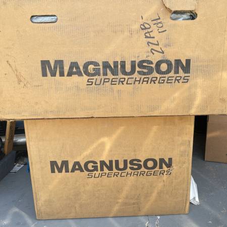

Hello,
I have a new Magnuson Supercharger for sale and magnaflow exhuast. Looking to get $6200.

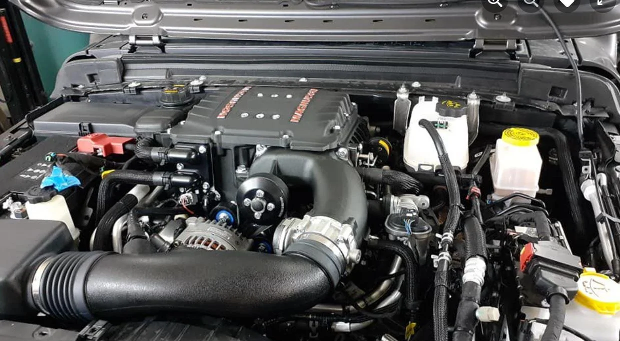

Jeep Gladiator Magnuson TVS1900 Kit Available Now 00v0v_2pffnROKD6iz_0t20t2_600x450
Looks better installed.
