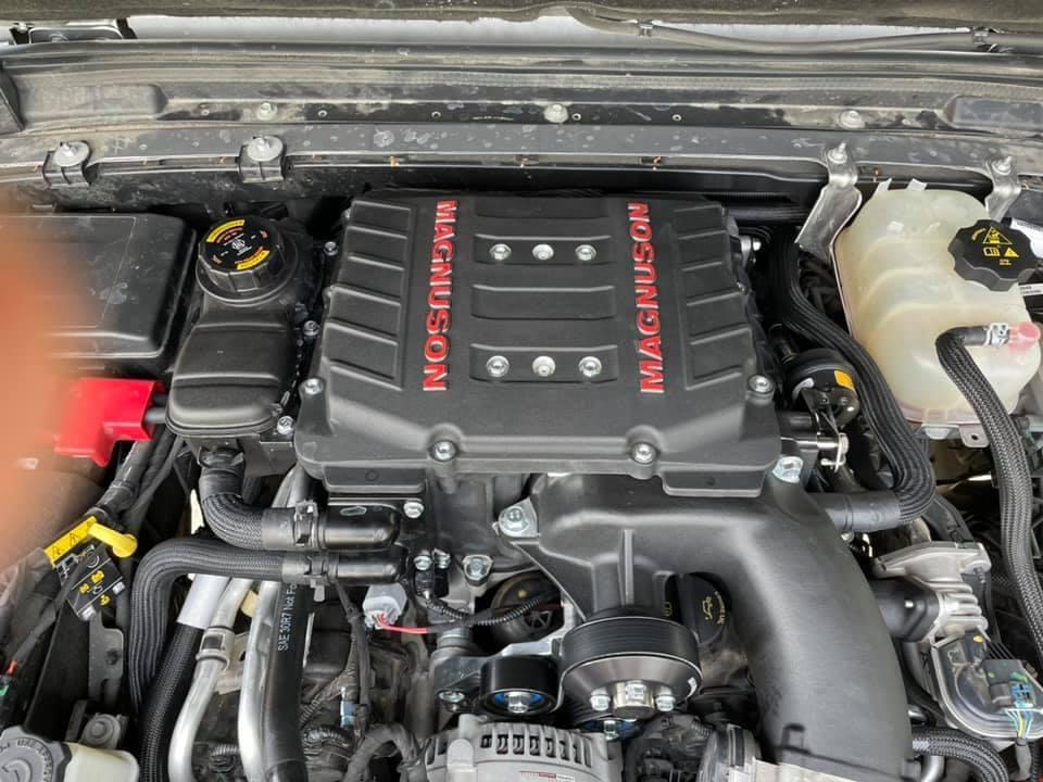

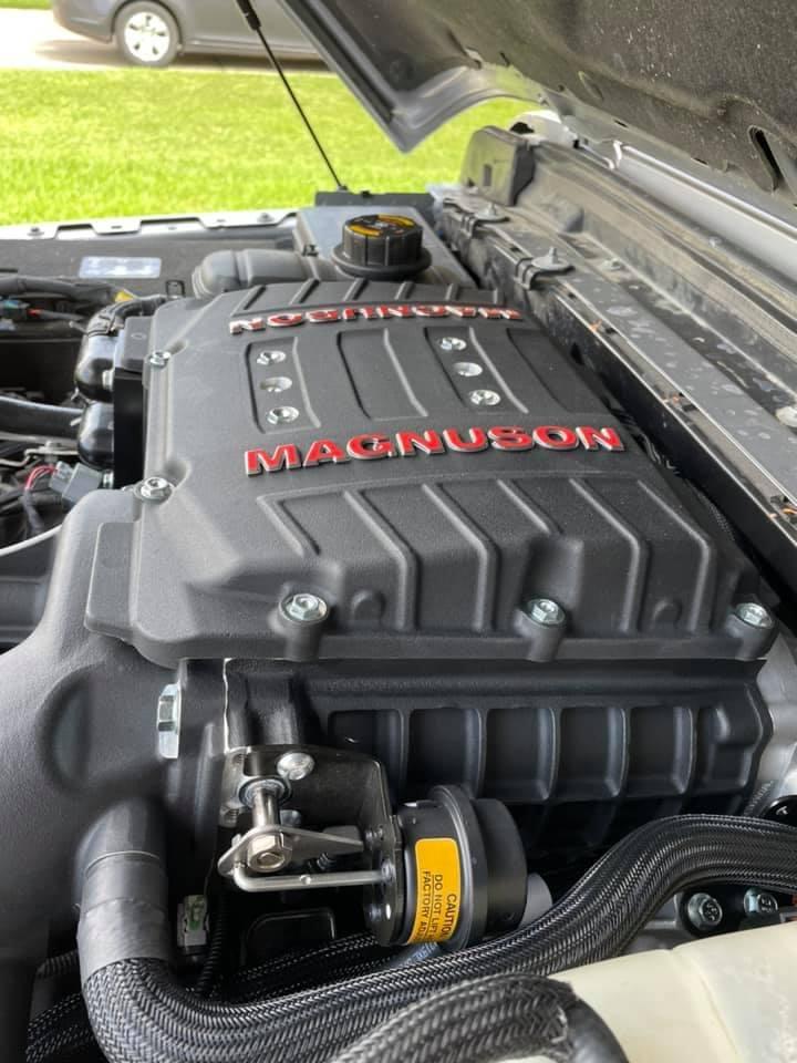

Picked up my Gladiator yesterday. Not sure what Magnuson has done to the tune, but the skinny pedal doesn’t require to be feathered to drive. The JT drives like it did before the supercharger was added. If you need the extra power you need to press the skinny pedal to get into boost. Nobody will accidentally get into boost, unless you have the intention to utilize the extra power of the Magnuson Supercharger. Have only driven the JT for less than 100 miles, so far. Is currently happy with the results.
Jeep Gladiator Magnuson TVS1900 Kit Available Now 4A1BA645-607A-4A6F-AF61-E6287FC6D17D
Jeep Gladiator Magnuson TVS1900 Kit Available Now 7F501E12-14D5-42F9-9AF2-52B46AD0B457
DAVECS1
David
Jan 24, 2020
56
1,861
2,538
Peoria, IL
Nice looking install! The latest 2020 automatic Magnuson tune is acceptable, and will work for most. Glad to hear everything is going well I know you have been working on getting this done for a while.
