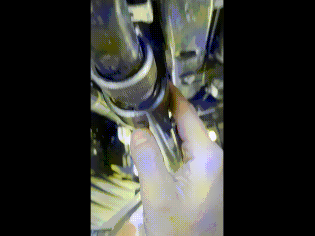

I experienced a major tire wobble, reminiscent of the death wobble during my LJ days. I was getting onto the highway, hit a bump going about 45mph when the front tires started shaking uncontrollably, forcing me to slow down. A few hundred feet later and back up to speed, the same wobble returned.
I recently installed the Mopar lift and adjusted the steering wheel alignment. Upon closer inspection, I noticed play in the Drag Link Adjuster Clamp. It was torqued to spec at 34 ft lbs. Here's a quick clip of the amount of play:
Jeep Gladiator Major tire wobble and cure {filename}
I had to go up to about 65 ft lbs for any play to disappear. No wobble since.
