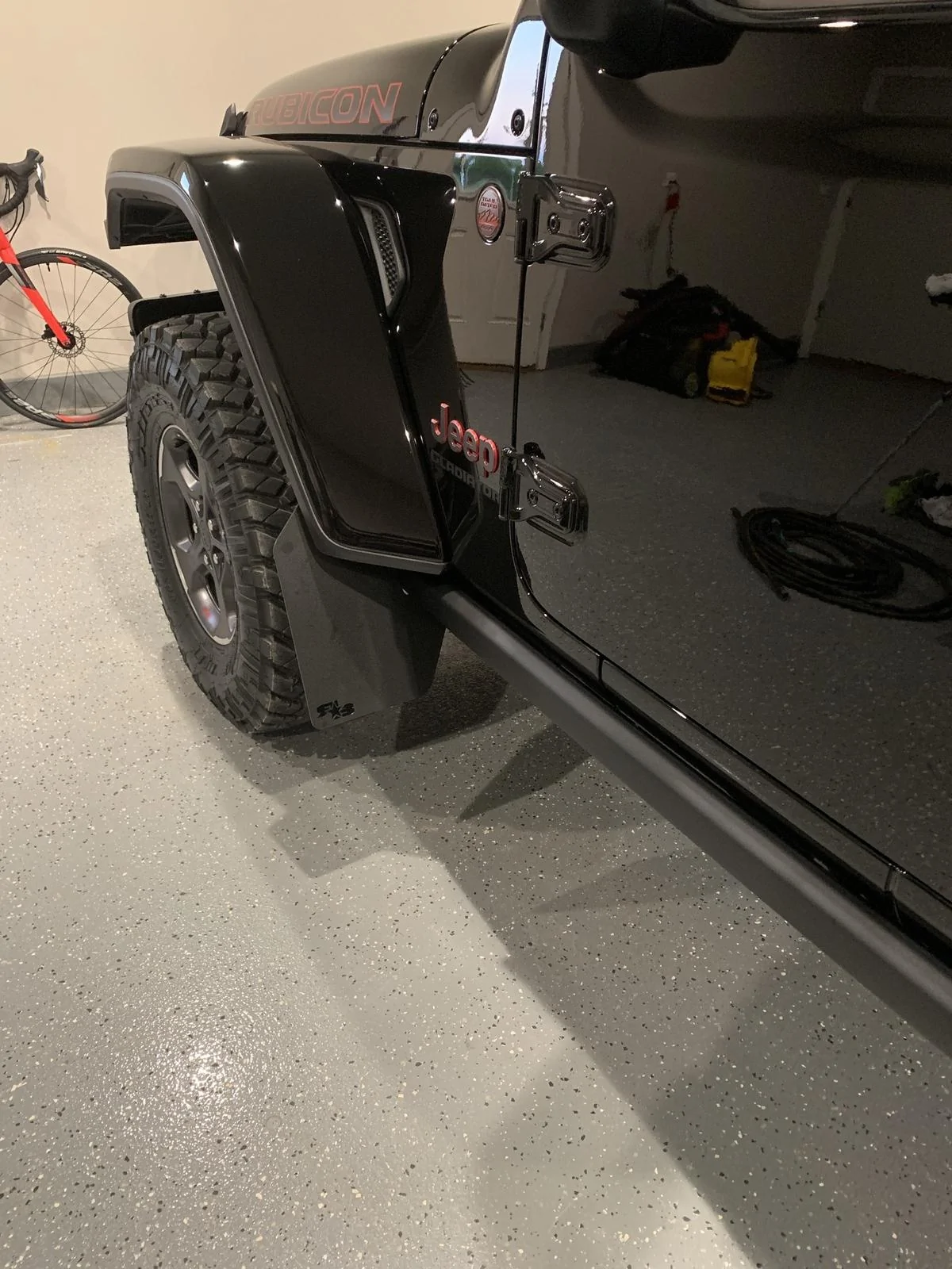

Nice one. You're a man after my own heart. I've got a black manual Rubi in JB status right now. What are those mud flaps you've got in the front and do you have a better picture of one side or the other that shows one? Also, where did you get them and how much?
@firemedic2714 i got them here....they don’t have anything for the rear yet....it’s the “XL Front” $79.00
https://rokblokz.com/
