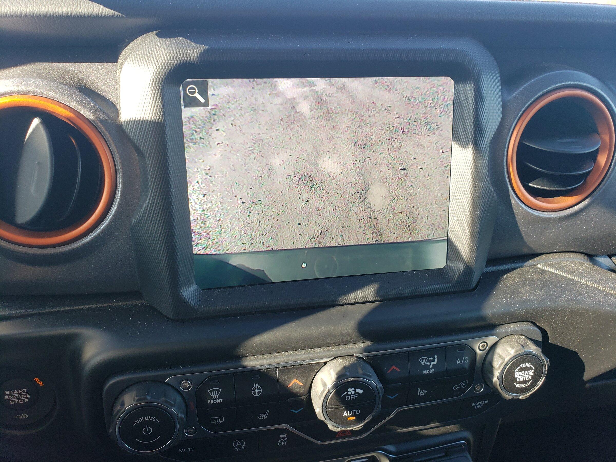

Number 4 is not available with manual transmission with the 8.4 unless you also have front trail cam? What logical sense does that make? You can have it on manual... unless you have the wrong radio... then you can get it back with an option that is completely unrelated?
I just went out and double checked before posting, but my Manual Mojave with 8.4 DOES zoom. (No trail cam)
I can zoom when in reverse. There is no zoom option for me if I just bring up my cam from the apps page, though.
Have you checked when in reverse?

Huh, well mine doesn't work then. I have an appointment with a dealer to check in. Jeep chat said they couldn't help me at all and directed me that way. Thanks.
Back on topic, here is a pic zoomed.
