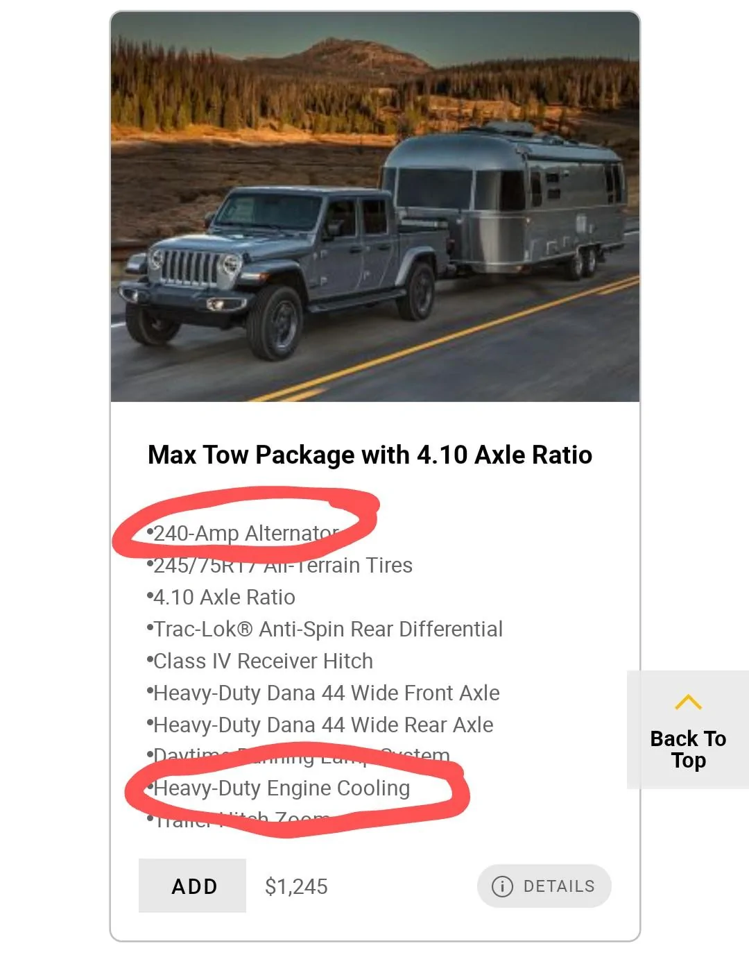

Max tow is good deal, but I have the tow package on my Overland and the max tow wasn’t available and I didn’t consider a sport because I couldn’t get a lot of the options I have and the deals were so much better on the Overland over the Rubicon. Anyway, with my factory tow package, track lock rear end, LED pkg, aux switch group, Rubicon take off suspension ($150), and E load 33s, I’m pretty close to a max tow. I’d basically have it if I put on wheels spacers, or wheels with a different offset, and re-geared to 4.10s. I mean, if you really want to get technical, I probably weigh a few hundred lbs more than a Sport so maybe 7450 tow rating?
I’ve never seen anything that states the max tow has different HD cooling or alternator than my tow package. I’ve seen way too many posts about max tow vs tow so I’ve over thought this.
No details so possible their claim means nothing, but they claim its upgraded.
