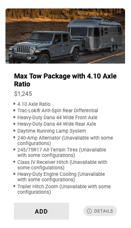

Maybe somebody covered this and I missed it, but I just got a new Sport S Max Tow JT a week ago and curious how I could tell if mine has the trac lock system or not. Would it be on the window sticker? Is it hidden in the VIN somehow or on the data plate on the door? or on the SN on the diff? I'm reading some with max tow have it and some don't so just curious how you can tell short of doing burnouts.
It should be mentioned on your window sticker if you got it.
Add your vin at the end of this addy and you will see your build sheet
https://www.jeep.com/webselfservice/BuildSheetServlet?vin=

Hey new Max Tow owner here! This is my first Jeep and was excited to get the 4.10 gearing and heavy duty tow package. I was a bit bummed that a LSD was not offered or on the window sticker. I figured if I really want it, I'll add it later.. I can turn wrenches so no big deal. Fast forward to today, I decided to come to full stop, hold traction control button down till off and did a brake stand. Guess what two thick lines.
Is it possible the Brake lock differential did this?
I've never had a open diff do this.. I'm kinda happy and confused at the same time!
Yes, that's exactly what bld should do.
