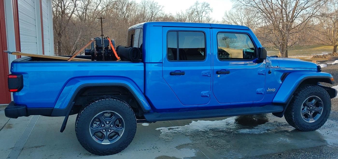

This is my Overland with Gladiator Rubicon tires and wheels.

Nice looking truck. Are those wheels 17" or 18"?
40,445
53,880
Those are the stock 17" Rubicon Gladiator wheels.

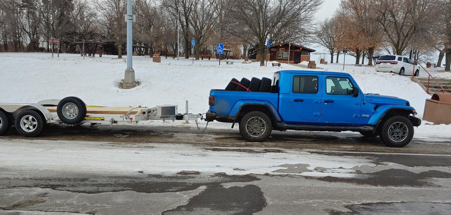

A fellow in Omaha bought a new Gladiator Rubicon and took those off after a couple hundred miles. Tires and wheels are what comes on Rubicon JT from the factory (as long as you don't get the optional wheels and tires)
Pic - coming back from Omaha with the Rubicon tires/wheels and a couple of AMC dealership signs on the trailer.
