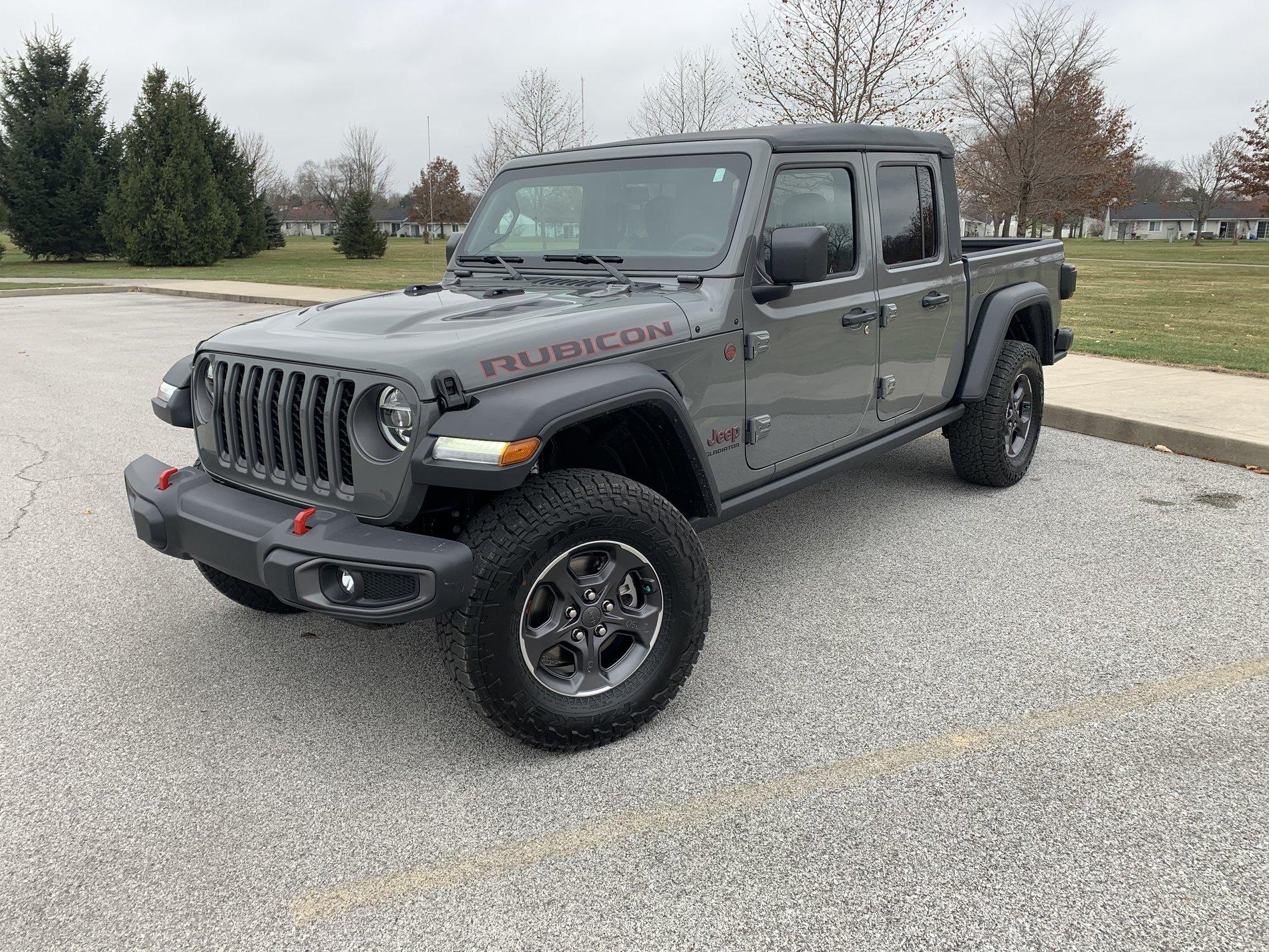

Well I decided the right deal didn't matter and I bought it on Black Friday...
Then my wife who can barely be pulled from her F150 wanted to drive it home...
mac 'so I let her' gyvr
Nice Jeep! Too late to bring this up for your (possible) benefit, but do you have Trailer Hitch Zoom? That is not a part of all Gladiator models. Also, do you have the seven pin wiring connector? And is your hitch a Class IV? Finally, aftermarket hitches built into bumpers are typically are not rated for towing. That is, they may have a hitch, but have rarely been officially tested and assigned a rating. You're at risk if you assume the vehicle rating applies to an aftermarket hitch, and then you have a trailer incident.

Yes it has trailer hitch zoom, 7 pin/4pin wiring.
It has the class 2 bumper hitch. I have a mopar class IV ordered that will be here later this week. Not doing aftermarket bumper.
mac 'will be rated for 7k' gyvr
