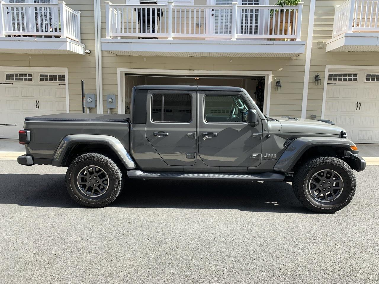

35’s on factory overland rims with a 1.5” spacer and the rough country lift/leveling kit. Haven’t regeared (live in the DC area so pretty flat), but have towed a trailer around 4k lbs. My truck gets into 8th pretty regularly and doesn’t hunt gears. Went with just tires instead of going to a 17” because I like the stock wheels, and the cost savings of 17” vs 18” tires is minimal in my experience.
unpossible that your truck can even move with 35s and 3.73 let alone tow, not gear hunt, and get into 8th.!!1!!1 /sarcasm
Yeah 35s on flat areas and around town is a complete non issue. Glad to hear you can even tow a moderate load with it.
