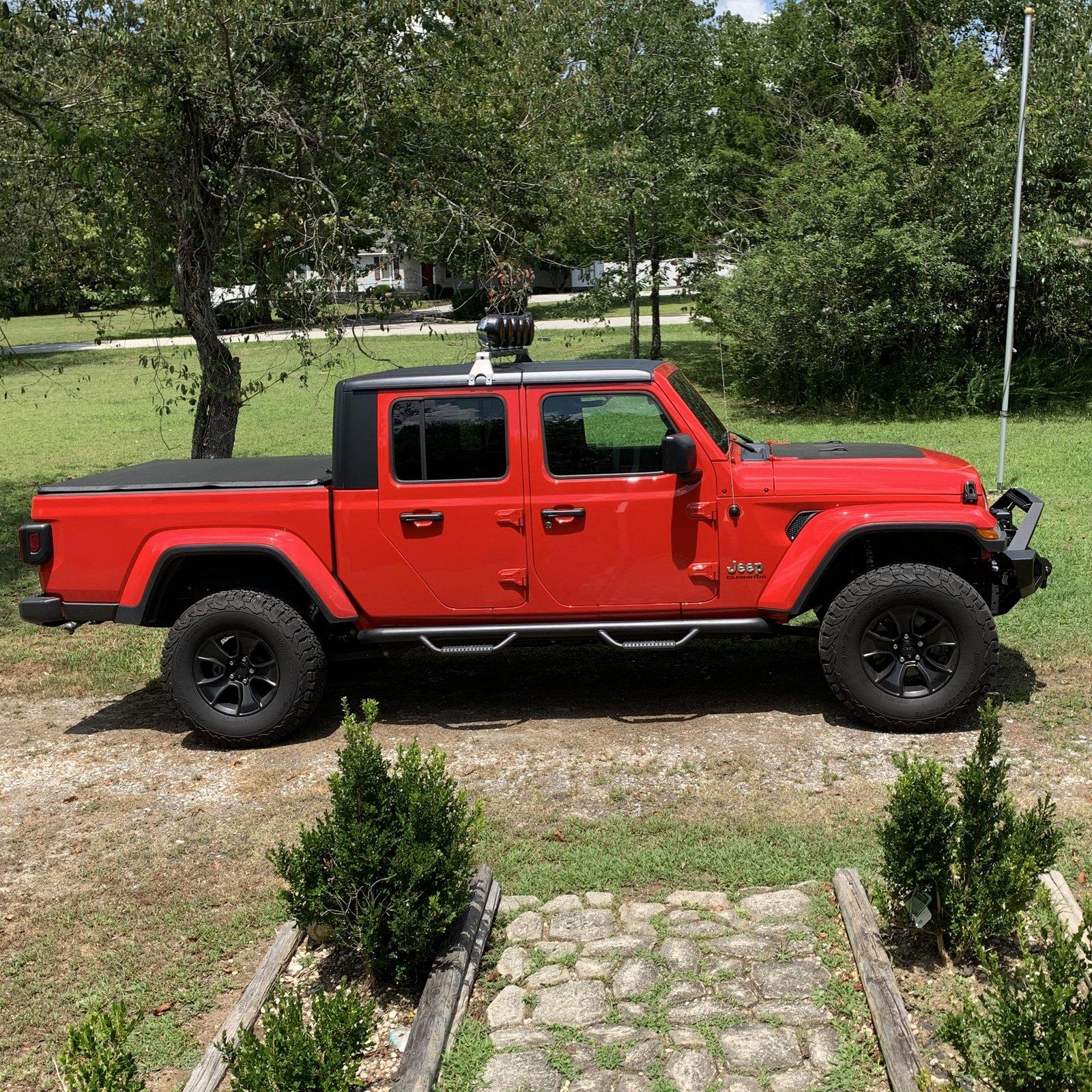

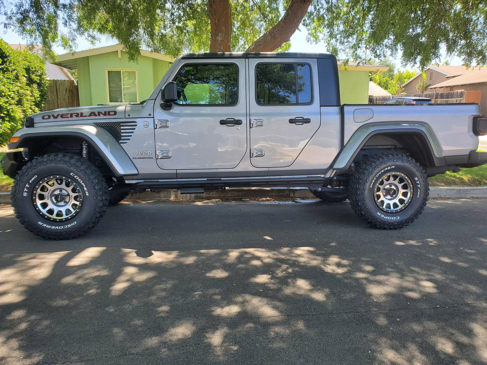

I just put a 2.5" Terraflex lift on my Overland with 18x9" rims and 35" tires. It turned out great and I'm very happy with it. My rims have a 0 offset and they stick out the perfect amount. I think this is a nice setup for a daily driver. If you're not going to regear I would avoid 37's.
What wheels and tires?

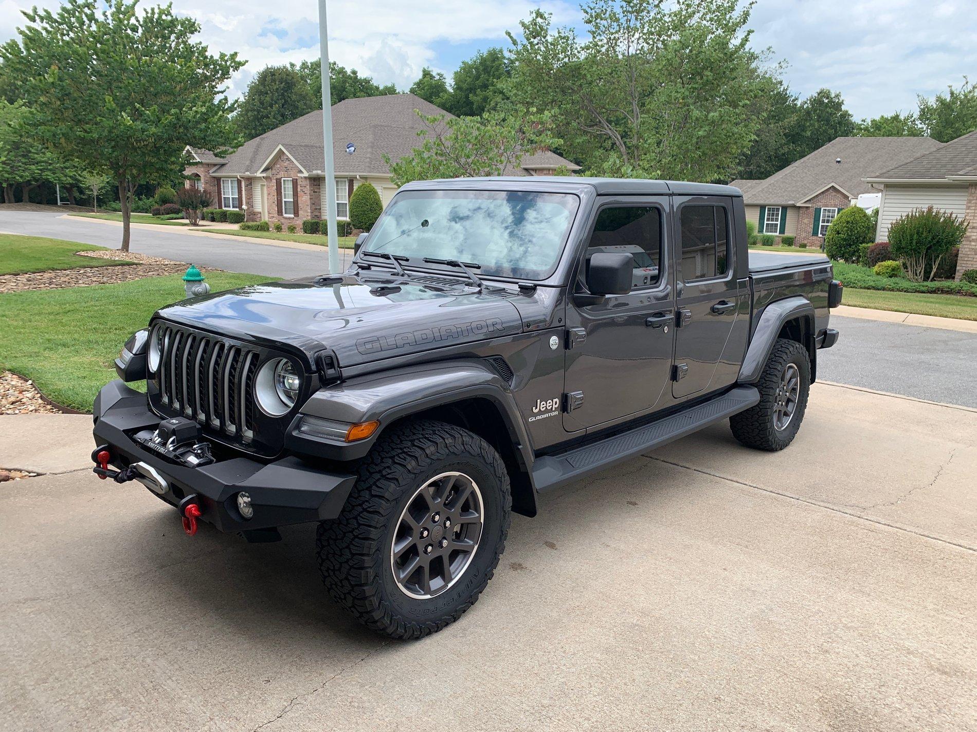

Really like the look of Pescado's truck above but if you have Colorado air and you want to make sure you don't get dusted by Prius drivers....consider my look. No lift, 33 x 12.5 x 18 KO2's or similar and no issues hussling along....

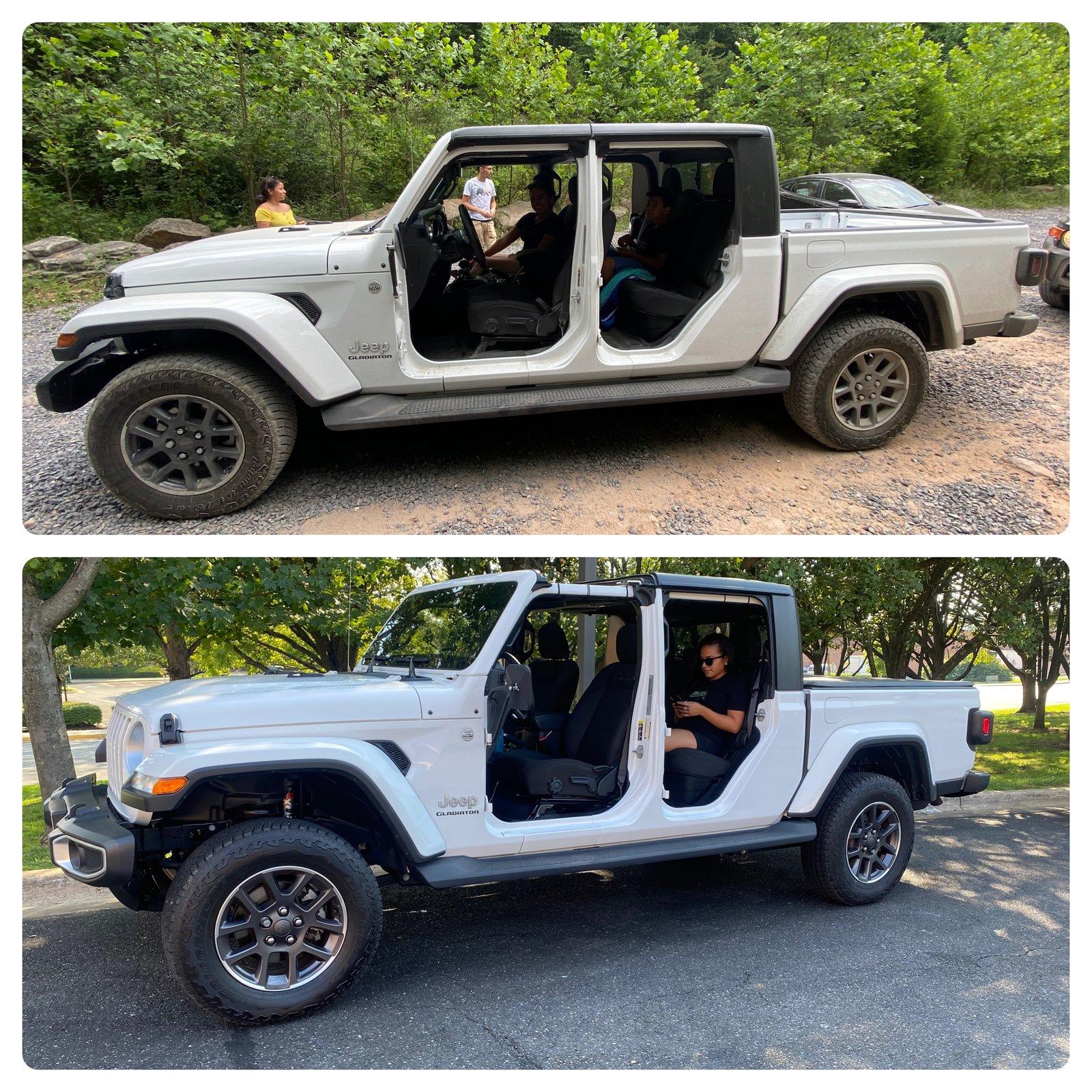

Although i dont have different wheels, i decided to get rubicon take offs and a 1.5 teraflex spacer to run 35 without a problem in my overland here is a before and after.
Jeep Gladiator Overland without Max Tow Package - Lift? Spacers? 6FB7CF12-F06C-458E-9056-56372ED2AAD2
How much did the TeraFlex 2.5 kit actually lift the truck in the rear & front?

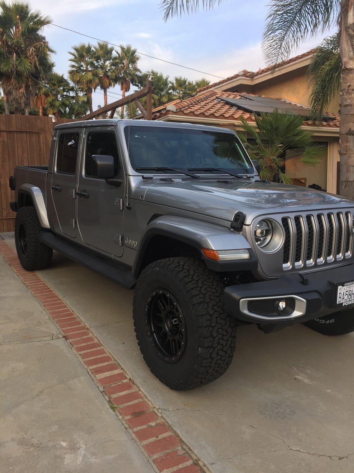

Here’s my Overland. 17” rims, 35” tires. 2” Mopar lift. Just an idea of how it may look on yours. I’m not concerned with filling in the space in the wheel wells, more concerned with the available wheel travel. I don’t wheel like I did back in the day, but, I don’t want my tires tearing my truck up when I do.
Jeep Gladiator Overland without Max Tow Package - Lift? Spacers? EE165226-B658-49D6-A02E-08084AFAE063

Consider 285/75/18s if you want to keep your stock wheels slightly taller than most 35” tires but only 11” wide.

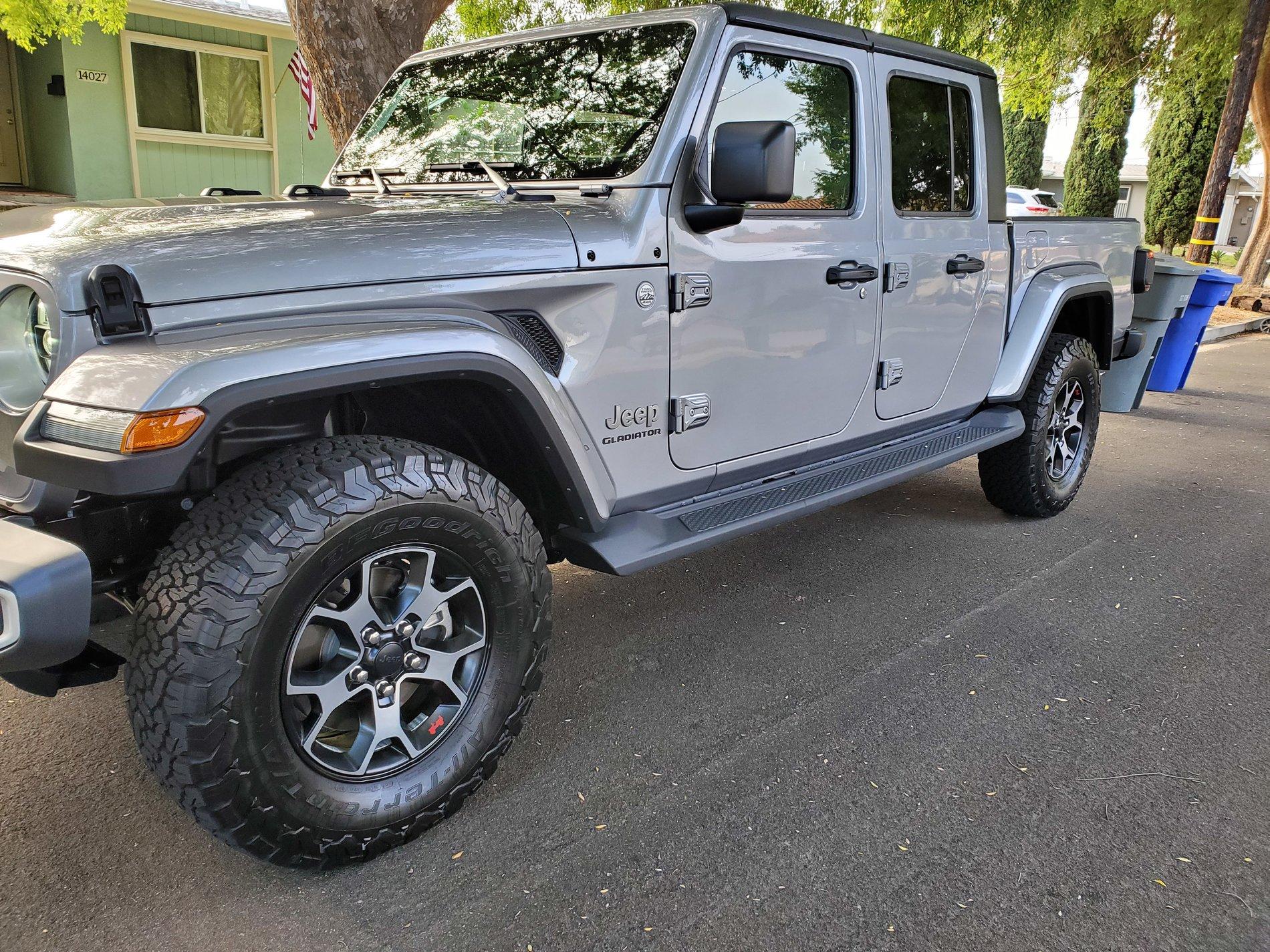

Pescado
Aug 22, 2020
163
256
San Diego
Gladiator Overland
I had the lift and tires put on at the same time and never took any measurements before hand so its hard to say. I can measure it somewhere if you want

Really like that subtle tough look. And like the outline letters on the hood. NICE. Would look good on my blue. Your pic makes me dream of what I could do with mine and not spend another 50 grand getting there. I like the front bumper and winch setup, too - low profile, I like it.
I've always liked the look of the Overland WHEELS, it's just the stock and only tire option on the Overland is, well, not my first choice even for a daily driver that I don't climb cliffs with.

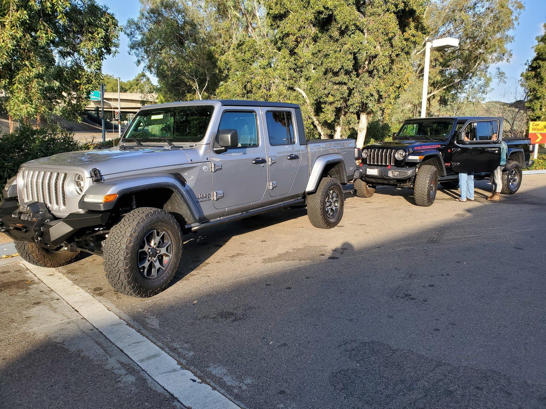

Max I would go without a lift on the Overland is 33's. You can put 35's if you are NOT planning any offroad activity otherwise you will rub on the fenders.
1st: 33's without a lift!
2nd: 33's with 2.5"Mopar lift
3rd: 35's with 2.5" Mopar lift
NOTE: The 35's are rally pushing the capability of the 3.73 Overland gearing....

What is on yours in the pics there?
1st PIC: 33's without a lift!
2nd PIC: 33's with 2.5"Mopar lift
3rd PIC: 35's with 2.5" Mopar lift
