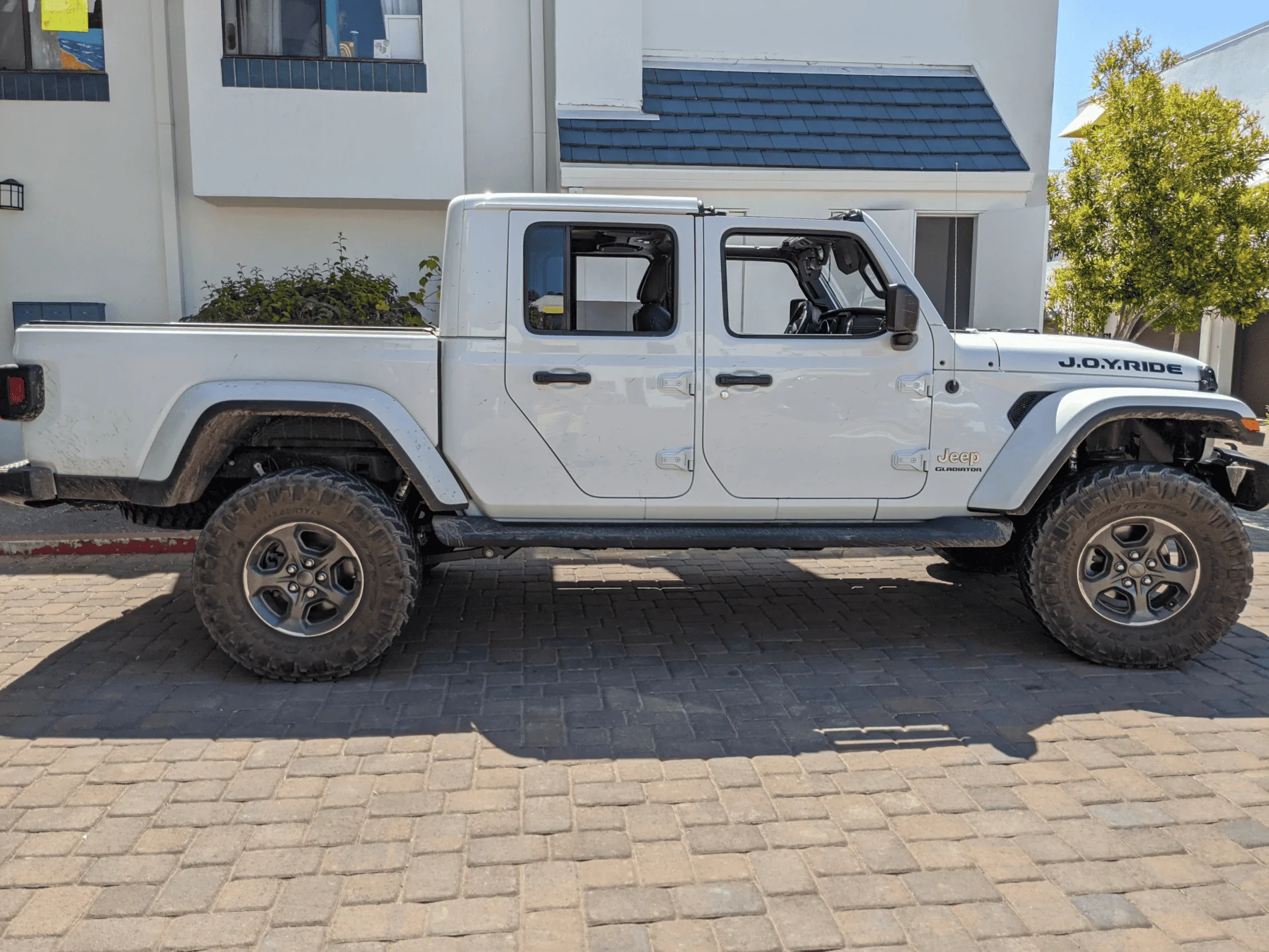

37s you need to do a lot more work. gears. probably axle shafts. ball joints. big lift. maybe fenders.
If you're gonna open those axles you should consider at least 1 locker if you're gonna wheel it.
My Overland, 17" Rubicon take offs, 2.5" Clayton lift (gave me more like 3.5-4"). 35x12.5x17 Nitto Trail Grapplers.
I may get to 37s one day but it'll be after all the other work

So if i go with the mopar 2" lift, 17" wheels and 35's for tires, do you think i need to regear?
Depends where you drive. Flats and in town you won't have any issues. Hills esp on the highway are gonna be brutal.
