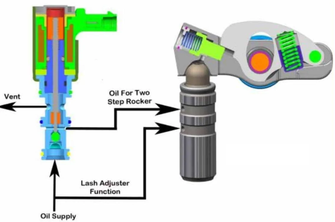

Lifters or lash adjusters?
Or rockers/followers?
Asking as the lash adjusters, which some call lifters, don't actually move in the bores, the only wear might be the tips where the follower/rocker runs on it.
There's a TSB for tick caused by lash adjusters...........
I guess the lash adjusters. Whatever engages the cam lobes on high lift. I get them mixed up.
