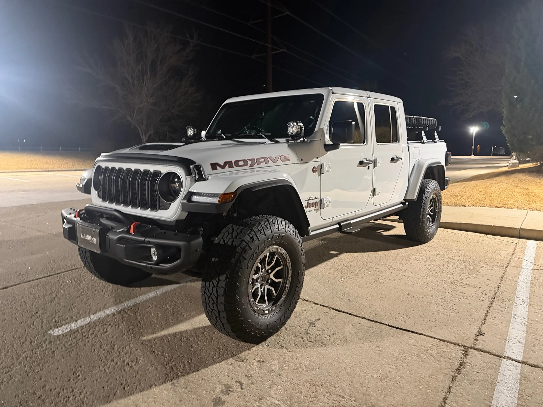

Thanks for all the reply’s this helps a bunch. I like that rockjock kit. The guys at teraflex put together a similar kit for me that landed about the same cost. I put 35s on yesterday and it looks great. I don’t plan on 37s but a little more lift would be ideal as long as it doesn’t look goofy. Went with Baja Boss AT tires. Planning to add a bumper and winch next and we’ll see it that makes the rake worse
