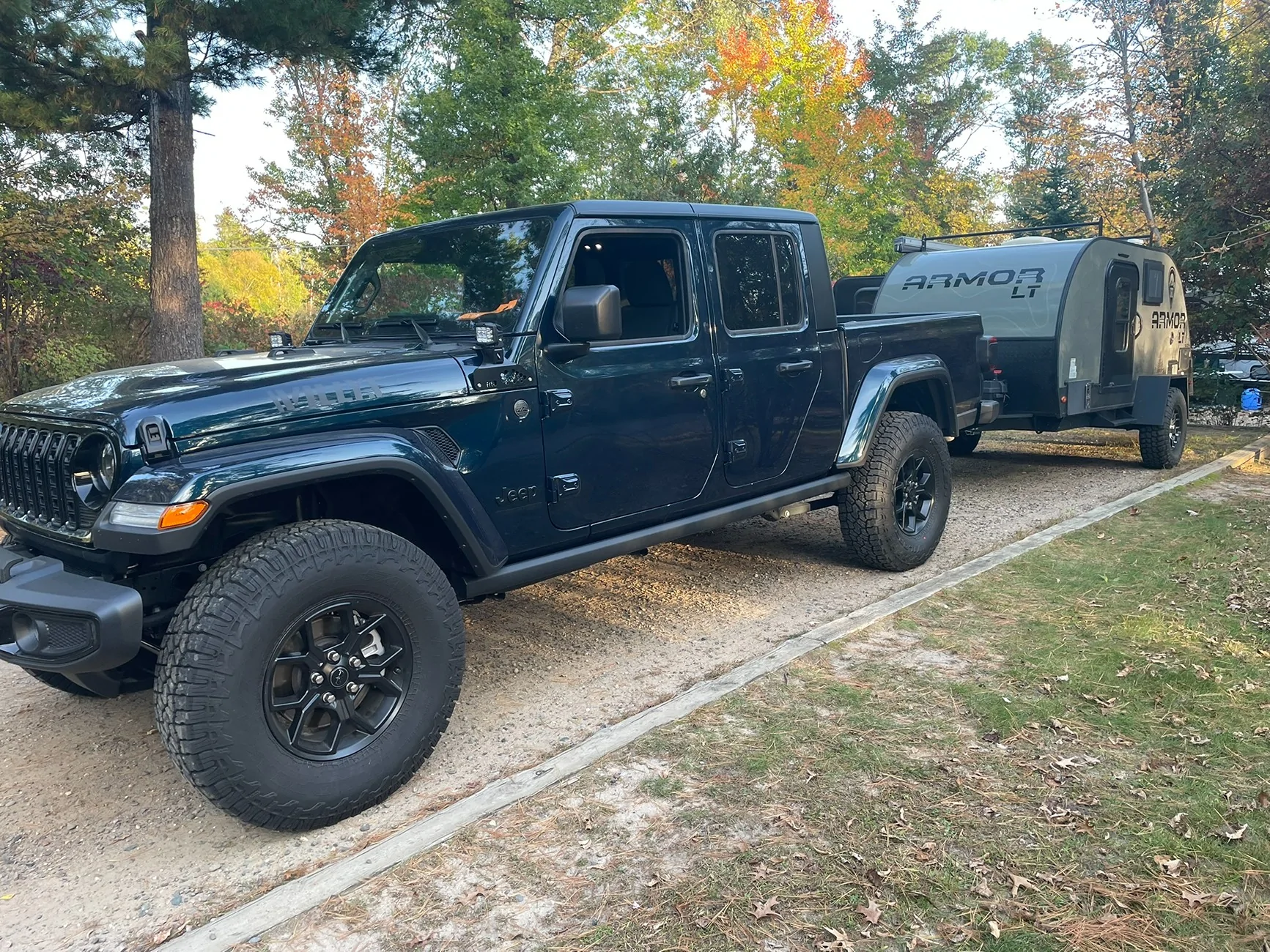

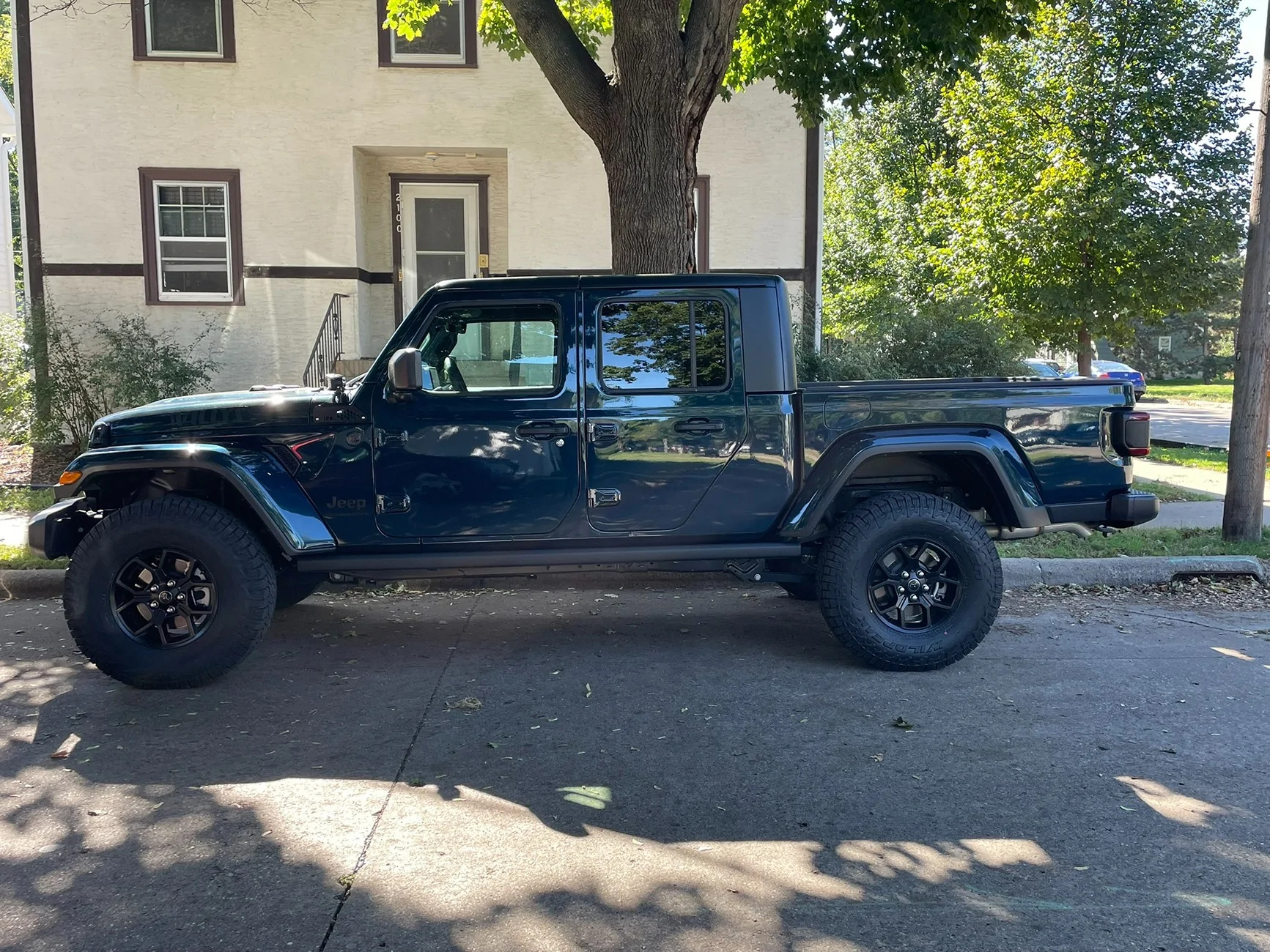

2025 Willys Fathom Blue, 2" AEV Lift, Falken Wildpeak 4 35x11.50x17, 4:88 Revolution Gears, Diamondback cover, Bilstein steering stabilizer and most recently Billie Bars. Retirement can wait!
I love the stance and no wheel poke (my preference). I am using the shock extenders but will be doing Bilsteins all-around this summer.

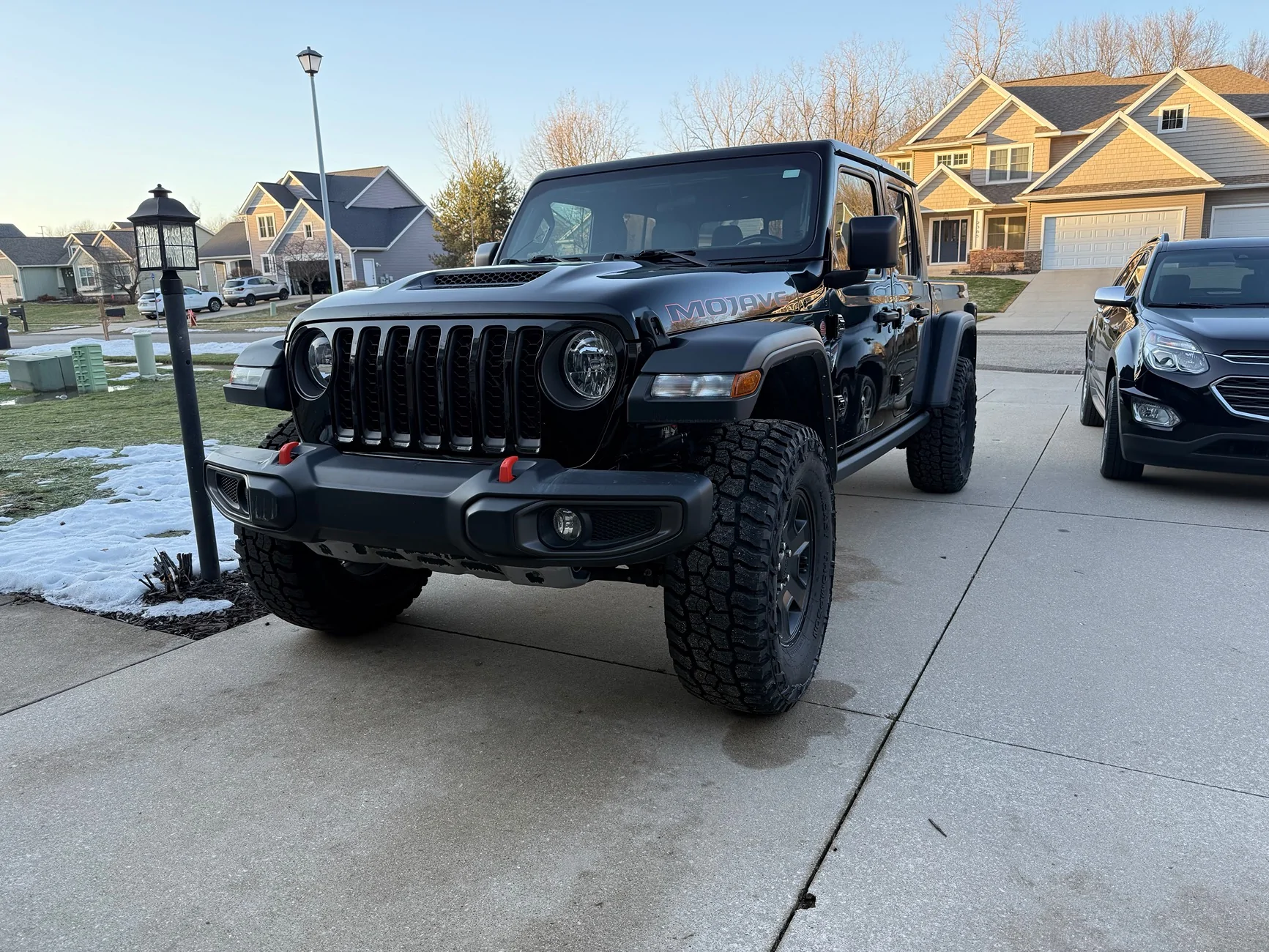

Thanks for all the reply’s this helps a bunch. I like that rockjock kit. The guys at teraflex put together a similar kit for me that landed about the same cost. I put 35s on yesterday and it looks great. I don’t plan on 37s but a little more lift would be ideal as long as it doesn’t look goofy. Went with Baja Boss AT tires. Planning to add a bumper and winch next and we’ll see it that makes the rake worse
Great looking Gladiator. Murdered out is my fave

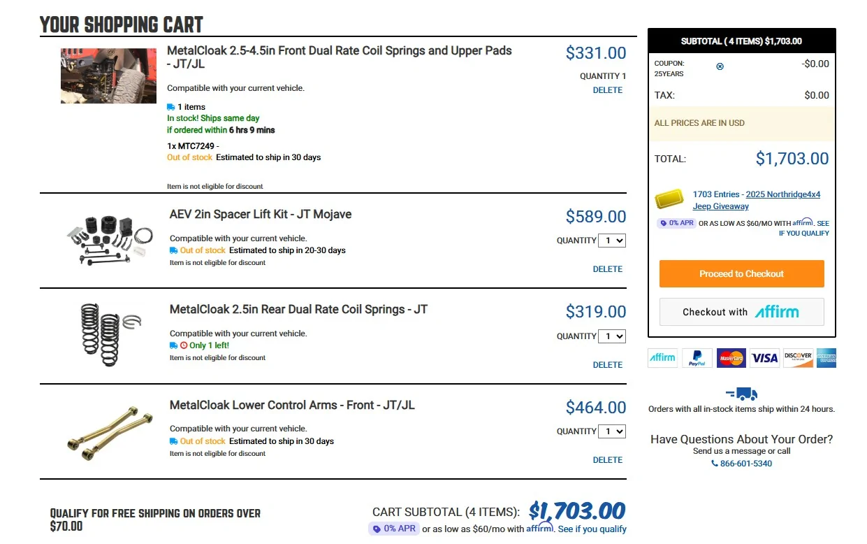

I put together this package. Is this a hot mess? If I go with the upgraded springs do I still need the AEV Spacer? If I go with the extended lower control arms, do I need the Geometry Correction brackets?
Jeep Gladiator Mojave Lift AEV or something else Screenshot 2026-04-21 090026
GuzziMoto
Jan 28, 2026
104
104
Skinny part of MD
2023 Jeep Gladiator EcoDiesel
If you go with the MetalCloak springs you do not need the AEV Spacer lift, and probably don't want it. However, there are other parts you would want, like a rear track bar bracket, maybe a rear track bar, front track bar, longer swaybar end links, and the lower front control arms you have in your cart.
Then there is the question of shocks and bumpstop extensions. You can just run shock spacers and matching bumpstop extensions. Or you can upgrade to longer shocks and matching bumpstop extensions. Your shocks / shock extensions and bumpstop extensions need to match up.
I would call the guy at MetalCloak and have him piece together a kit for you. It would probably be around what you have in your cart, but add in the parts you don't have.
