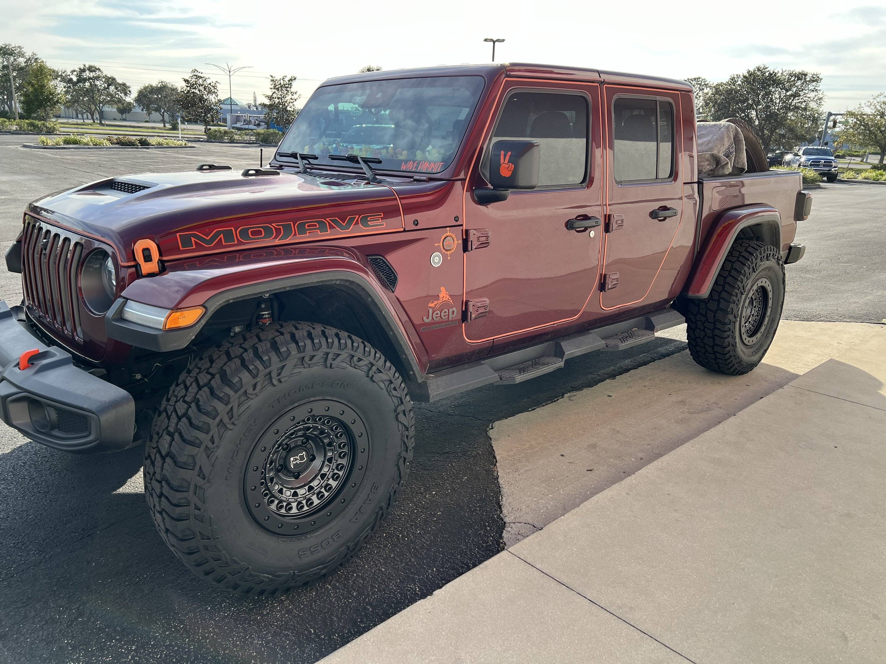

Mine got the 2" AEV kit and 37s by the time it had 1100 miles on it. Drives great on the freeway, no issues with rubbing, suspension still works in the desert at freeway speeds. Very happy with it and the stock shocks. They are by far the best factory shocks on any jeep I've ever owned (15ish between the wife and I) and the only ones worth running extensions in order to retain.

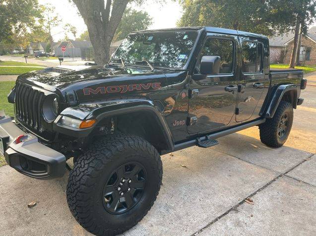

Mine with 2" AEV, GEO brackets and 35s. I think it rides better than stock.

That's what I've heard, and why I'm doing the same thing, except I got 37s.

I'll likely add the drop brackets up front and the rock krawler triangulated 4 link rear eventually but it's working well as is.
