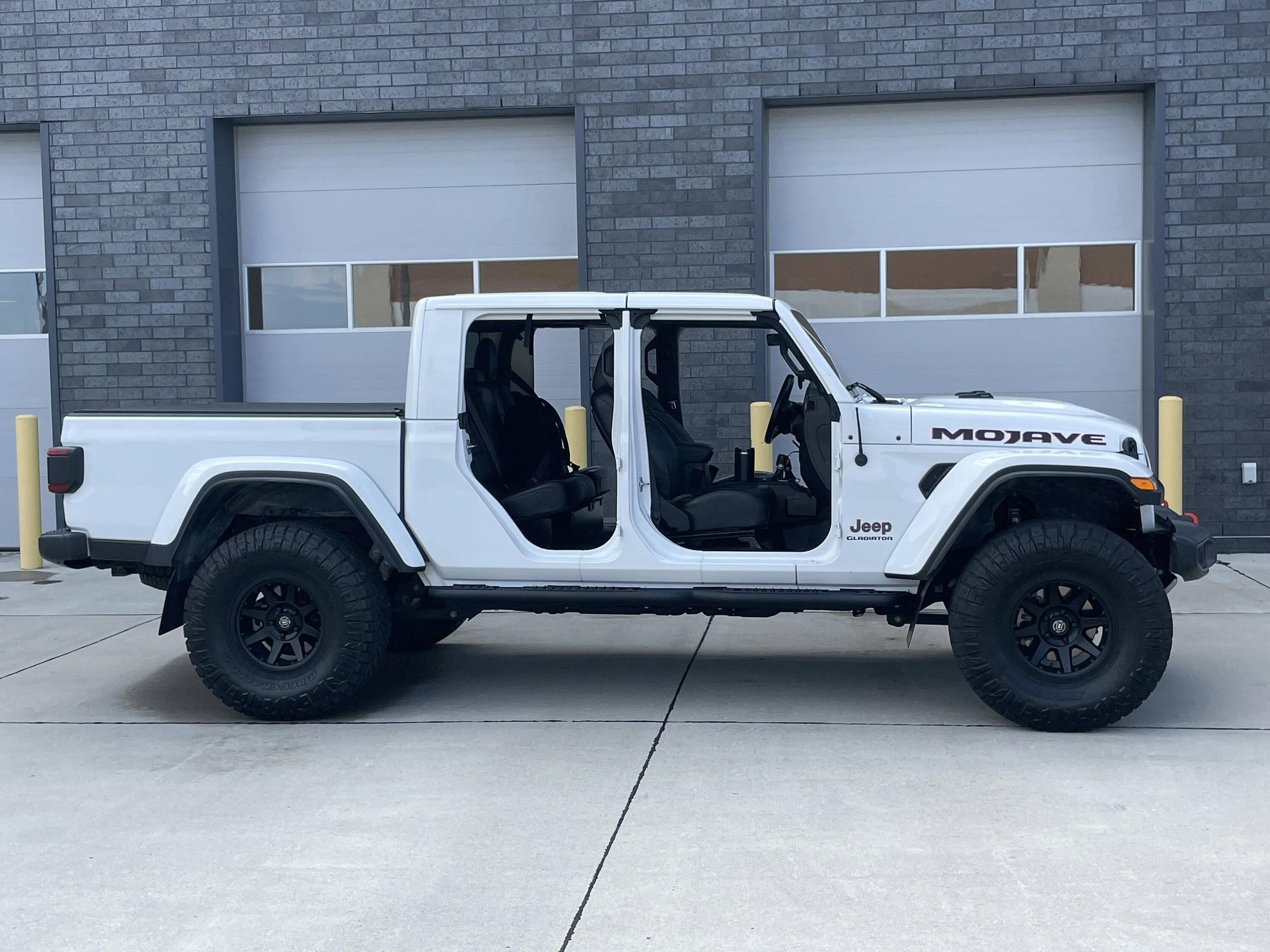

I’m currently running the AEV Mojave lift, AEV geometry correction brackets, MC steering brace, MC adjustable track bars, and 37’s for the past 8k miles. I love the ride, super comfortable, and I can literally drive it with two fingers. When the factory shocks are toast, I’ll likely jump over to a full MC setup. AEV is a great setup for the money. I get zero rub daily driving and will report back after I get back from the Black Hill Jeep Jamboree. I will be installing Apex Autolynx before that trip.
Nice, thanks for the reply and feedback. Based on that stance, with AAL fender chop lights, 38's would have plenty of clearance. The mojave I am looking at already has that done. I am running 39" KM3 on my JTR frankenlift. Springs are 2" mopar with TF 1.5 spacer in the front, synergy front end and control arms.
Thinking along same lines as you tho, most economical way to run 37s/38's and retain stock shocks for now.
