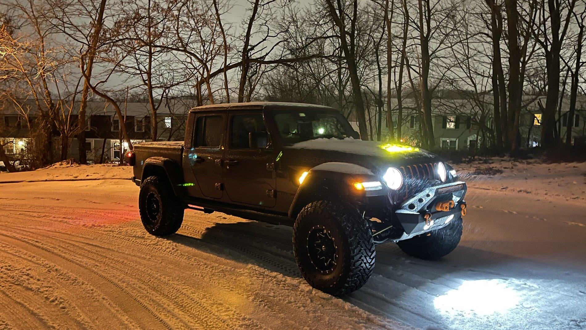

i had no issues when others were getting stuck. In MD we get an odd mix of snow and ice and that is hard to drive in, the JTM was the most stable and sure footed vehicle I have ever driven in snow.
More pics of the lights in the hood scoop?
