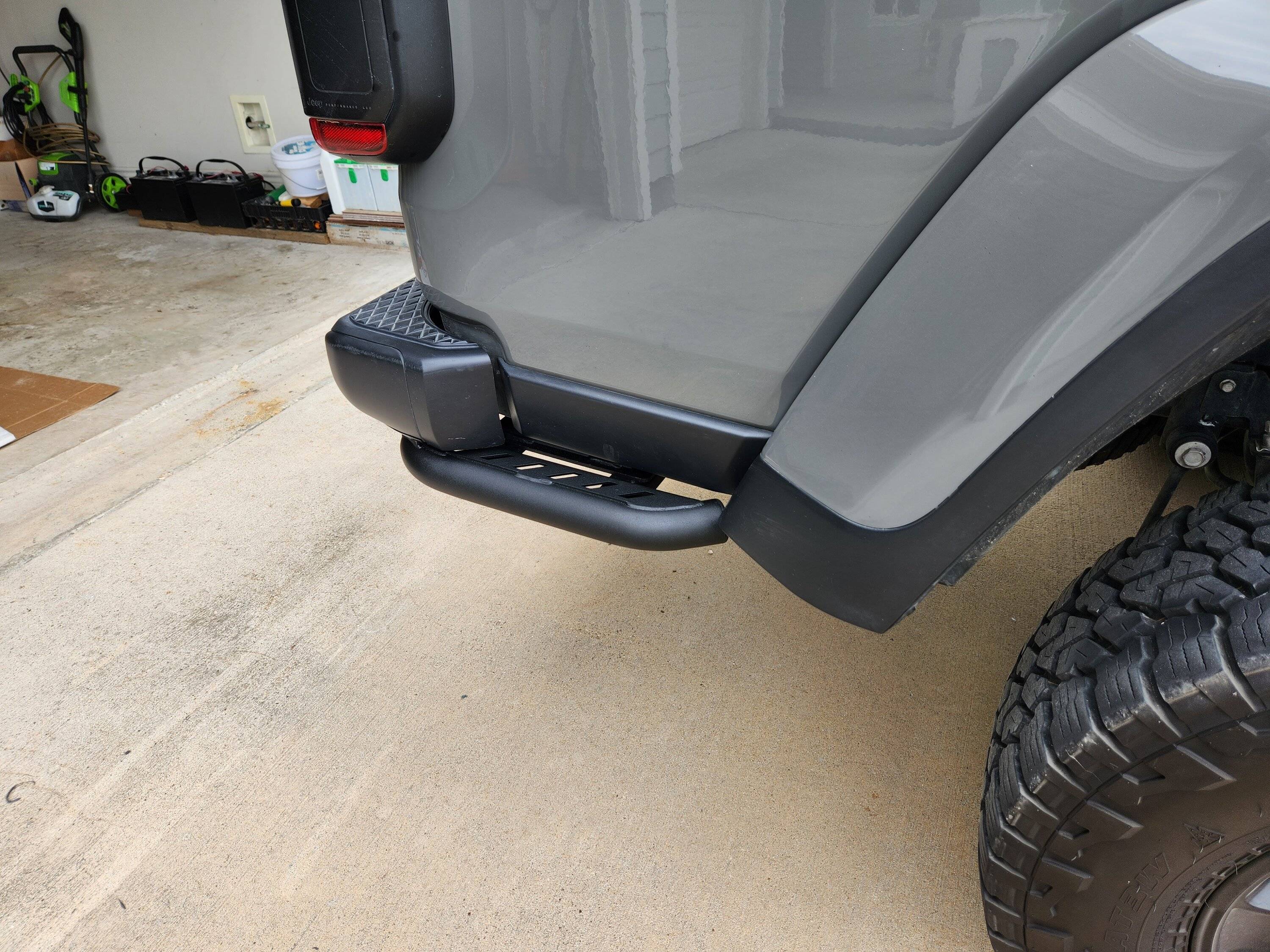

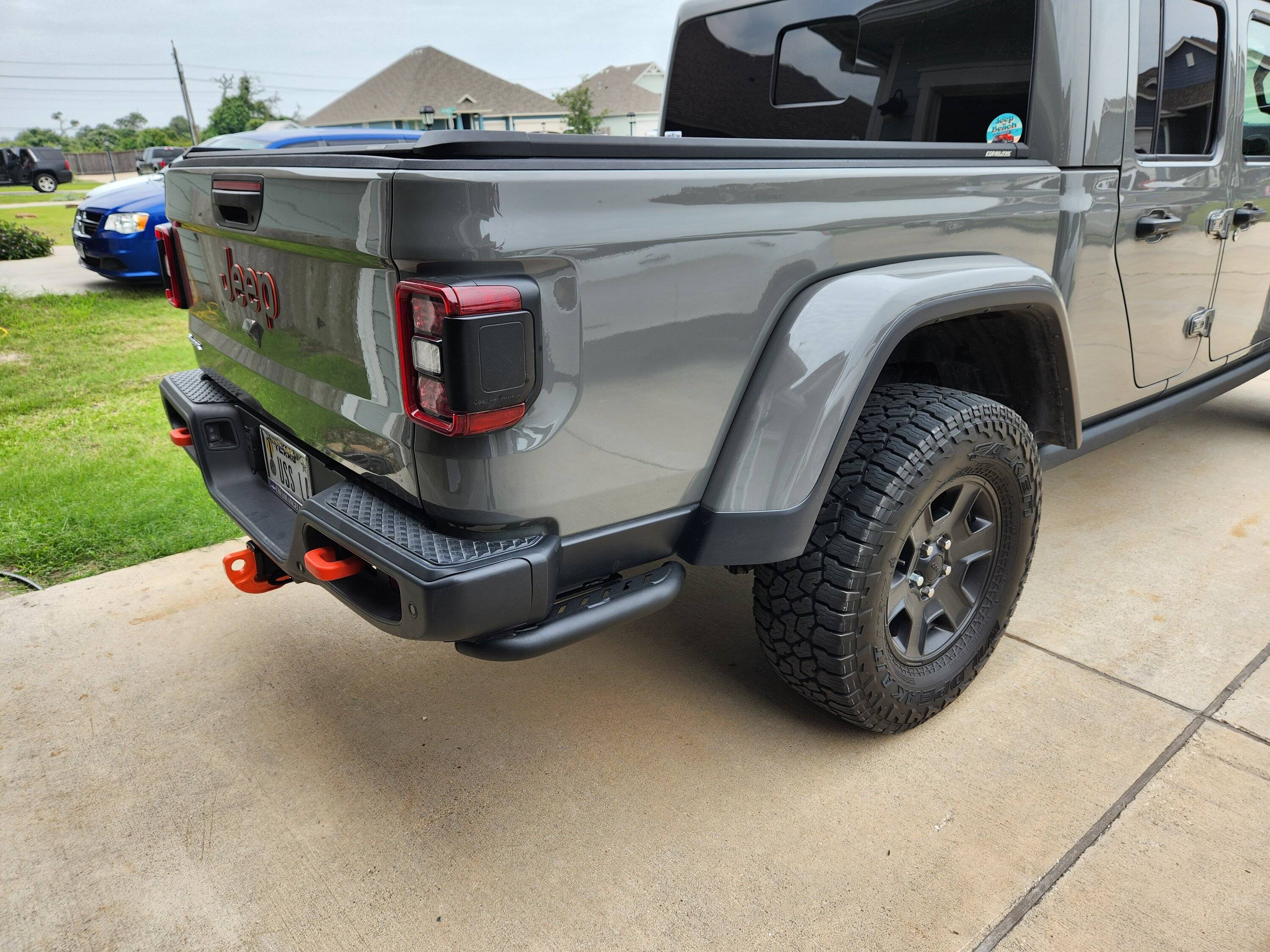

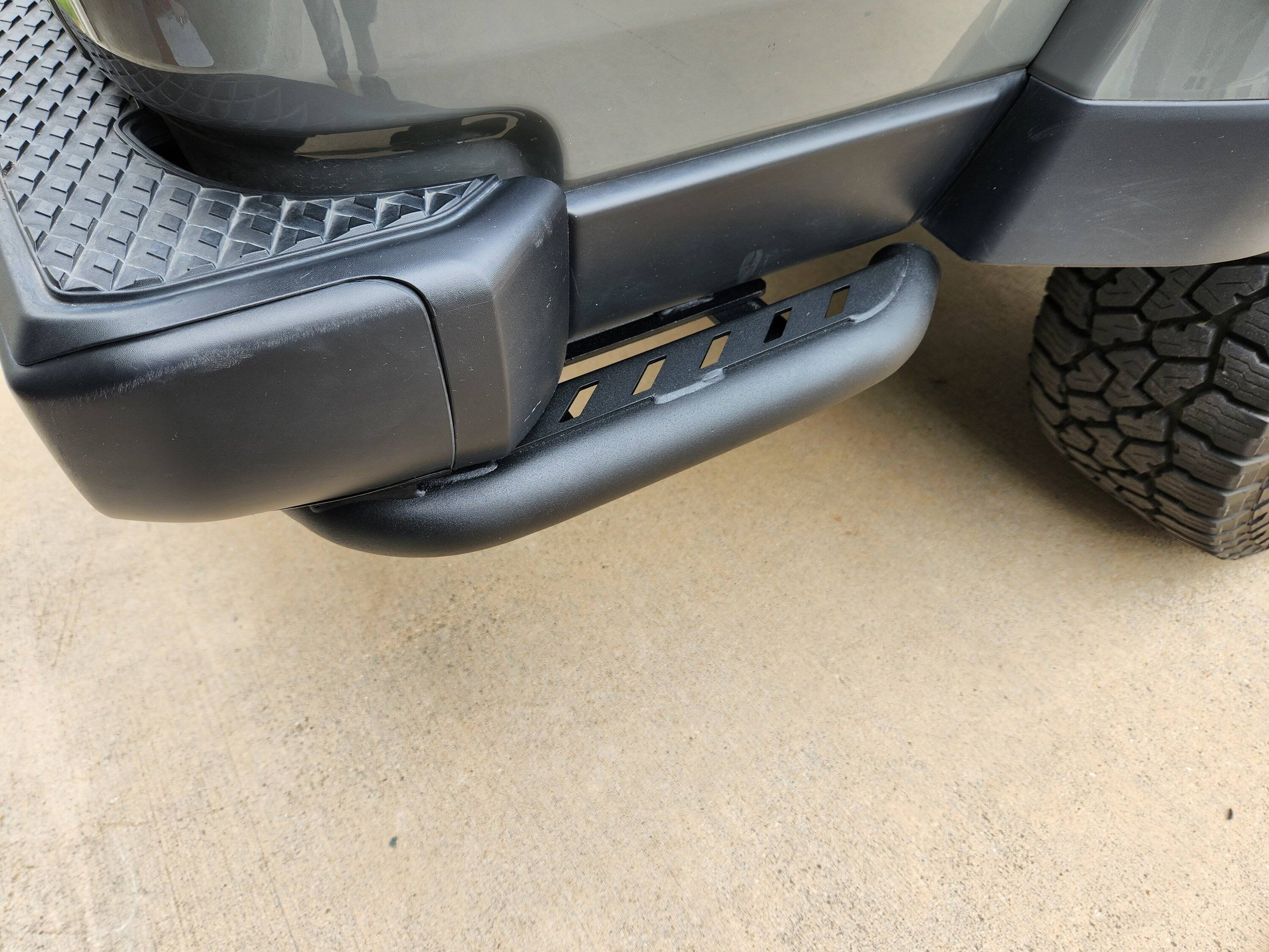

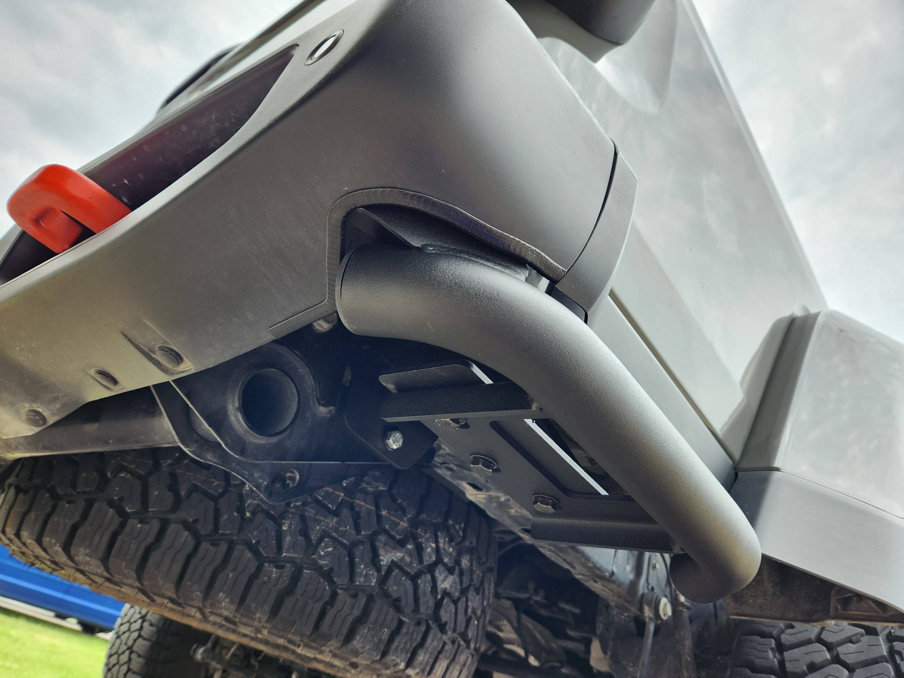

Late to this thread... but in case you haven't found an answer... I got the Red Rock bed sliders from Extreme Terrain.... https://www.extremeterrain.com/redrock-4x4-jeep-gladiator-bed-side-rock-rails-jg2317.html

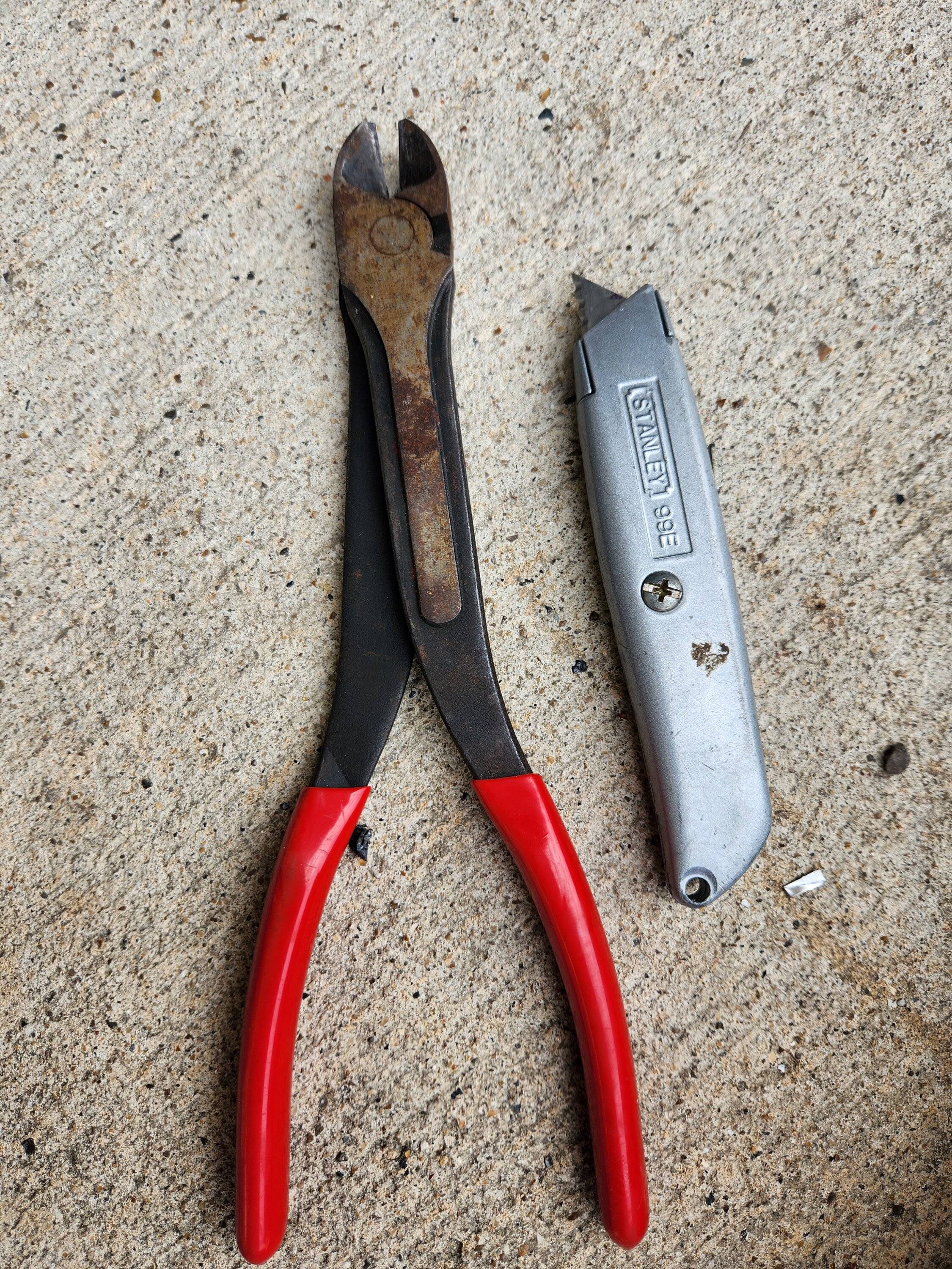

You do have to trim the plastic bumper a little bit, which I found quite easy "nibbling" with side cutters, rather than the dangerous box knife approach. The provided trim made it look like it belonged from the get-go... but unless someone's laying underneath, they'll never see it. They turned out great and look like they should have been there all along and they also provide a small step for those times you need to reach over and get something out of the bed or what-not.
