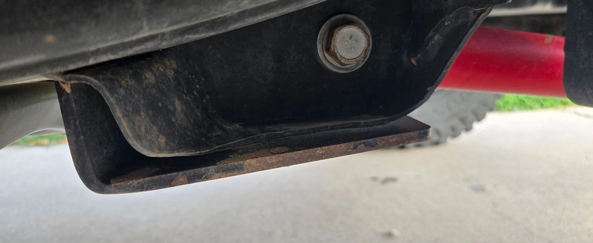

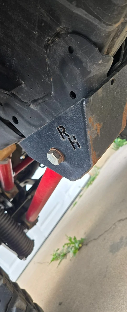

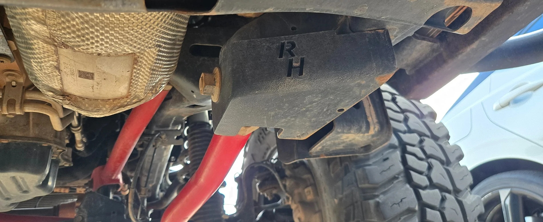

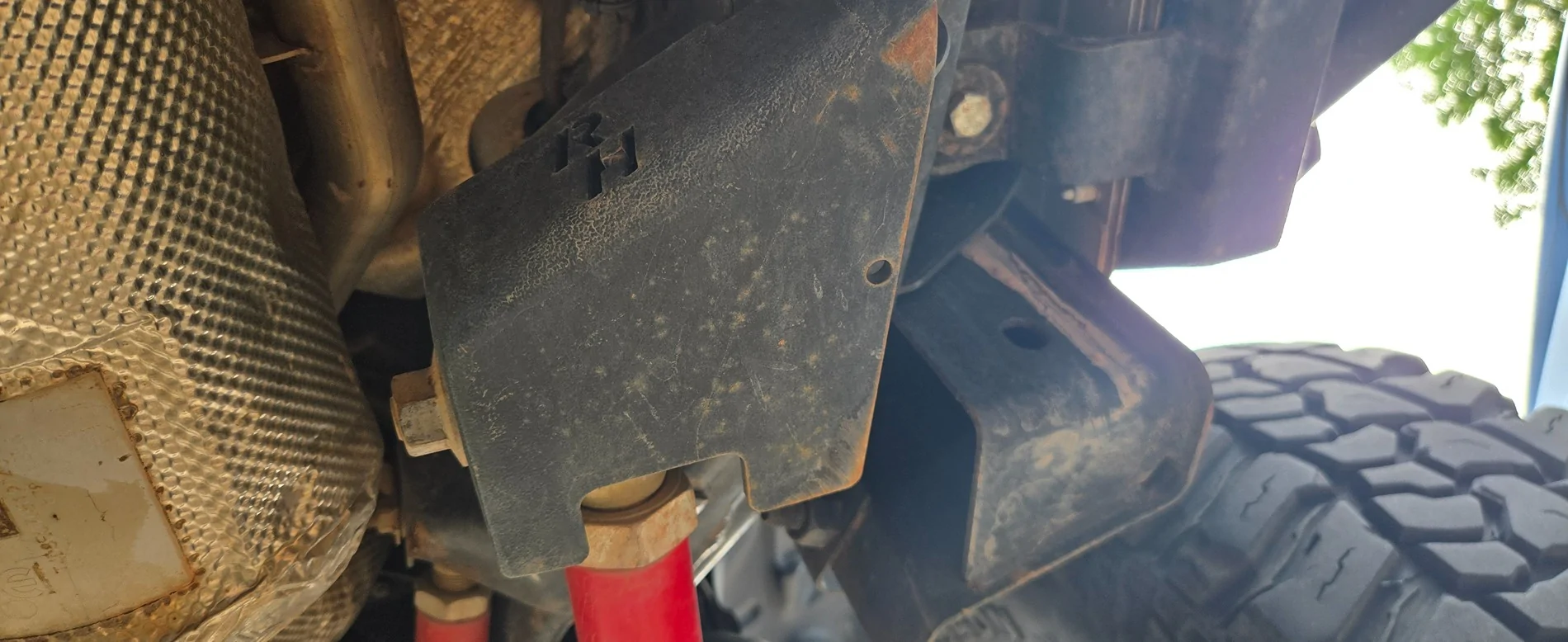

Thanks, that's the example I was looking for. You lifted and that's still the area you bash up, so priority hasn't changed.
Do you hit the the axle side lca and shock mounts too? If so, it could also indicate your wheeling environment is different than mine. Likely is, as most of mine is tame, but I do have more out-west trips coming up.
The RH4X4 frame side skids are $320 now. Can you tell me if the bolts/nuts they supplied you are rusting, as reported elsewhere?
I can see how it would bend, it looks like it's only held on one side. At least for the fronts, looks like the rear bolts to both sides.
While there are plenty of options for the rear, the only other company I can find with frame side fronts is Barnes 4wd. They've wrapped it, including more bolts so it doesn't act like a cantilever. Only $60, requires some drilling.

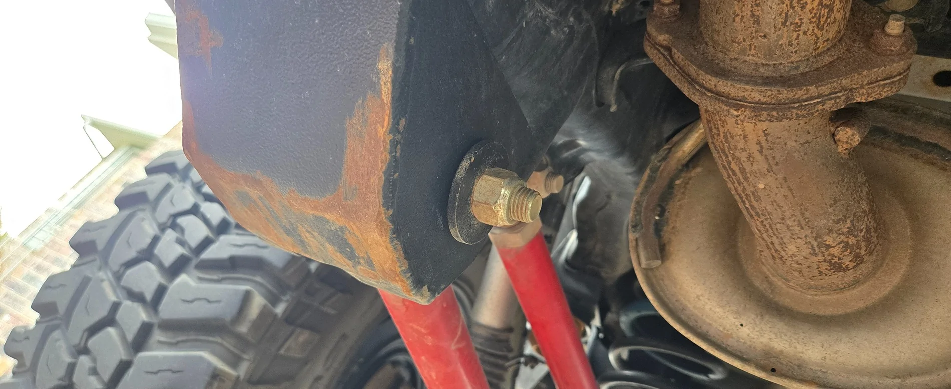

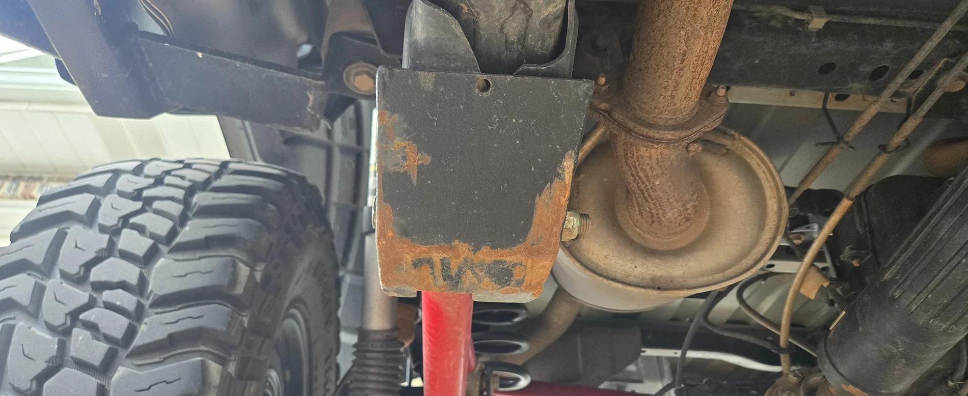

No rust on the bolts, just mud in these pics, but the skids are rusting from the beatings. I hit the rear much more than the fronts so if you were looking to split up the buy, I would get the rears first. The rock hard fronts are extremely stable even though it bolts through on side due the the flat surface on the other side.
I dont run any skids or armor on my axle side so I dont lose clearance and I have never hit those. My tire normally clears all that.
Wow, you went above and beyond, I appreciate that! Thanks for the pictures as it shows them better than on their site. Those rears certainly are rock magnets with the long wheelbase.
Maybe it's just the angle of the pics, but do the rears create a bit of a water bucket? A drain hole might be nice.

No problem. The rears are flat on the bottom with no lip and there is a notch cut put the back to allow for more control arm articulation so no water pools inside. I would say the only downside to these is the 190ftlb torque spec and the need to re-torque after every trip. 190 is a pita on the gound.
