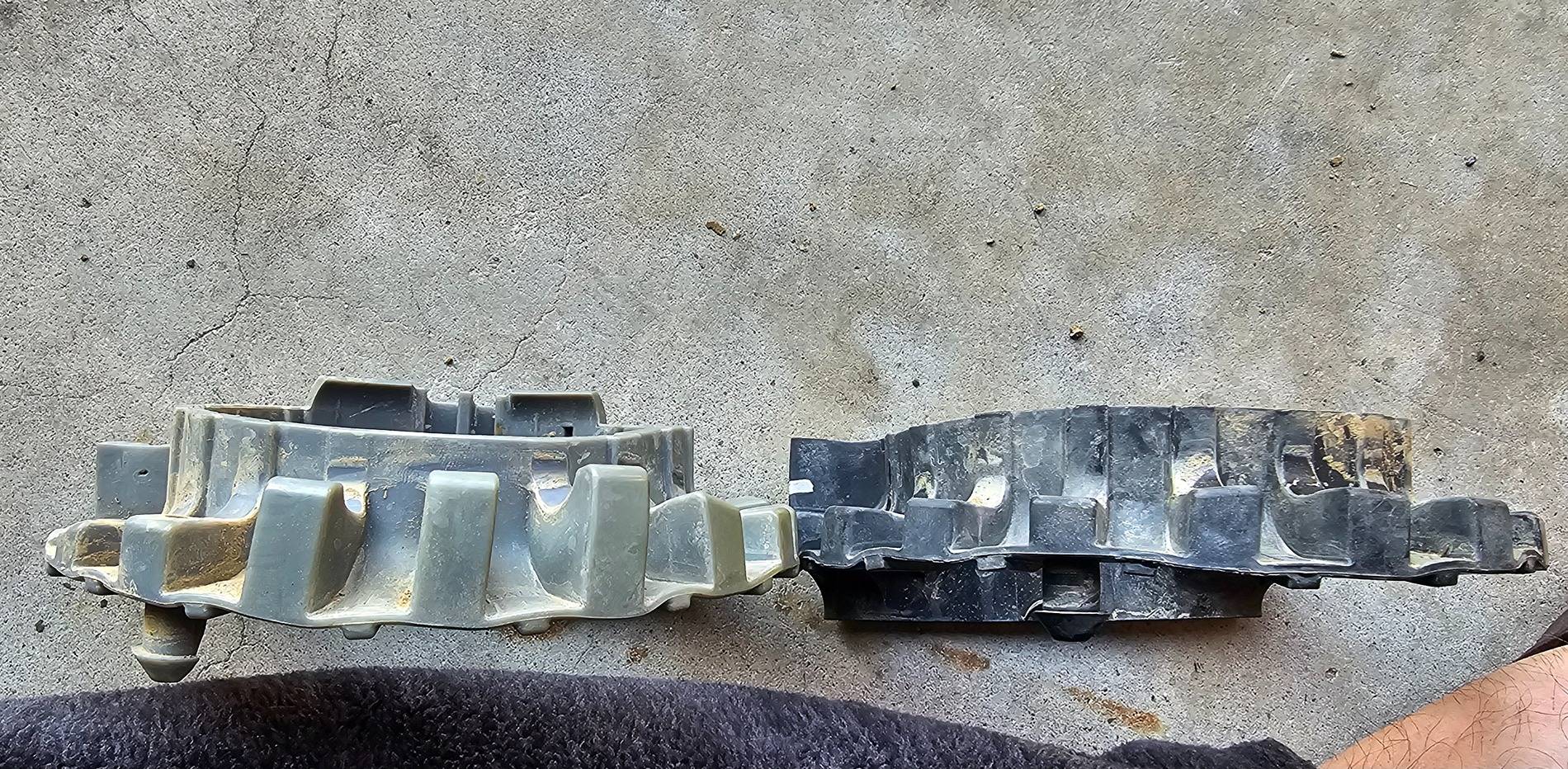

This was interesting. Metalcloak isolators are identical...doesn't matter which side they are on. Factory are left/right, with the gray one having a much higher 'ramp' on it. 2021 Mojave springs are different left/right as well, while 2024 X springs are the same left/right.
