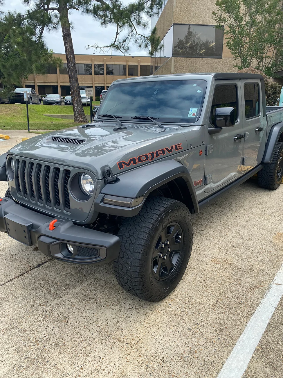

just bought it last night. was thinking of a few things id like to change.
#1. headlight mod. is there a cheap mod? I think my buddy has different headlights on his 22 Wrangler. mine look like simple round light. his had multiple lights within (I think)
