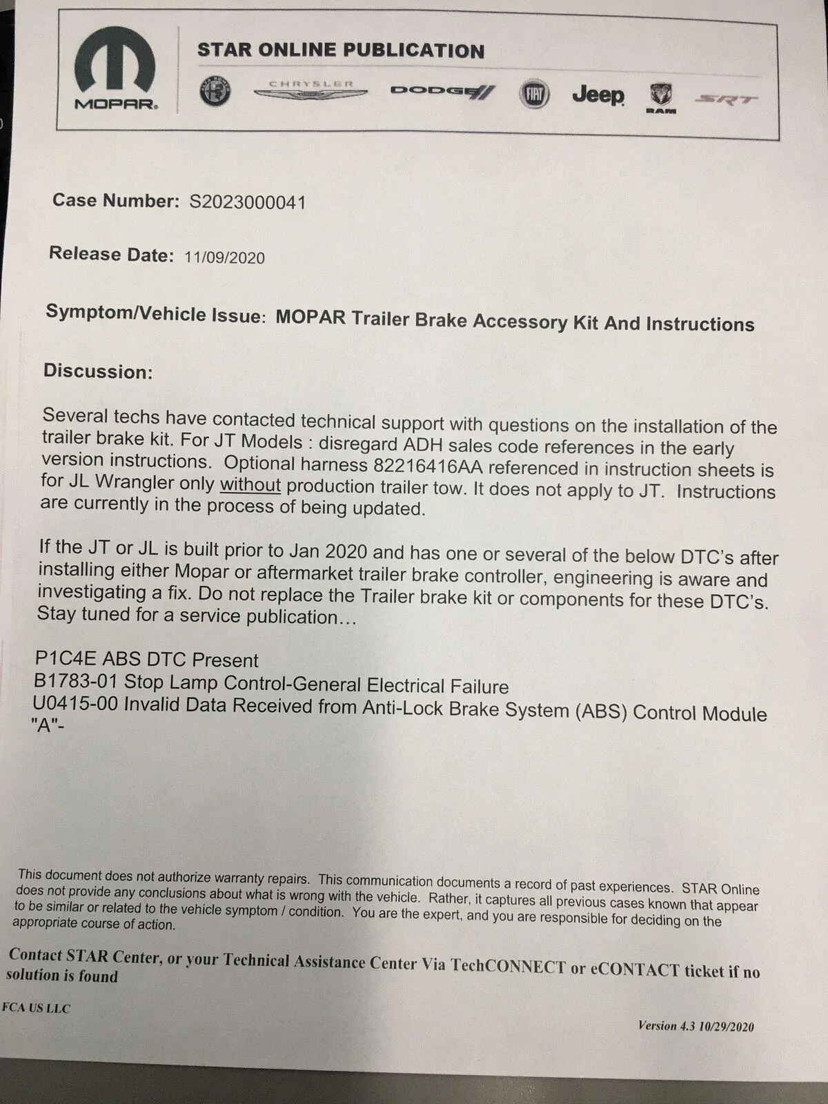

It seems, from following this conversation, that this controller works fine on newer trucks. I have a over-featured 2021 ecodiesel that should be delivered any day now that I'd like to put a controller on. Is there reason to think the mopar controller will do crazy stuff on a 2021?
Have you read this? It's been posted several times.
(as have some of my spreadsheet showing a correlation between build dates and errors)
Trucks built January 2020 and later are fine.
It was unclear to me if that was just an admission of guilt on the older vehicles and the newer ones were still TBD. Thanks for the clarification.

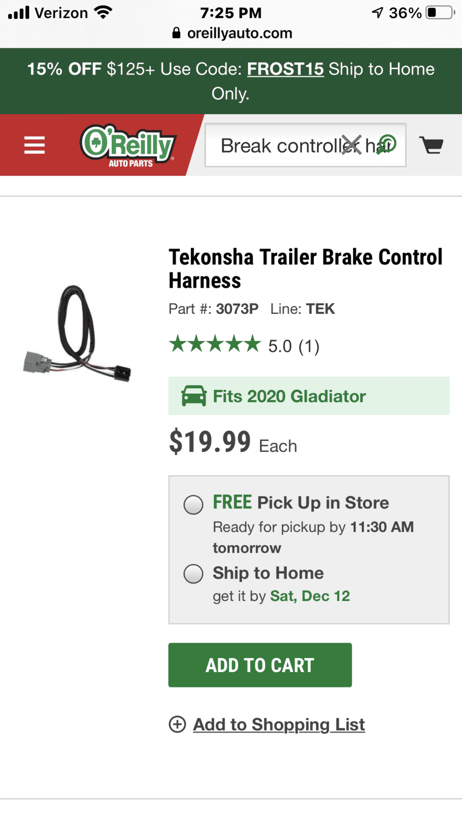

Today I replace the factory break controller harness with this one and it fixed to dash lighting up and disabling the traction control. Now when I push on the manual trailer break button it works perfectly.
Jeep Gladiator Mopar factory trailer brake controller - my impressions and review 59728DE3-97D3-4738-9AC3-9075E2F0CEAA
40,514
54,050
Yes because of the diode. We knew the harness with the diode prevented the issue because it resolved it when we used the Ram harness with diode with the Redarc controller.
However, we have yet to see what the real fix is or will be from Mopar in the end because these trucks built in the CALENDAR year 2020 don't have the issue, so something about the truck changed.
Anyone wanting to band-aide the situation can either install a diode in the brake lamp line from the controller to the truck's harness or use the Tekonsha harness.
yeah I don’t like the band-aide but I have no choice until Mopar has a fix.
It amazes me that this works so easily and Mopar has nothing.
Something smells with this one.

The instructions are version 2 - printed in March.
The trucks that have no problem were made from January 2020 forward.
The controller wasn't released until this fall - 9 months after the truck was changed and 6 months after the faulty, incorrect directions.
All they have to do is go back to their change control docs, their versioning and see what changed with the BCM and ABS in the truck.
The timing of this is all totally crazy! Obviously no one TESTED This thing. I mean - instructions already at version 2 in March means they had something designed or at least on the drawing board months ago - and they can't see what changed in the JT in January?
