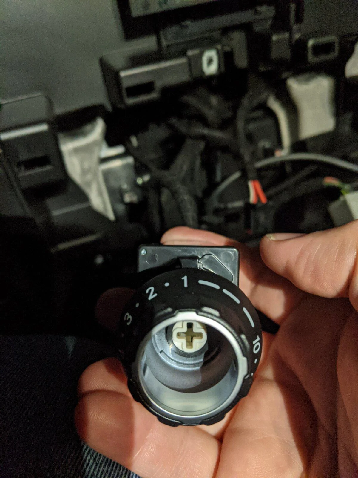

I need a sanity check. Bought mine the day it came out for my JT (2020 build date). No ACC, Max Tow Sport S. Install was smooth overall once I flipped the controller and realized the instructions were wrong. Pushing the button doesn't jack up my dash at all, my problem is with the dial....it only spins from 1 to 7. I was mad at myself for screwing that up and left it alone until tonight we're I pulled the dash again to double-check the install.
There is only one way to lay the knob on the dial, with little nibs to prevent incorrect placement. So WTF? Do your dials go from 1 to 10, or just 1 to 7 like mine?
Mine turns 1-10 just fine, but I did see someone who said there knob was assembled wrong in the package so they couldnā€™t select all the numbers. They had to take the knob apart and fix it. By chance does it go the other way past 1? If so Iā€™d say that might be the issue.
Full clockwise lock on the dial is 7 and counterclockwise is waay past one, like 10 or 9. With the knob slid into place the nubs on the knob prevent it from turning past 1. I have to inch the knob out a bit to turn it past 1 to get to full lock.
Thinking my knob is shit lol. I will add photos when I get home as the dash is still apart on my baby til I get this figured out
Also not really any noticible detents. Super faint.
Then you have one of those dials assembled incorrectly from the box - and like mine, mush for detent. It's just plain an extremey cheaply done dial assembly.
In the end I think I'm going to see if they'll replace my whole dial/knob assy under warranty. If it's supposed to have detents you can easily notice and that have some feel to them - mine is bad.

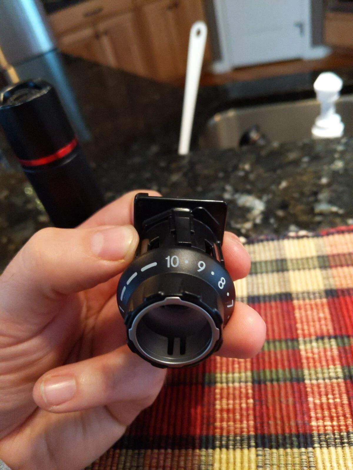

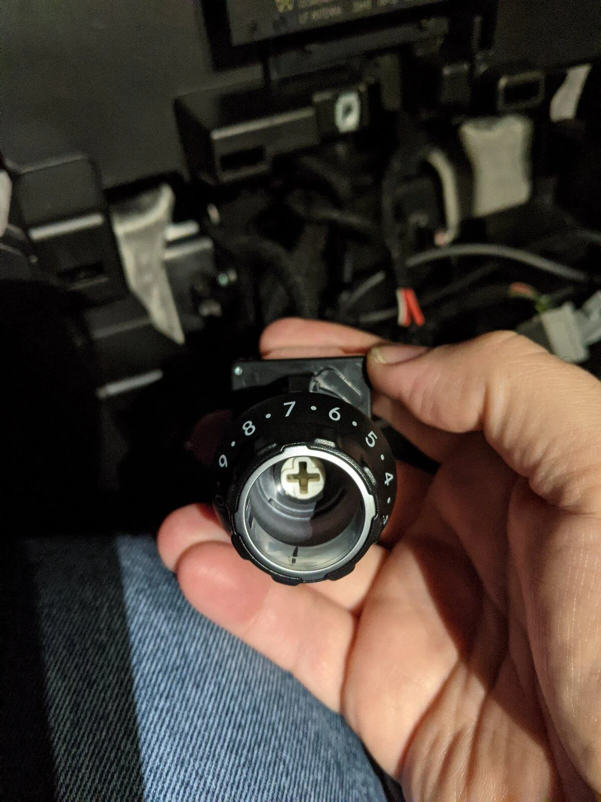

Okay, home, snapped pics. Dial full left goes to 7, full right goes to nearly 8 if I lift a little to get the nub out of the way. Nub is lines up around '2' which makes sense when you see the base of the dial where the stops are molded. 'skinny' slot on the knob is around 10, and the knob only goes on one way. So, either the knob was manufactured wrong, or the dual was pressed into place incorrectly.

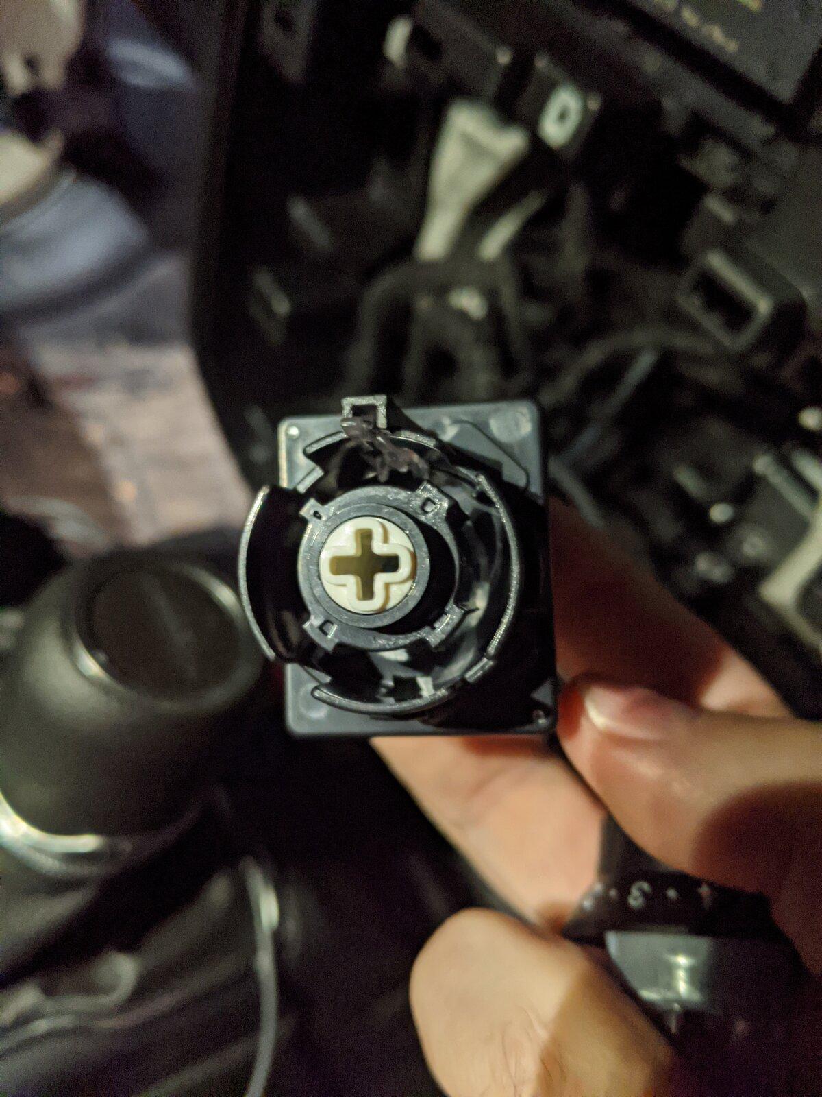

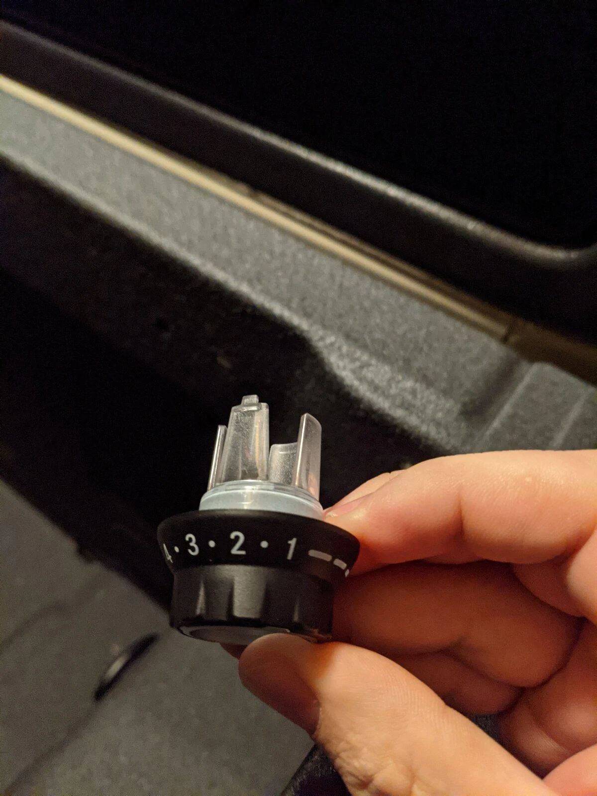

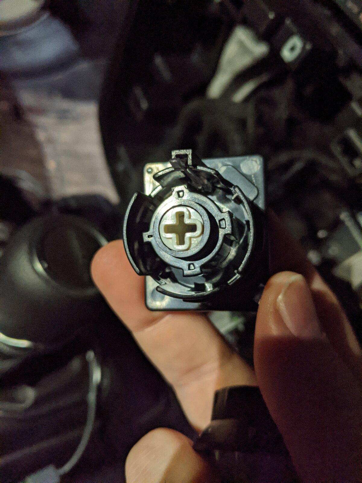

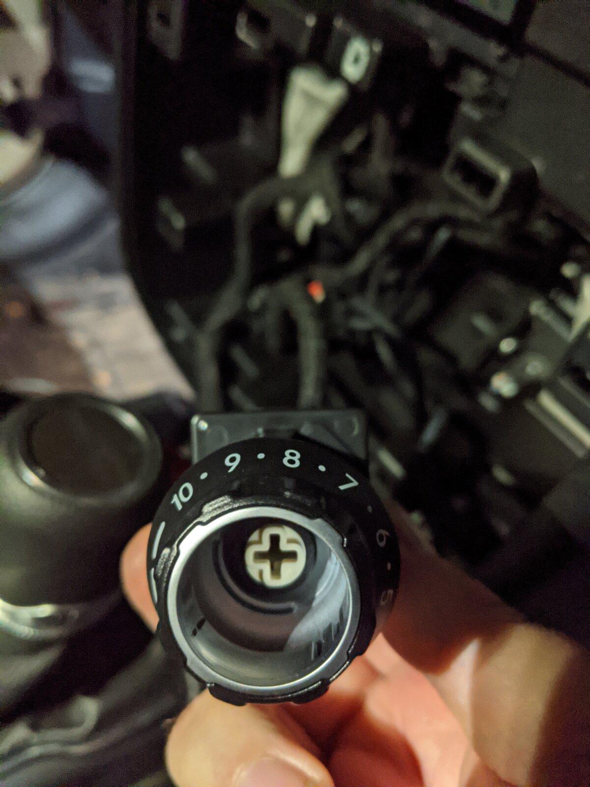

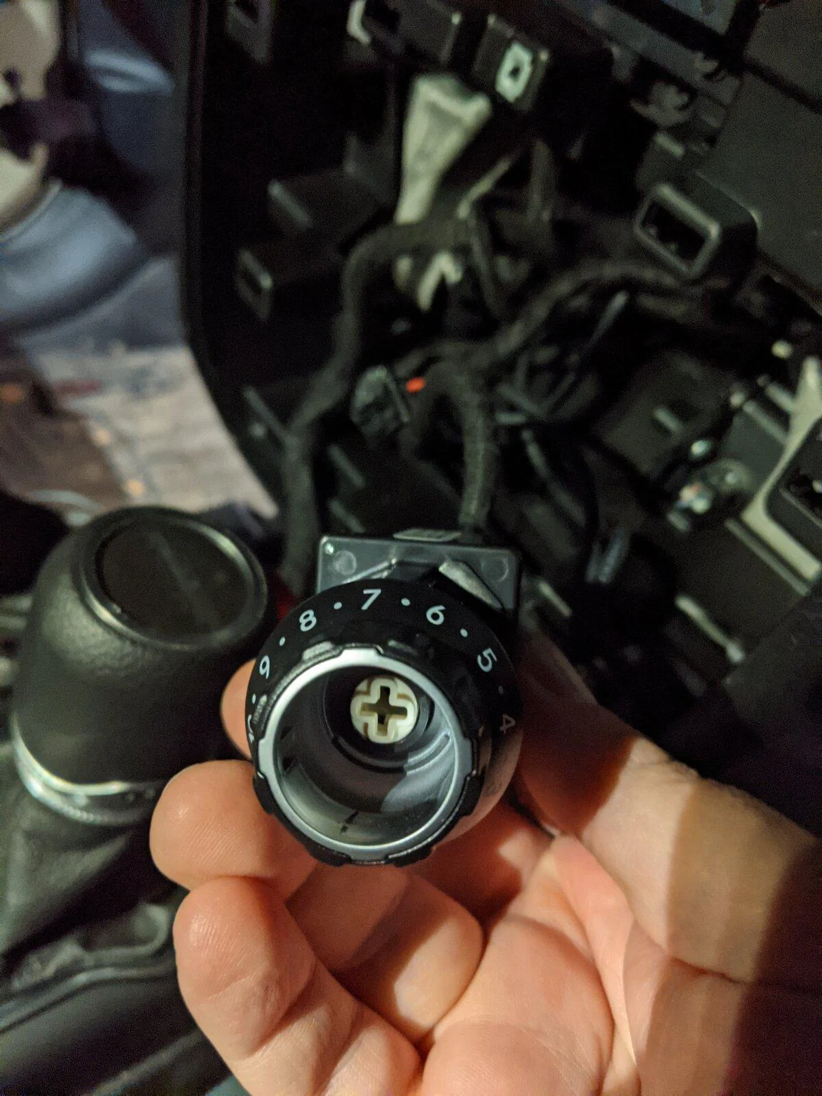

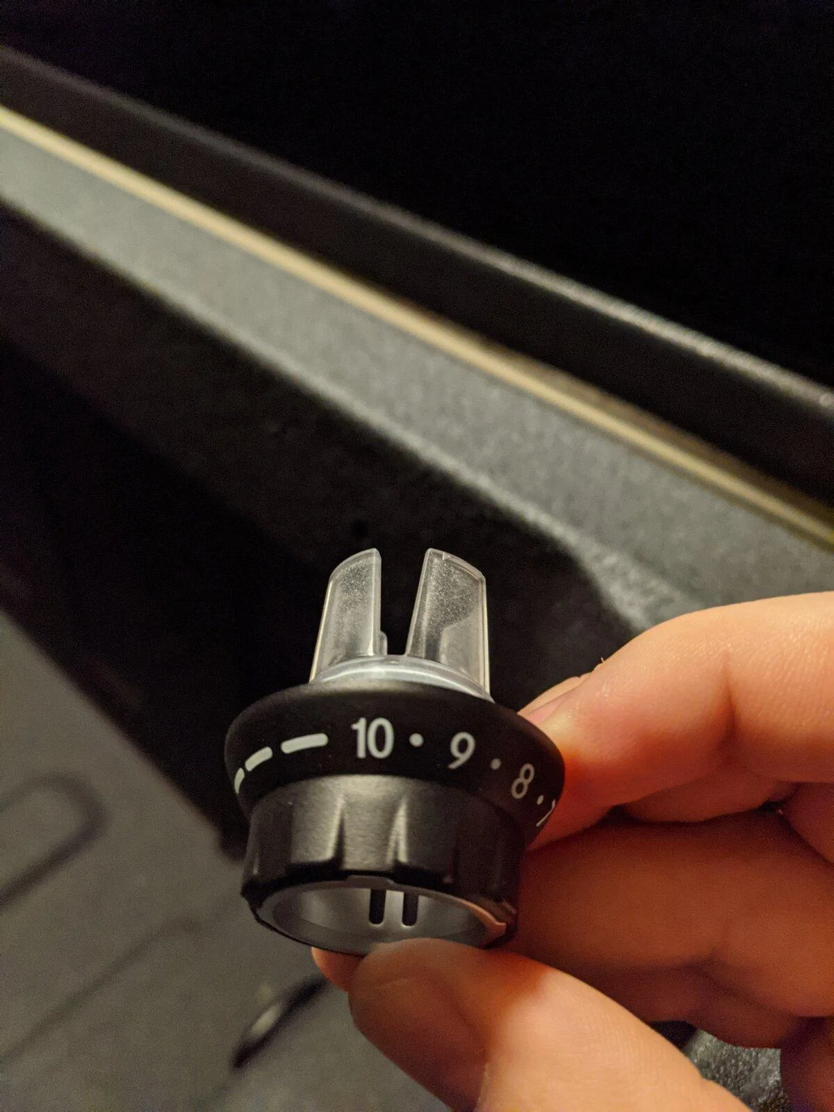

Sounds like you have an incorrectly assembled knob. @Markkabureck ran into that too, hereā€™s his thread on how he took the knob apart and fixed it:
https://www.jeepgladiatorforum.com/...d-the-oem-brake-controller.36503/#post-591939

Fixed it! The black dial attachment has three tabs to connect it to the main board. Mine was assembled wrong. Surprise! LoL. I disassembled it, made the adjustment, snapped it back together and all is well now. I get to put my baby back together and lesson learned....never buy Mopar parts the day they come out, give it time for the bugs to be worked out first
