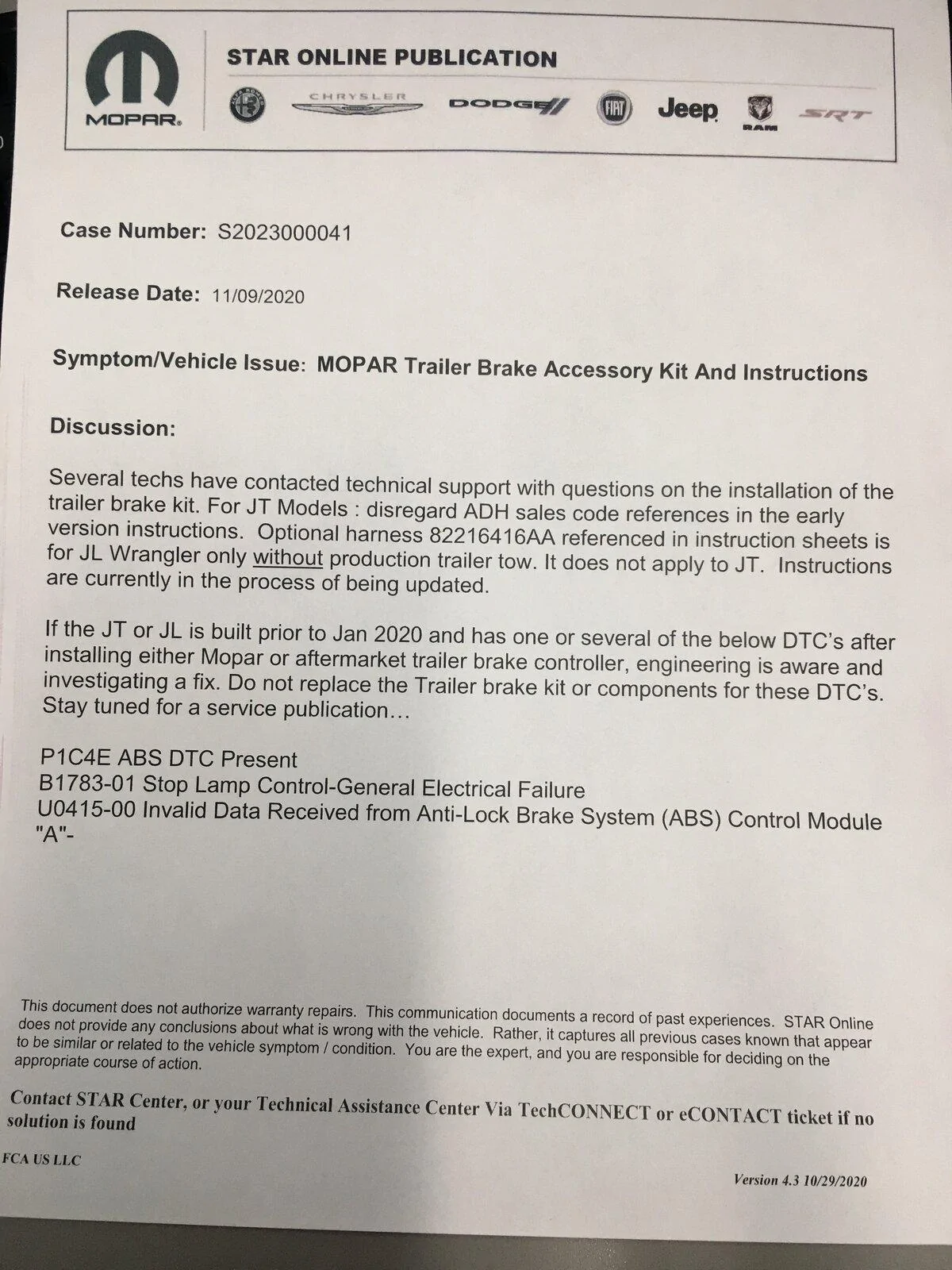

Another member was having issues as well and his dealer was trying to figure it out and ran across this -
This explains it. There IS a problem - LOL - with the TRUCK.
In fact, this publication indicates it's date-related AND covers Redarc controllers, too.
So it's the truck, not the controller. And if this is correct, people wanting the Redarc and having a JT after the date this bulletin mentions won't need the harness with diode (I'm assuming based on the wording of this document)
My dealer tech found the codes, reported them to the star team - at that time star said they'd never heard of such a thing and HAD NO RECORD OF ISSUES. Was this tech the first to report it.... officially, that is? I dunno.
But pushing this issue has gotten Mopar to admit there's an issue.
Further, they admit the harness in the instructions is EXACTLY as I figured out using Mopar wiring diagrams - not a fix but for Wrangler only, NOT JT.
They say IGNORE THE ADH notation - and the harness is NOT for JT.
After searching through wiring diagrams, comparing Jeeps, wire colors, locations, connections and so on, that was pretty obvious.
Finally, we're getting somewhere.
