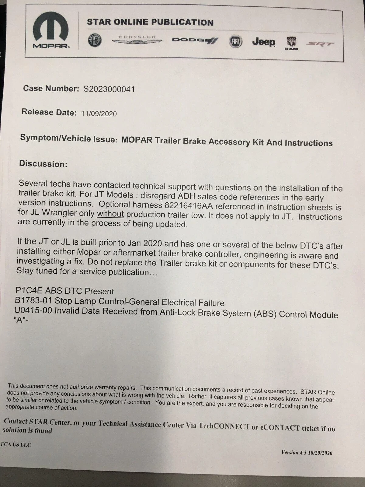

Mopar Engineering has identified an issue relating to the Mopar Gladiator Trailer Brake Controller and an interaction with the vehicle ABS braking system.
This issue affects Gladiator vehicles which were built prior to Jan 1, 2020.
On the affected vehicles built prior to 2020, pressing the manual brake button in the center of the Trailer Brake Controller Knob can cause a Diagnostic Trouble Code to be set by the Anti Lock Braking system.
This issue does not cause any safety issues or any functional changes in the performance of the ABS or ESC systems, but it will cause the Electronic Stability Control Indicator to illuminate in the Instrument Cluster along with a warning chime. This condition will be reset by cycling the vehicle ignition.
This condition can be easily corrected by updating the software in the ABS controller on your vehicle. Your Jeep dealer can perform this update.
There is a Technical Service Bulletin which has been issued to all of our Jeep dealers (TSB #C08 FSAR TSB-394) which communicates the specifics of this update to our technicians.
Mopar thanks each of you for buying our Jeep vehicles and our Mopar Accessories. We apologize for any inconvenience this condition may have caused you.

Check the NHTSA site - on the other hand, Benny posted it on one of his more recent messages.
Reading the TSB does NOT give me a warm fuzzy - ya know what it says - not a quote, I'm paraphrasing here, but this is the gist "we'll tell it not to light up the dash so you won't be annoyed". It's like the old thing - my alternator light glows when I'm driving home at night
Answer:
Put a piece of black tape over it
Yeah, they are basically saying that the fix is to prevent the light. Funny thing - There is NO LIGHT that comes on with this so I am not really sure this is a fix so much as taking out a light bulb or preventing it from coming on!
Seriously, JeepCars said "the error doesn't disable...." Yeah, it did on mine - ABS, forward collision detection and other stuff. I proved that with my truck., That stuff was dead with the error until I rebooted the truck (turned engine off, restarted - damn, I'm too used to mickysoft computers)
So having read what Benny's link is to - it's basically saying "we've recoded the ABS so it won't turn the light on anymore".
I'll let them flash it, but then right out of the gate I will test forward collision, BSM and ABS because on mine, those things went crazy and could not be enabled or disabled, they were frozen. It wasn't a "light coming on".
I'll take it onto the ice in the nearby parking lot and lock the wheels up and see what happens.
Maybe like their brake controller instructions, the TSB is full of dung and wrong, and the fix actually does something other than tell it to not trigger a light......we'll see.
But reading the message from JeepCares and the TSB itself, well, another thing - I got THREE codes, the TSB never even mentions those!
It says "if codes other than the one above exist, fix the OTHER problems" - no, those codes are a result of the brake controller issue. So in that case, the TSB is off the mark.

That brake controller package is ALL that you need if your JT was made in 2020.
If it was made in 2019 then you need the controller (just what's in the box) and the TSB SOFTWARE fix.
NO other hardware is needed, period.
You could show them this and tell them to look it up for themselves if they don't believe you - or tell them to call the STAR team.
Make sure they READ THIS, pay attention to who it is from, and pay close attention to the first paragraph where MOPAR says they messed up.

UPDATE - and good news
Go to the section in bold that applies to you and YOUR Gladiator:
If you have a 2021 Gladiator:
You will NOT have the brake lamp signal line feedback issue.
You can install pretty much any controller you want.
NO SPECIAL WIRING, NO SPECIAL HARNESS, NO NEED TO ORDER Tekonsha harness with diode.
Simply install your trailer brake controller and ENJOY, MOPAR, Redarc or otherwise.
Don't waste money or time on any special harness or flipping wires.
If you have a 2020 Gladiator BUILT in 2020:
You can install pretty much any controller you want, NO SPECIAL WIRING, NO SPECIAL HARNESS, NO NEED TO ORDER Tekonsha harness with diode.
If you have a 2020 Gladiator BUILT IN 2019:
You WILL have the brake lamp signal line feedback issue. BUT - read on!
You can install pretty much any controller you want (MOPAR, Redarc, Curt, Tekonsha, etc.)
Install your TBC (Trailer Brake Controller)
When finished - take your Gladiator to your dealer and point out the TSB information posted by JeepCares and Benny of AllMOPARParts.
If you have the DEALER flash your ABS with the latest software - it FIXES this issue.
You can buy and install any controller you want.
DO NOT WASTE MONEY on a special harness, don't mess with any diodes, don't buy a Ram harness from Redarc and switch wires around. THERE IS NO NEED NOW.
Install the MOPAR trailer brake controller- IGNORE the bits about any harness, no need to flip it on the mounting plate.
When done with the install, drive your JT to the dealer and point them to the information (below) about the FIX from Jeep.
IT IS FREE. It's a WARRANTY REPAIR.
THIS FIX TOOK CARE OF MINE. No argument, no hassle, they just did it and tested it and said yeah, that took care of it - and it did.
Here is the link to the post by @JeepCares -
https://www.jeepgladiatorforum.com/...r-my-impressions-and-review.36527/post-616520
Here is the PDF of the TSB (see attached brake-controller-08-102-20.pdf)
And here is the info telling your dealer to ignore the silly instructions about any sales code or wiring harness -
Jeep Gladiator Mopar factory trailer brake controller - my impressions and review 044DD5A4-59F8-4180-B3FB-907D1B3E90FF
