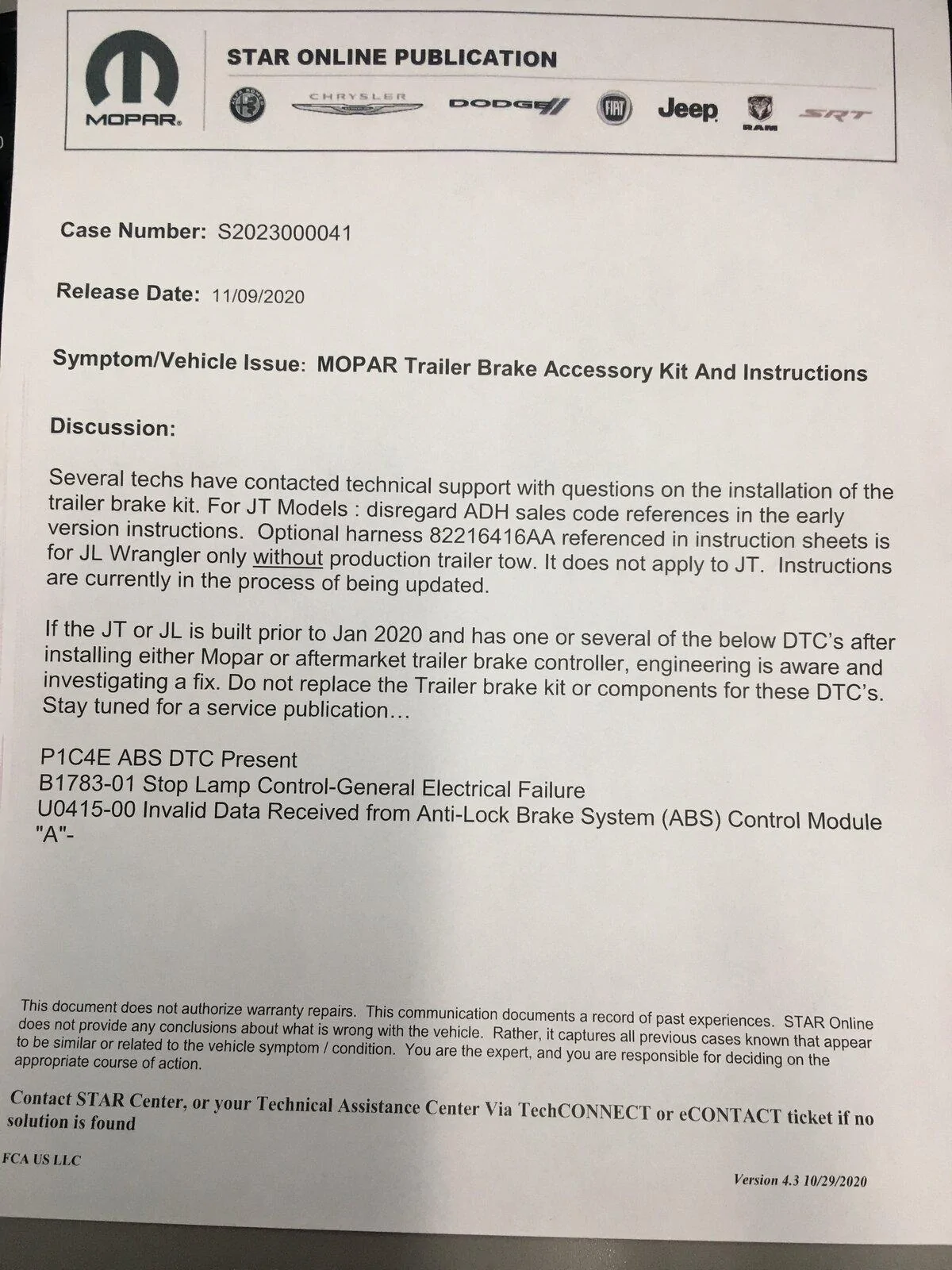

UPDATE - and good news
Go to the section in bold that applies to you and YOUR Gladiator:
If you have a 2021 Gladiator:
You will NOT have the brake lamp signal line feedback issue.
You can install pretty much any controller you want.
NO SPECIAL WIRING, NO SPECIAL HARNESS, NO NEED TO ORDER Tekonsha harness with diode.
Simply install your trailer brake controller and ENJOY, MOPAR, Redarc or otherwise.
Don't waste money or time on any special harness or flipping wires.
If you have a 2020 Gladiator BUILT in 2020:
You can install pretty much any controller you want, NO SPECIAL WIRING, NO SPECIAL HARNESS, NO NEED TO ORDER Tekonsha harness with diode.
If you have a 2020 Gladiator BUILT IN 2019:
You WILL have the brake lamp signal line feedback issue. BUT - read on!
You can install pretty much any controller you want (MOPAR, Redarc, Curt, Tekonsha, etc.)
Install your TBC (Trailer Brake Controller)
When finished - take your Gladiator to your dealer and point out the TSB information posted by JeepCares and Benny of AllMOPARParts.
If you have the DEALER flash your ABS with the latest software - it FIXES this issue.
You can buy and install any controller you want.
DO NOT WASTE MONEY on a special harness, don't mess with any diodes, don't buy a Ram harness from Redarc and switch wires around. THERE IS NO NEED NOW.
Install the MOPAR trailer brake controller- IGNORE the bits about any harness, no need to flip it on the mounting plate.
When done with the install, drive your JT to the dealer and point them to the information (below) about the FIX from Jeep.
IT IS FREE. It's a WARRANTY REPAIR.
THIS FIX TOOK CARE OF MINE. No argument, no hassle, they just did it and tested it and said yeah, that took care of it - and it did.
Here is the link to the post by @JeepCares -
https://www.jeepgladiatorforum.com/...r-my-impressions-and-review.36527/post-616520
Here is the PDF of the TSB (see attached brake-controller-08-102-20.pdf)
And here is the info telling your dealer to ignore the silly instructions about any sales code or wiring harness -
Minor point of clarity — but before Jan 8 2020 - I have this issue and a build date of Jan 3rd. I have both the aftermarket cable with diode and mopar kit cable — will swap them before taking to the dealer wednesday to have it flashed, but leaning toward putting the aftermarket cable in as it seems like the proper fix as opposed to some software being told to ignore it as opposed to whatever jeep started doing on Jan 9th which is not likely a software fix. Thoughts?
178
29,091
34,572
Yes, I supplied BOTH documents so people would have the details. One says "before January" while the other specifies a date. I'd hope people would be clever enough to read both and figure out although I find many aren't even aware the day and HOUR of build are clearly specified on the door frame................
For me the proper fix IS the TSB. The diode/harness is a work-around. Any subsequent ABS upgrades/updates will include this fix anyway so if a person gets an ABS flash next November due to some OTHER issue, then next December installs a brake controller, they won't have any issues.
I'd bet the change in January 2020 was indeed software.
I also suspect that the documents we see are grossly oversimplified and it's not laid out as "ignore" as much as what to not do in such cases.

Update—after completely unmarrying the tazer I still got the error. Sent it back to dealer. Reminded them again to please review and act on the BCM TSB that I showed them last time (and left the print out on the seat). They admitted they didn’t do it last time but finally got it done.
So I can report it appears to be working correctly with the mopar controller and the TSB reverence’s earlier. Finally! Got the tazer reinstalled and married up again and also no issues so far but don’t anticipate any further issues.
