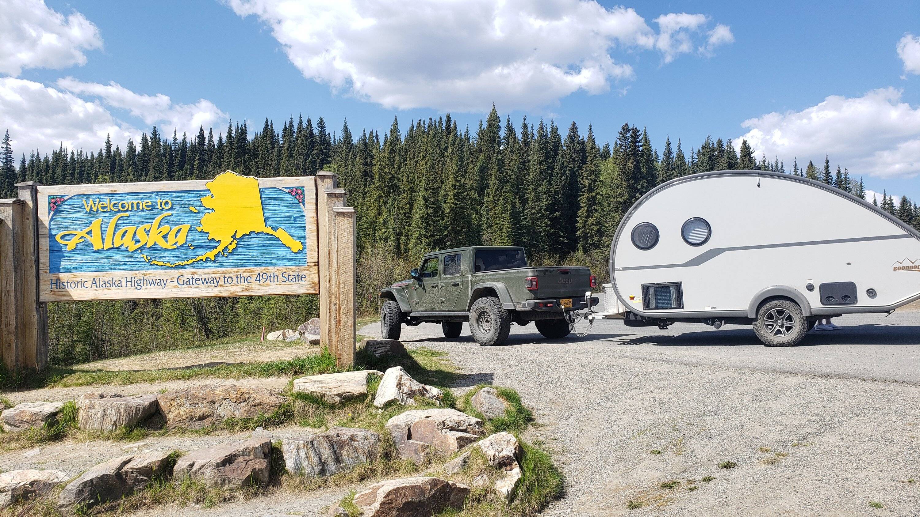

Jeep Gladiator More MPG confussion 20220530_142609
The main reason for our decision to trade up to a diesel instead of the 3.6-liter gas; a 3200 lbs. Tab 400 travel trailer. The truck literally doesn't know it's back there. However, the gas 3.6 gasser is a great engine, I loved it! Don't get too caught up in MPG's, that's not why any of us purchased a Gladiator.

Did you tow the trailer with the gas engine first?
