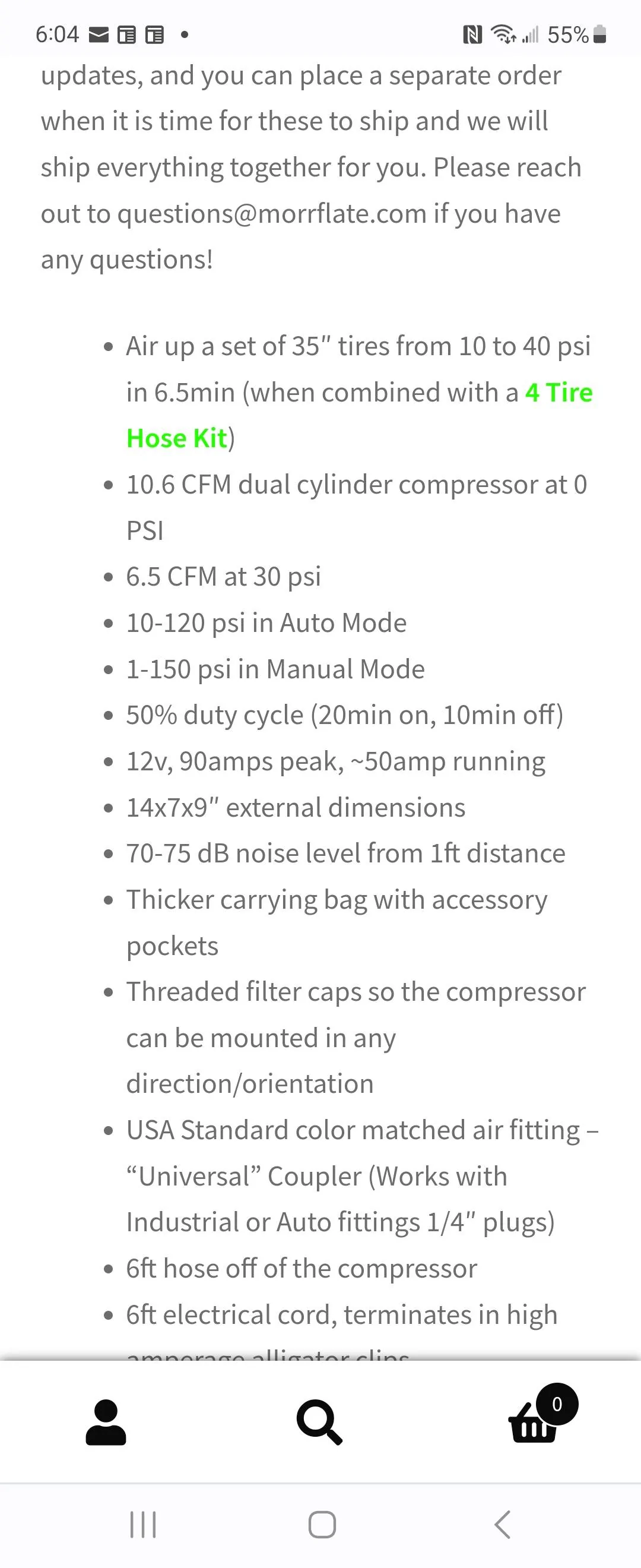

I didn't look at all the differences between the brands carrying the digital version, but your mention of the M maybe being manual mode surprised me. As mentioned previously, they don't recommend this pump for single tires as it ruins the duty cycle from back pressure. That was one benefit I thought the digital versions had; a button that could switch it from single to multi tire.
But maybe that's just the Ez Flate version. I can't tell what the buttons say on the Thor version, but their description says it automatically detects the number of tires connected.
The 5th bullit point down mentions manual mode.

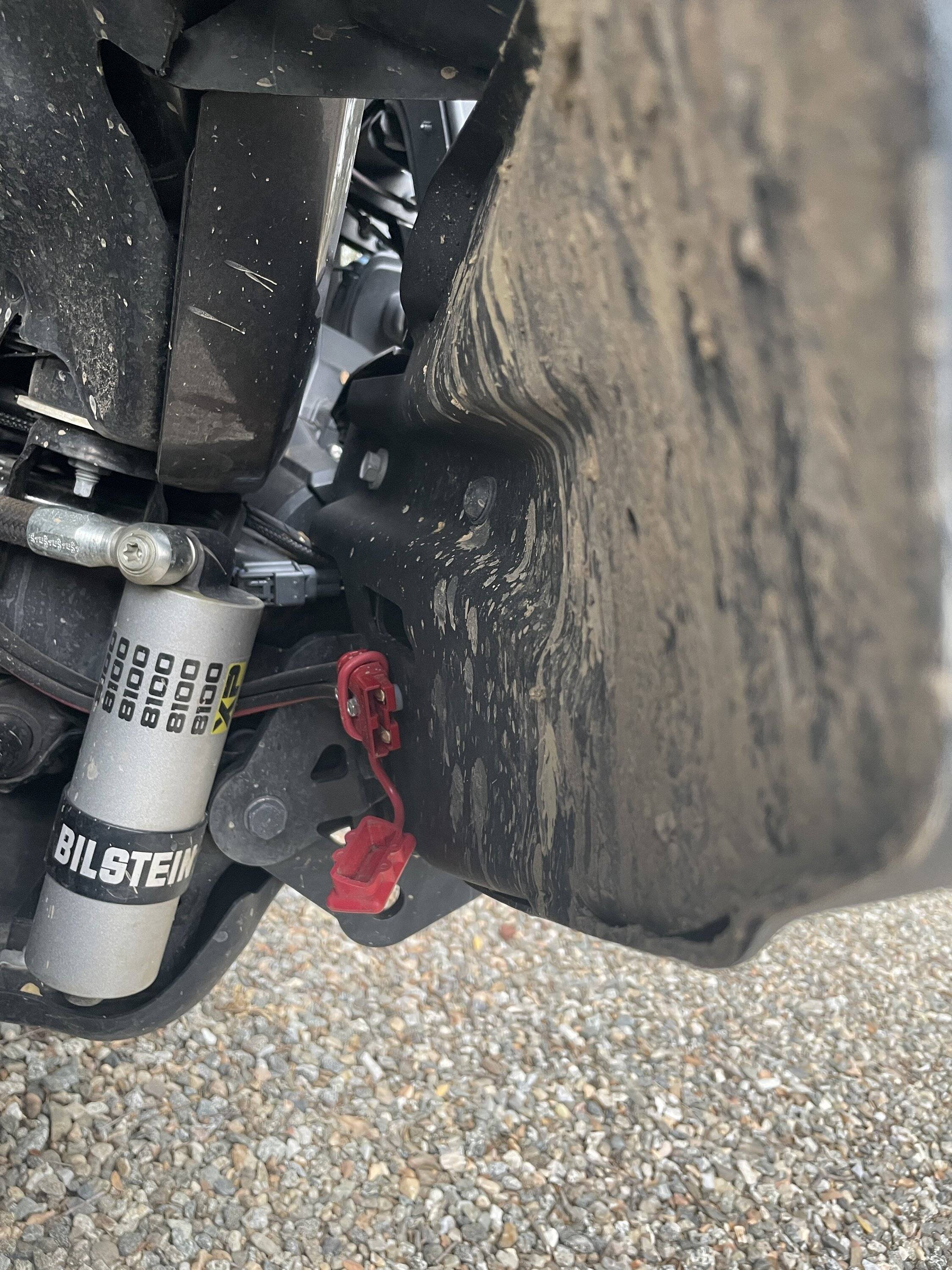

I put an Anderson plug under the front bumper directly wired to the battery. Simple to connect the pump without opening the hood.
Interesting. I was thinking about something like that. Any pics or tips on how you did that? Did you put a disconnect between battery and plug? Thanks!

Hey, thanks for that tip! I didn't know they had those. They will certainly come in handy. I just ordered a set. Here's a link for anyone interested :
https://morrflate.com/shop/morrflate-accessories/morrflate-caps/
Juniper Overland did it for me. It’s attached under the front bumper passenger side. No switch or breaker - it draws a lot of current so they would be BIG.
I spliced the compressor pump with 2 more connectors so I can use the clamps if I need to (maybe to help air up someone else).
