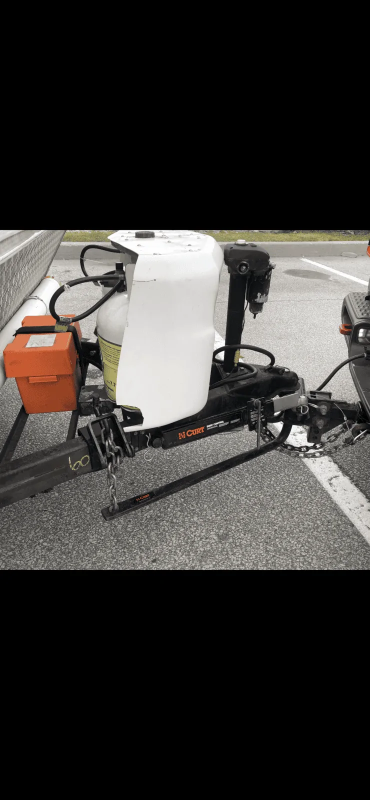

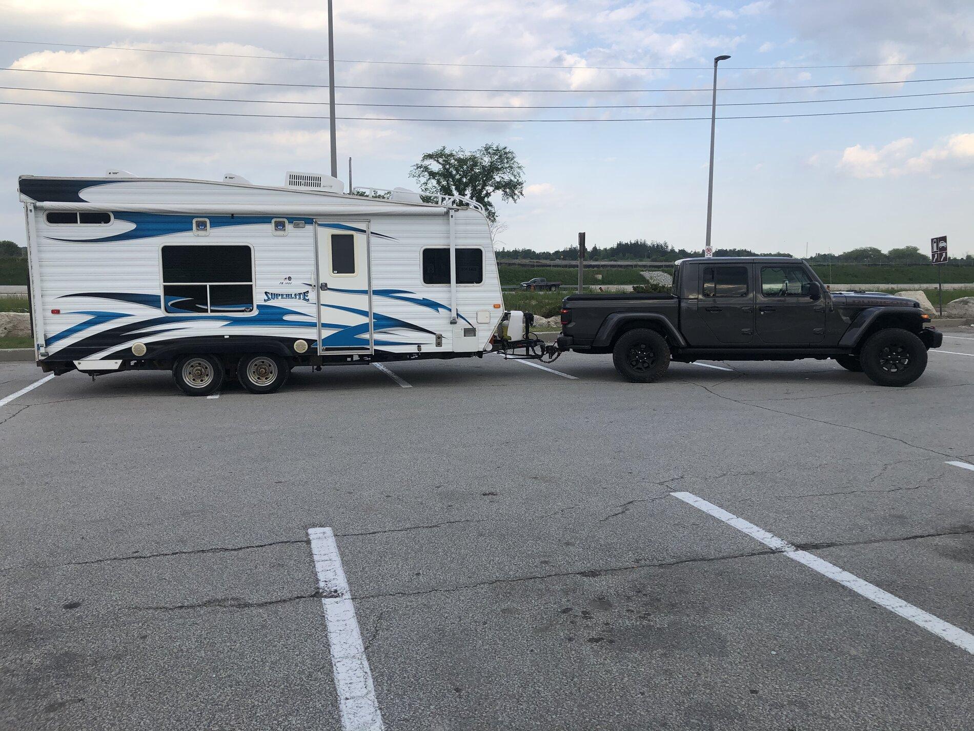

4700 lbs, but 2nd pic, as many mentioned, is a no brainer, wouldn’t tow without trailer braking, weight distribution, and sway bars.
Pulls like nothing is there.
Steep long uphill fuel economy...different story, but was expected.
