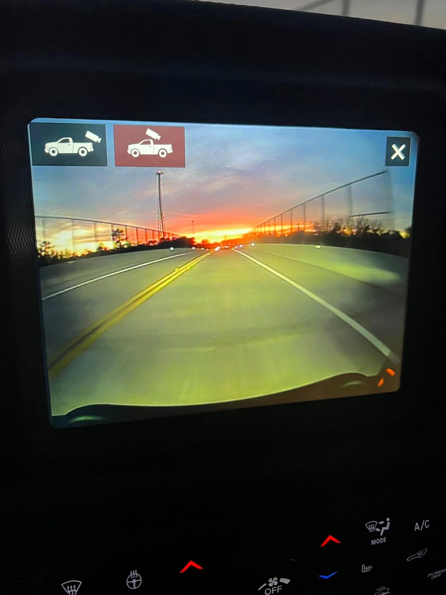

Done. DONE!
The parts in Post 1 are all correct. You can reuse your existing washer harness by depinning and reversing the 2 wires at the pump connector. I said eff it and just bought the right harness.

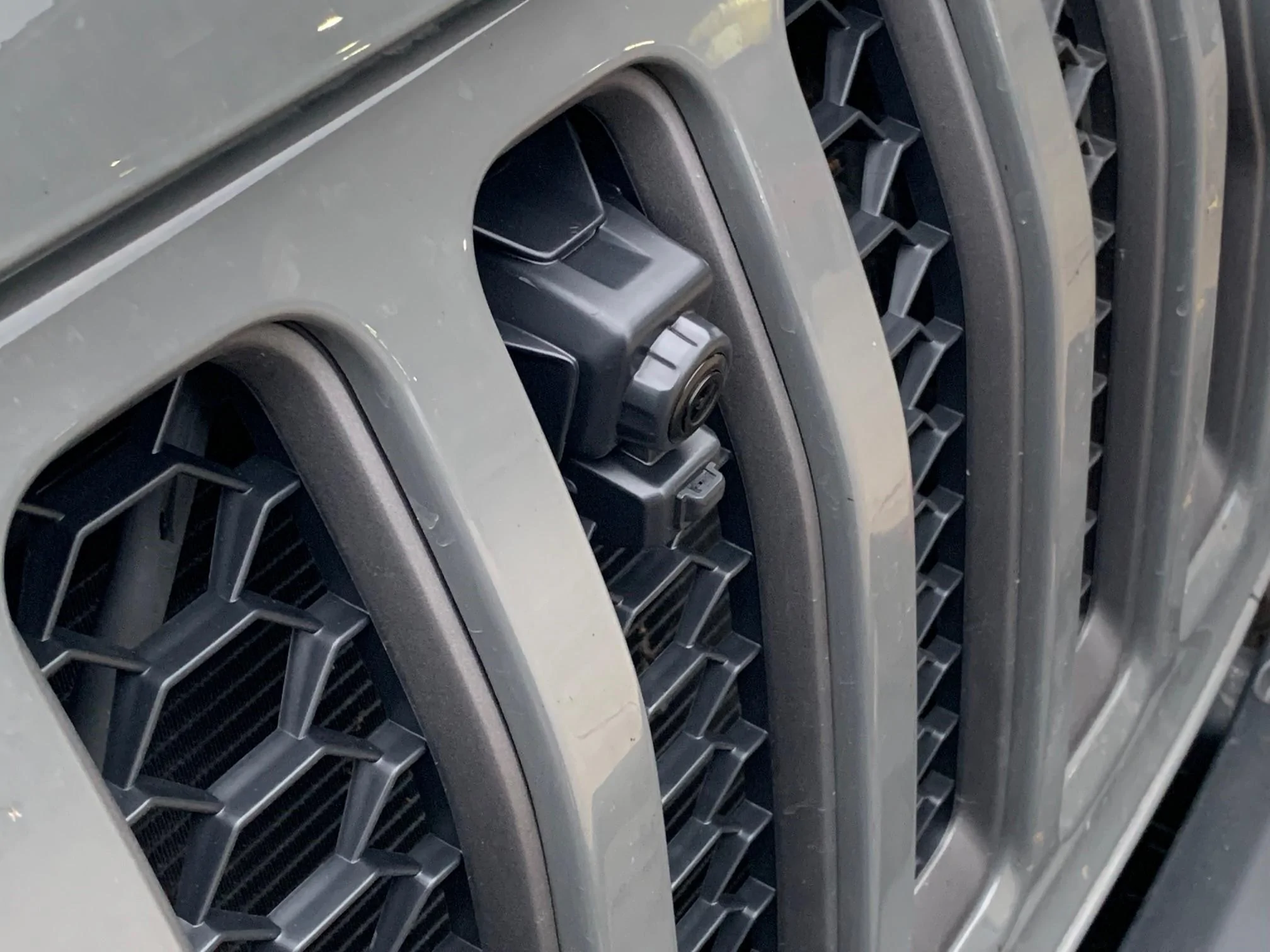

I'm still working on getting all the parts. I need to reach out to @Jimmy07 to get my harness. For now I have a Z-Auto camera in the factory trail cam grille housing.
Jeep Gladiator My OEM Front Trail Cam install thread tc1
Jeep Gladiator My OEM Front Trail Cam install thread tc2
