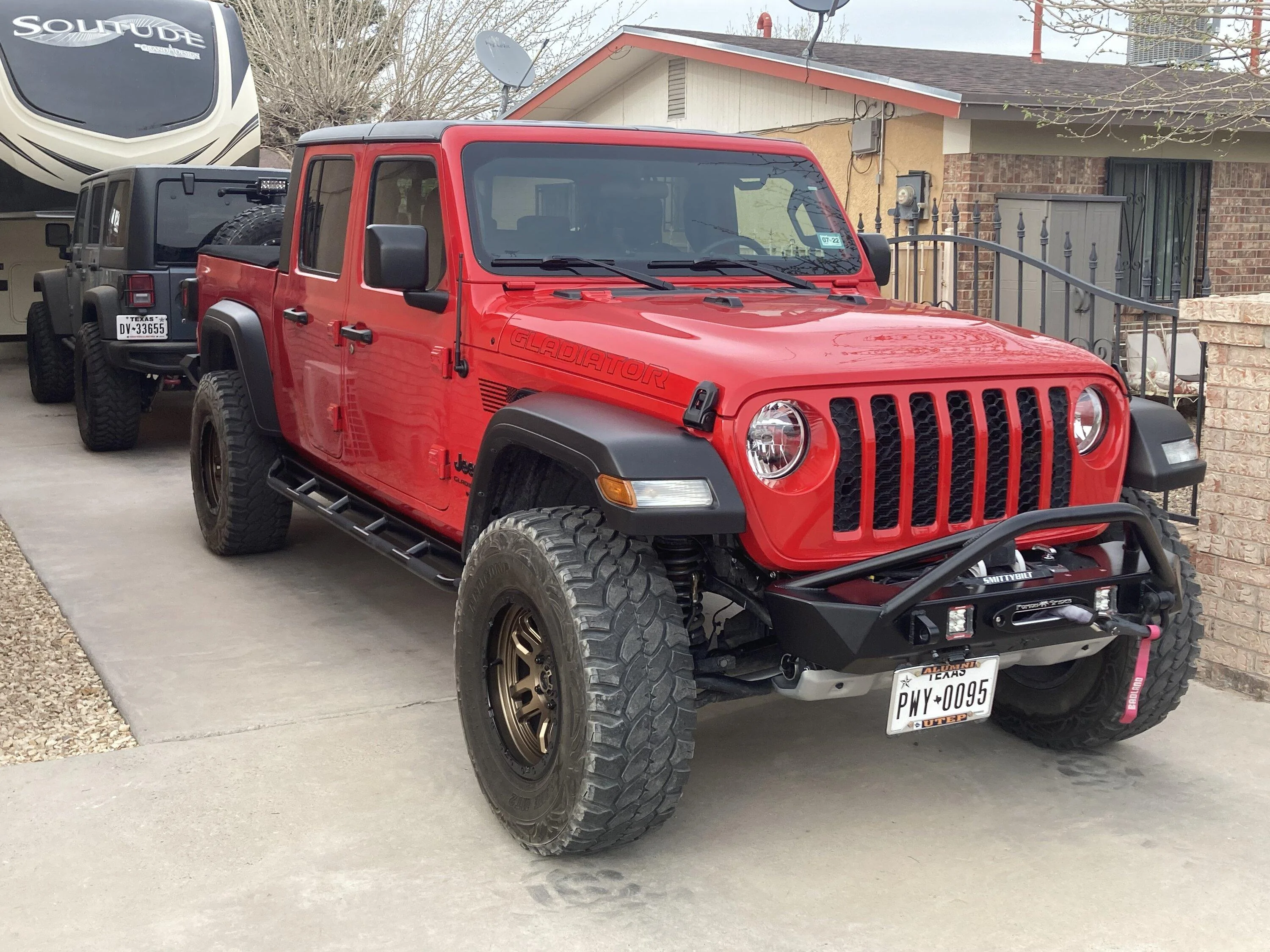

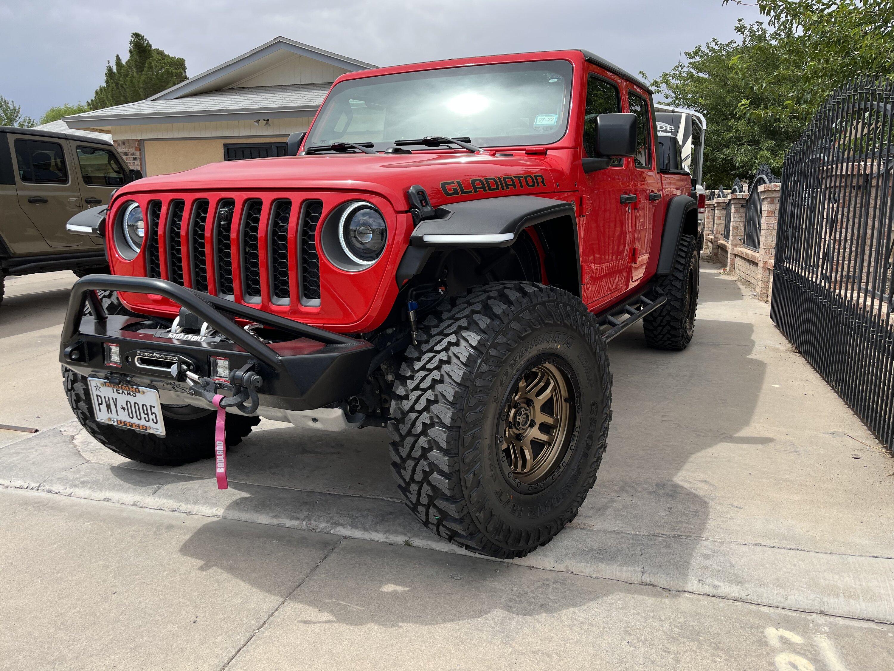

My truck is a sport, so it came with the simple one piece grill, I wanted a Rubicon grill for the granite colored accents around the lights/grill slots to match my Oracle headlights.
Jeep Gladiator My OEM Front Trail Cam install thread IMG_4785
Too bad about the CVPM not working with the 7 inch radio, although I figured that was a long shot.
Wondering if I can retrofit the Z-Auto camera into the trail-cam housing, or if upgrading to a Stinger 10" radio system might make more sense to get a better radio setup AND the trail cam working. Don't really want to buy the 8.4 coming from the 7, not that big an improvement.
