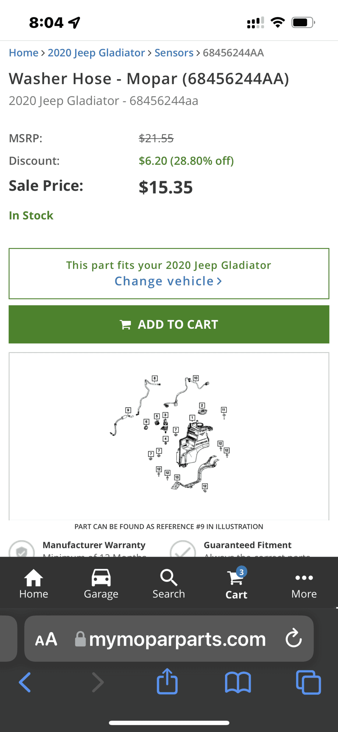

So you will probably need the washer hose from the pump to the grill hose (see screenshot) and the jumper harness (see Jimmy’s parts list) for the Trailcam, otherwise your washer inputs will be backwards (cam washer soft key will run hood nozzles and wiper stock will run the Trailcam nozzle).
