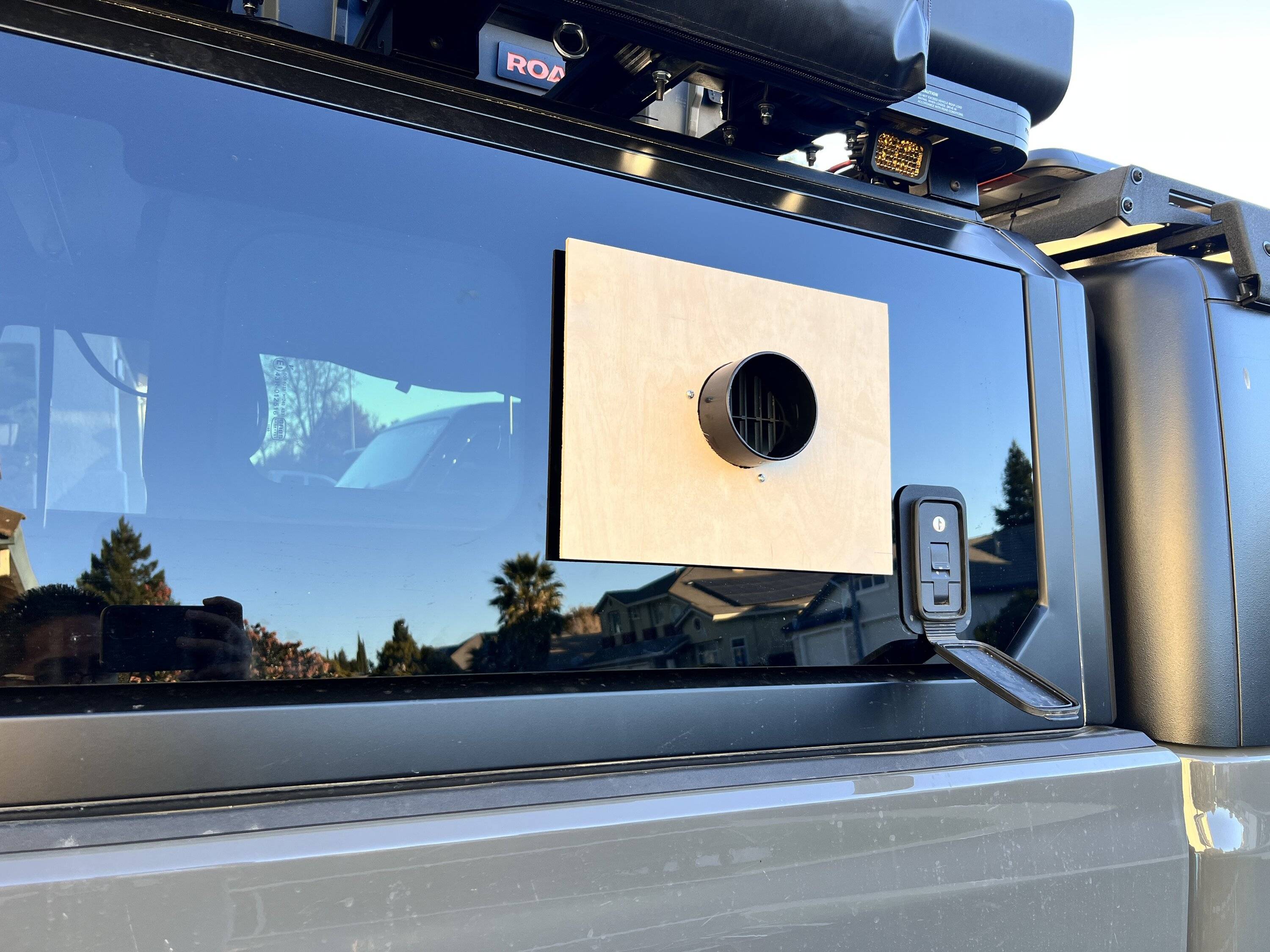

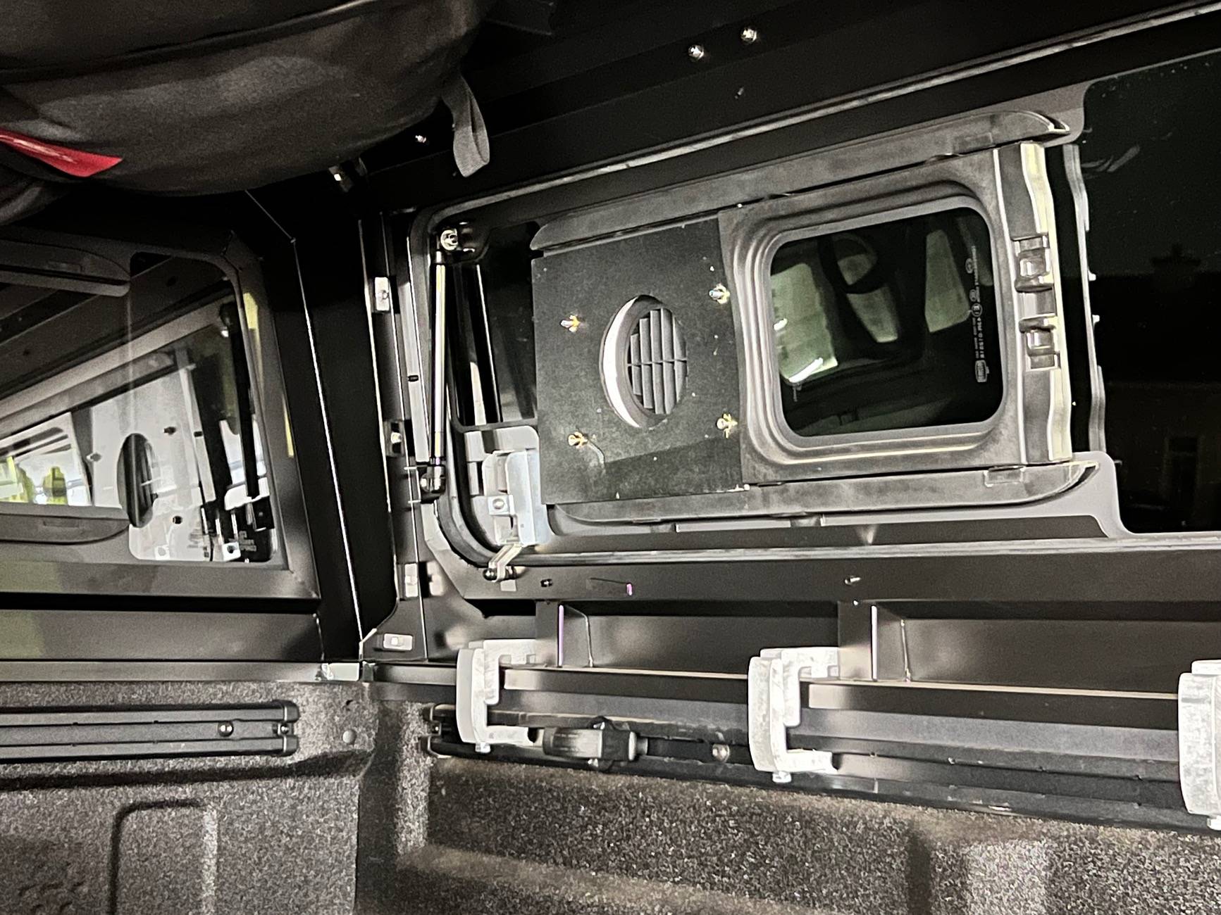

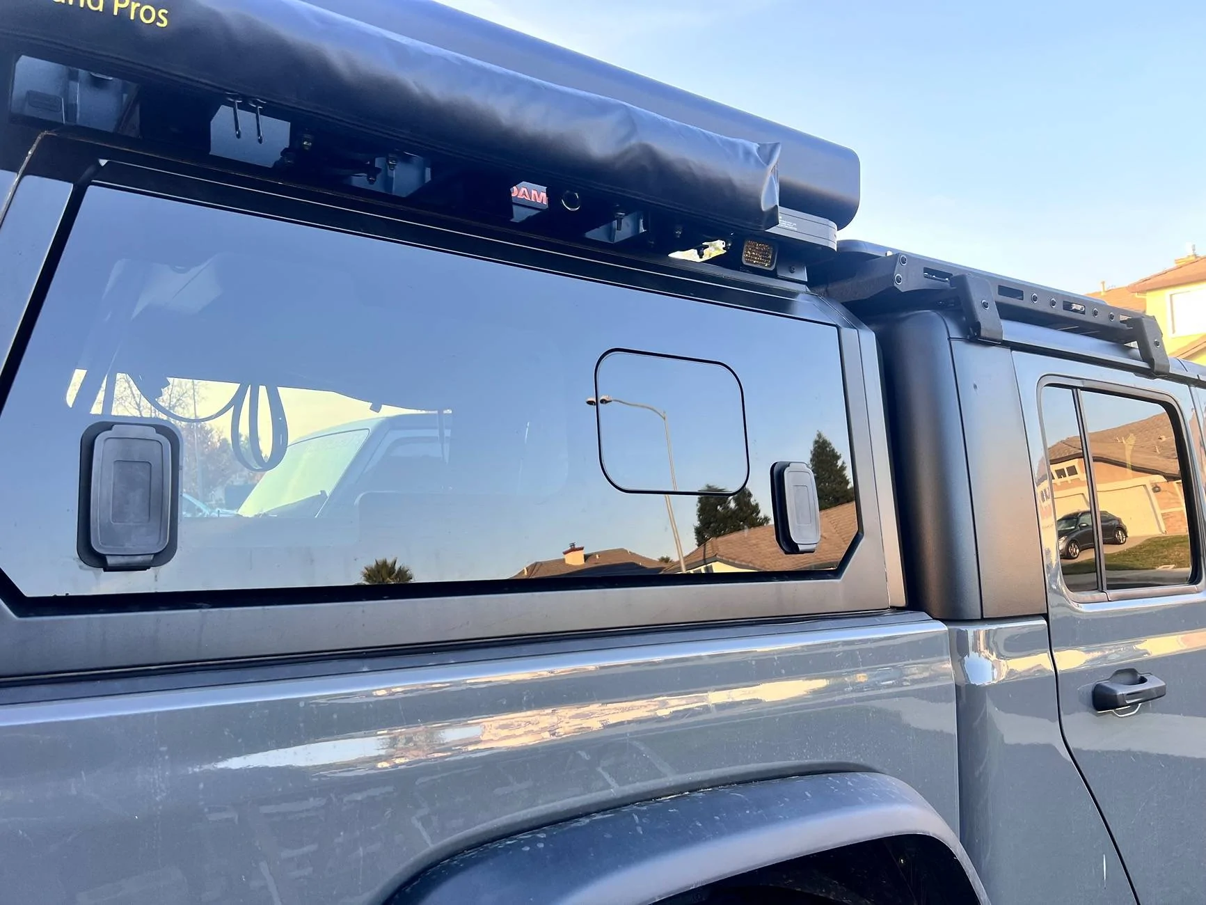

DId you cut a hole in tempered glass or remove that glass panel for something else?
svc707
svc707
steve
Apr 28, 2021
515
674
Vacaville, California
2021 Gladiator Mojave
  • Thread starter
  • Banned
  • #6

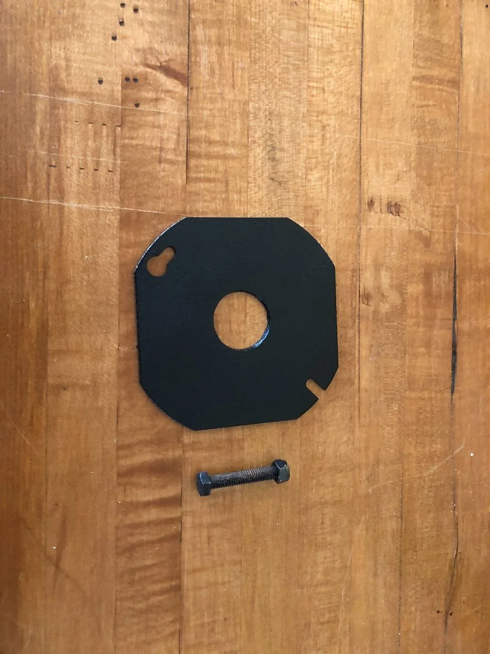

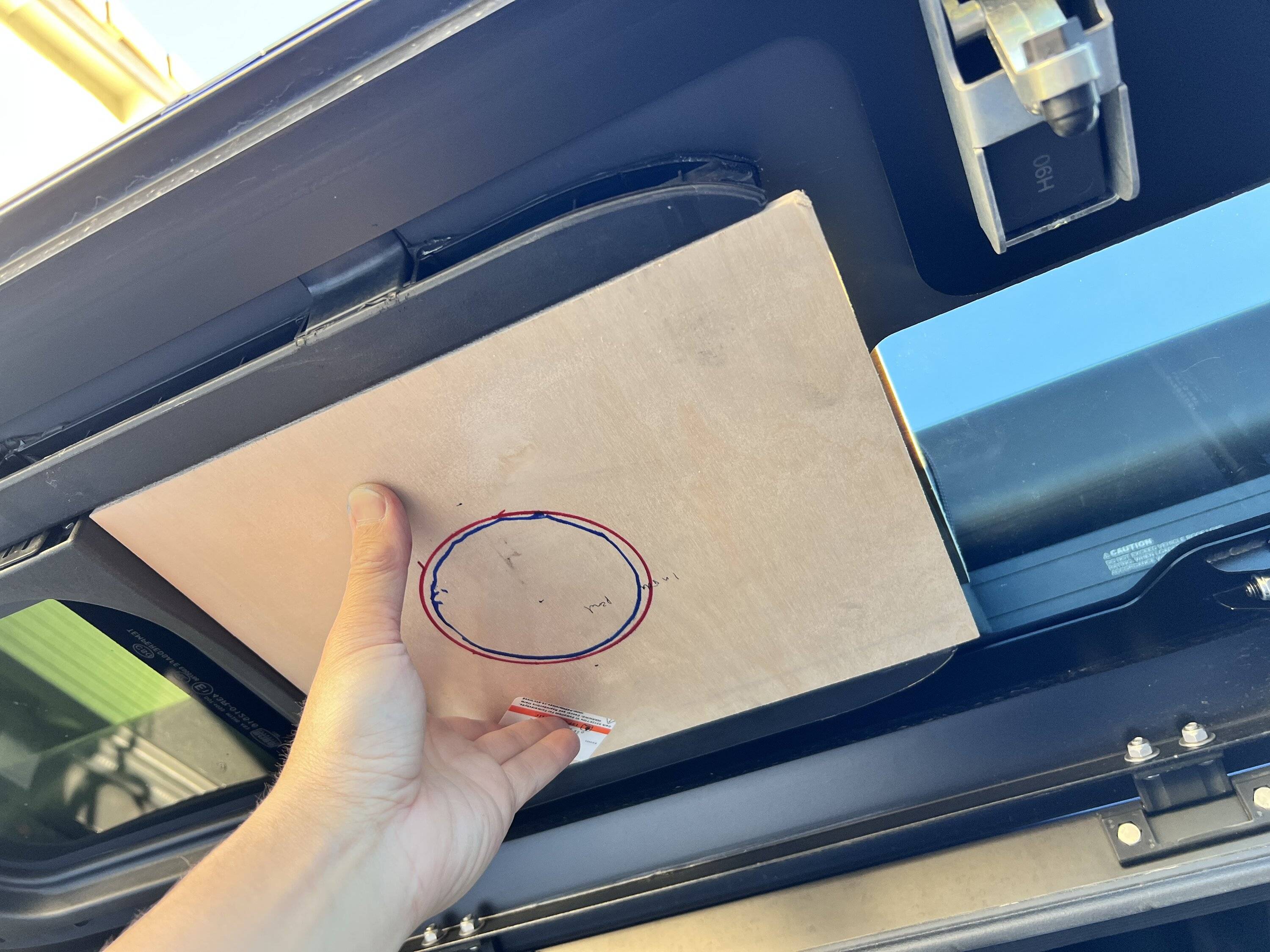

just slide it open or closed and my pass through is designed to sandwich the glass between with a rubber seal against the actual glass .
once I get all the kinks out and test it I might order thicker abs plastic or aluminum and fine tune it.

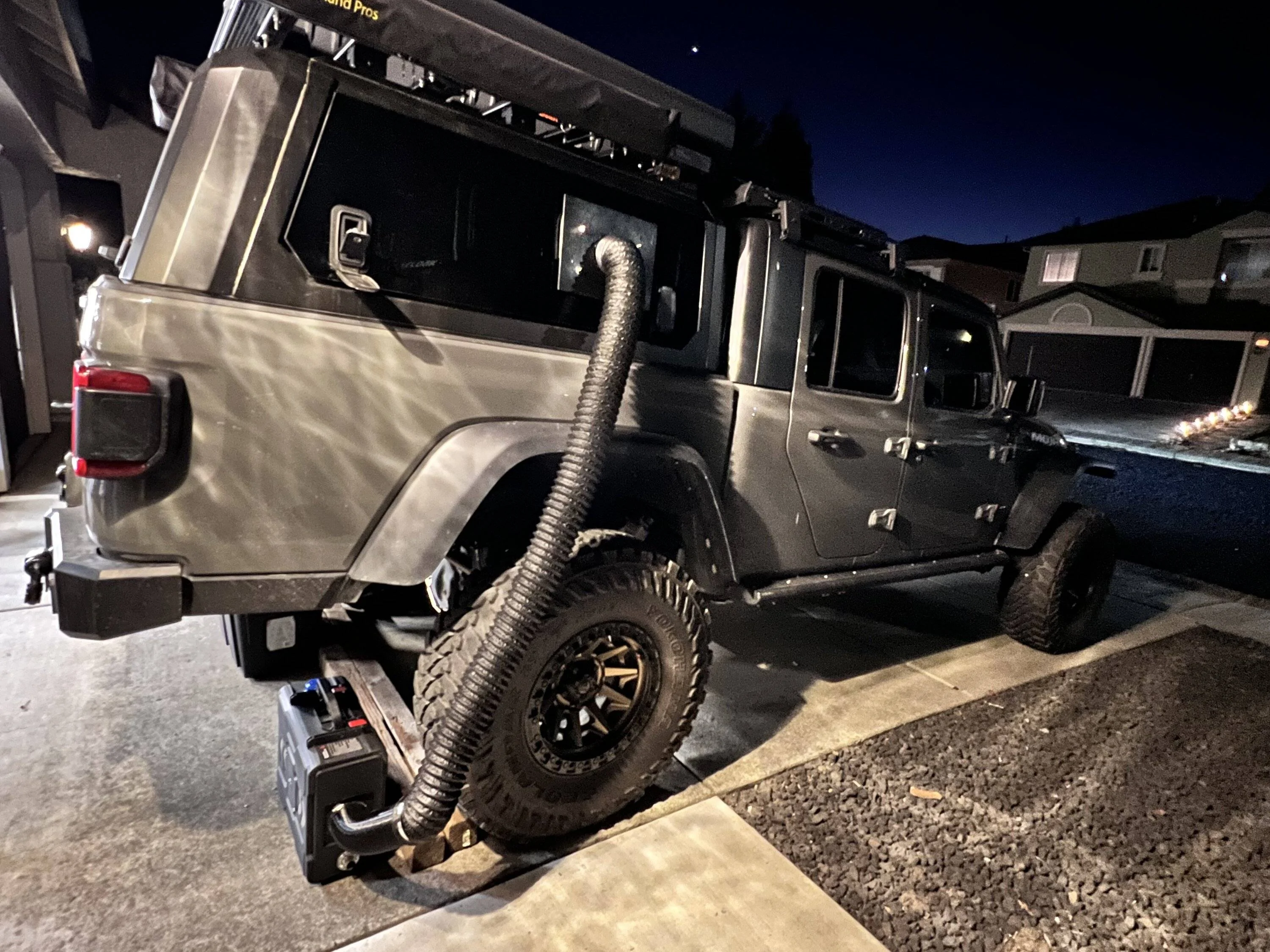

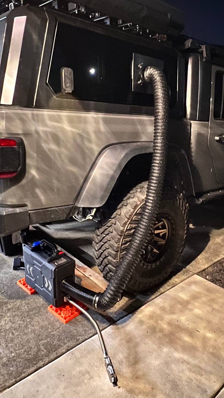

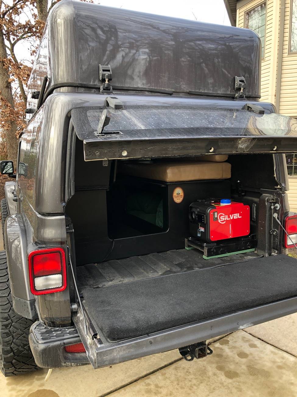

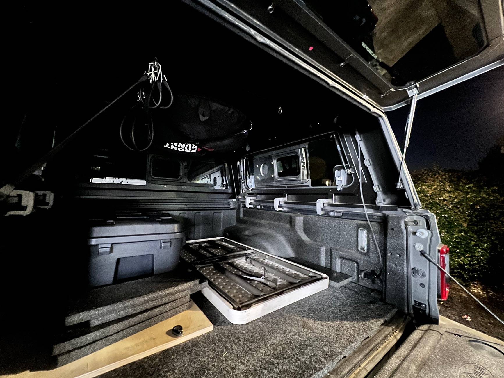

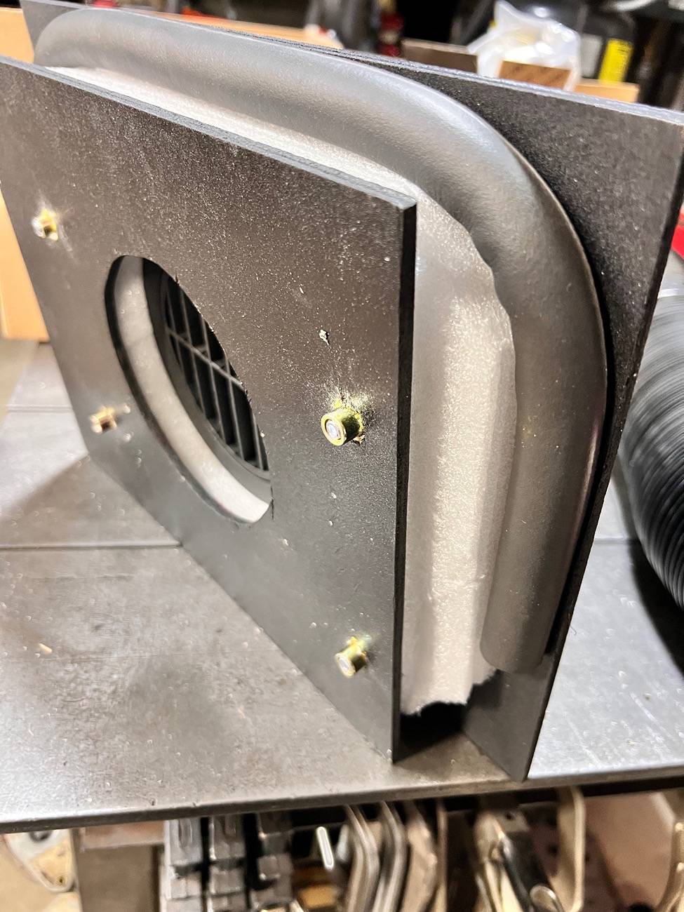

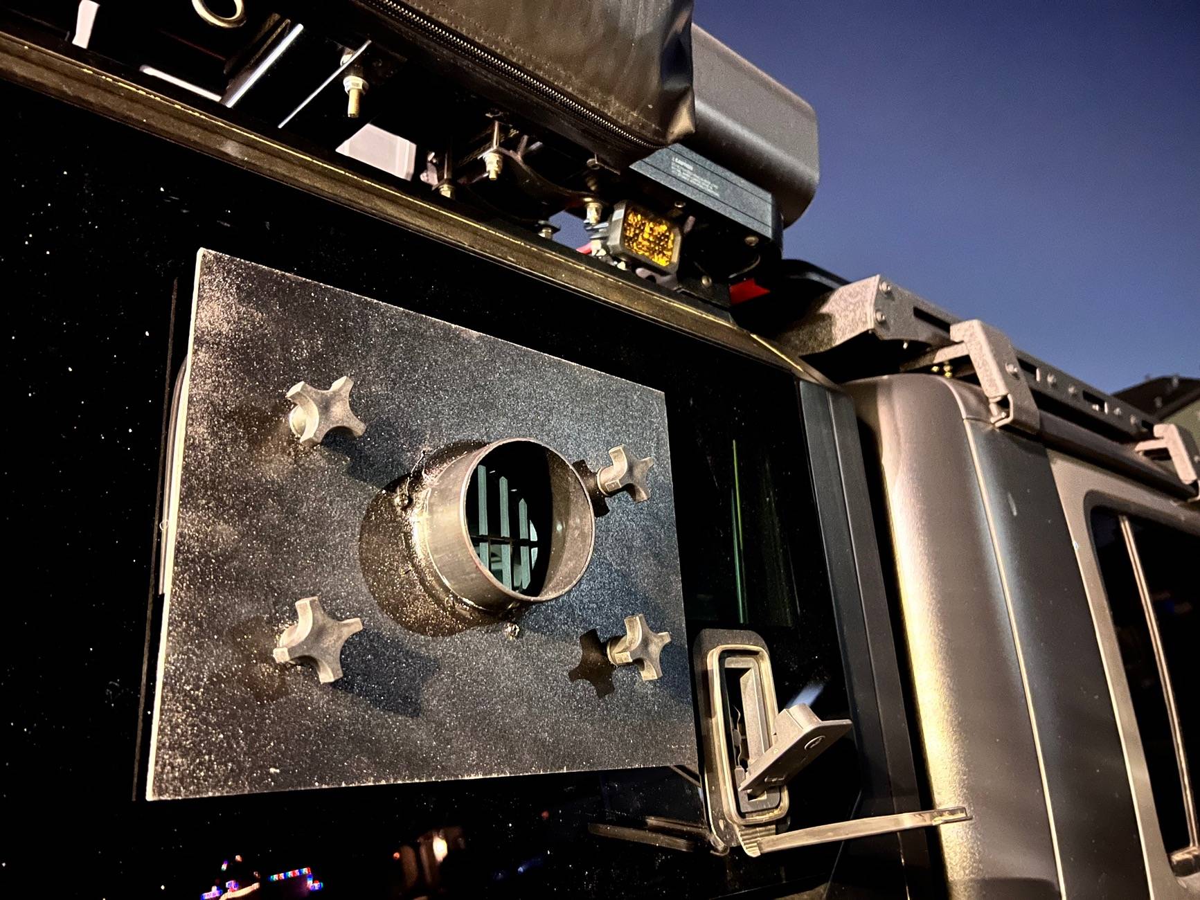

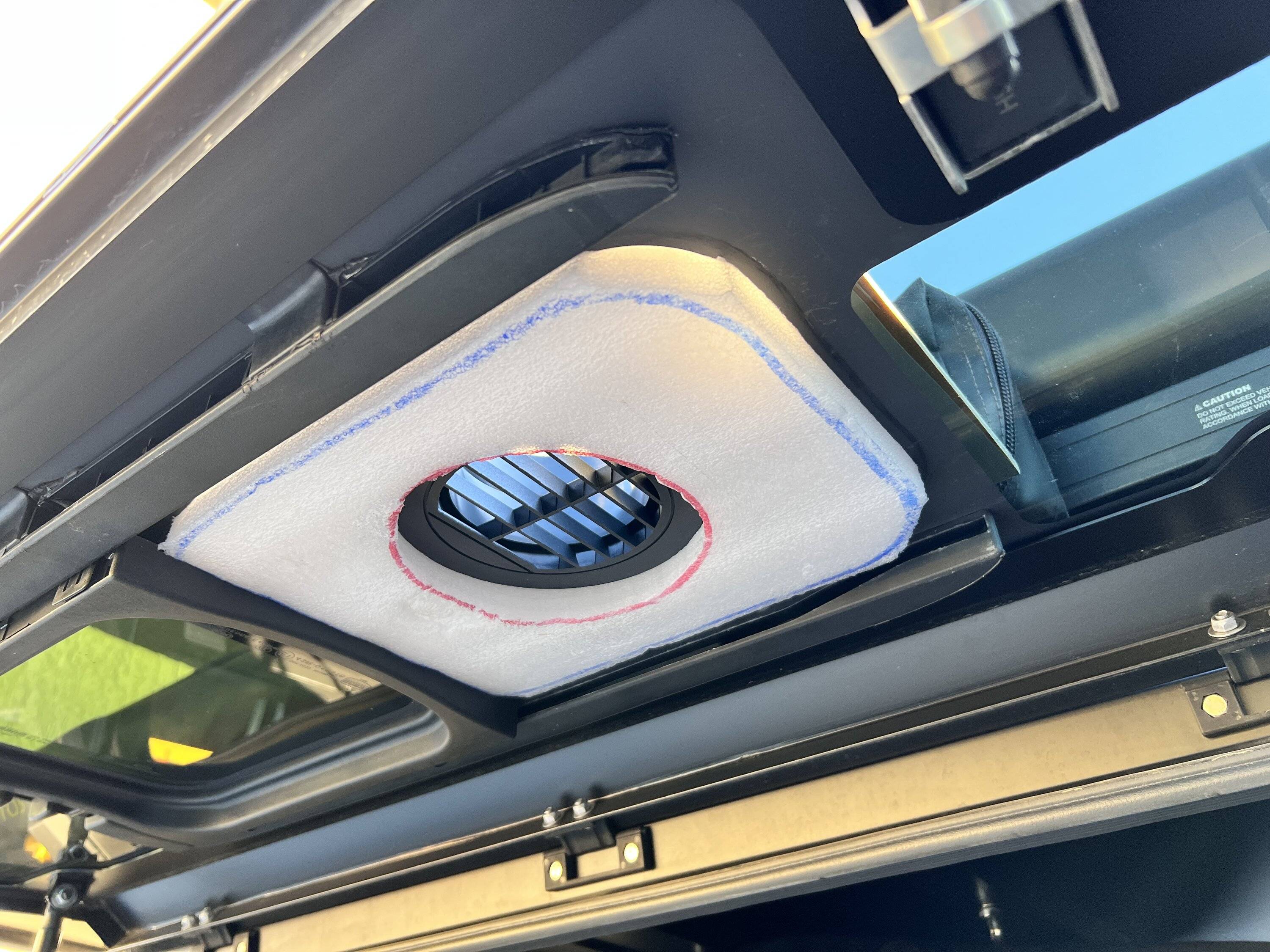

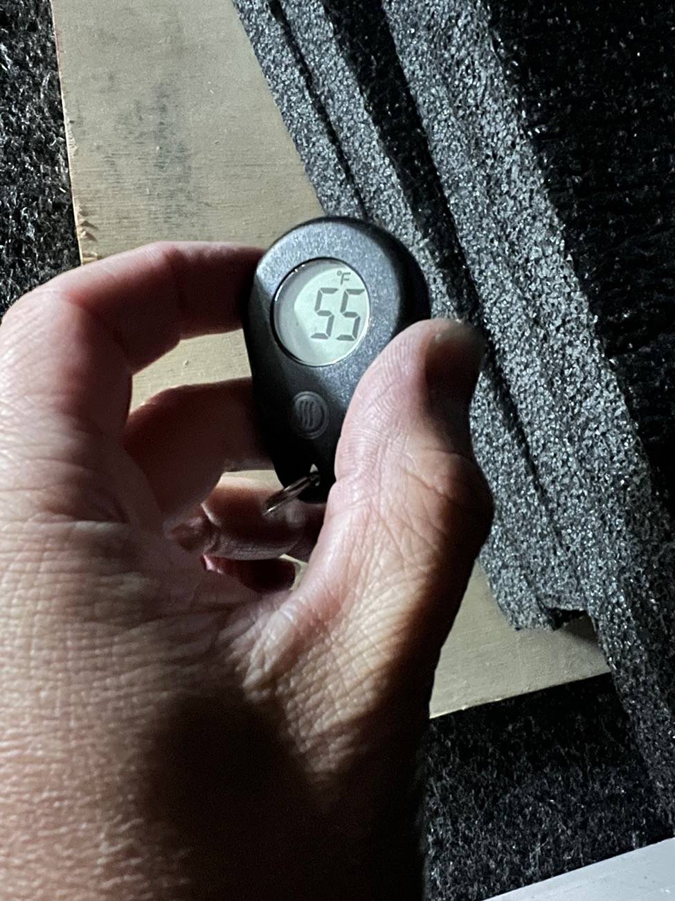

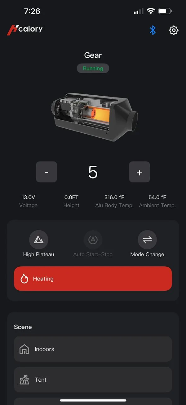

Test run preheating without anything but whatever inside it. Added nutserts and knob screws for easier install. Used a partial weather seal I had. But I’ll run it for an hour and see where it sits temp wise.
another thing to think about is. The rsi cap has a vent which since there’s not actual flap or door. If there’s too much pressure inside it’ll just vent out the top. If it’s too hot I can regulate by opening window(s) for a cross draft. And this Hcalory unit it Bluetooth so I can turn it down while inside

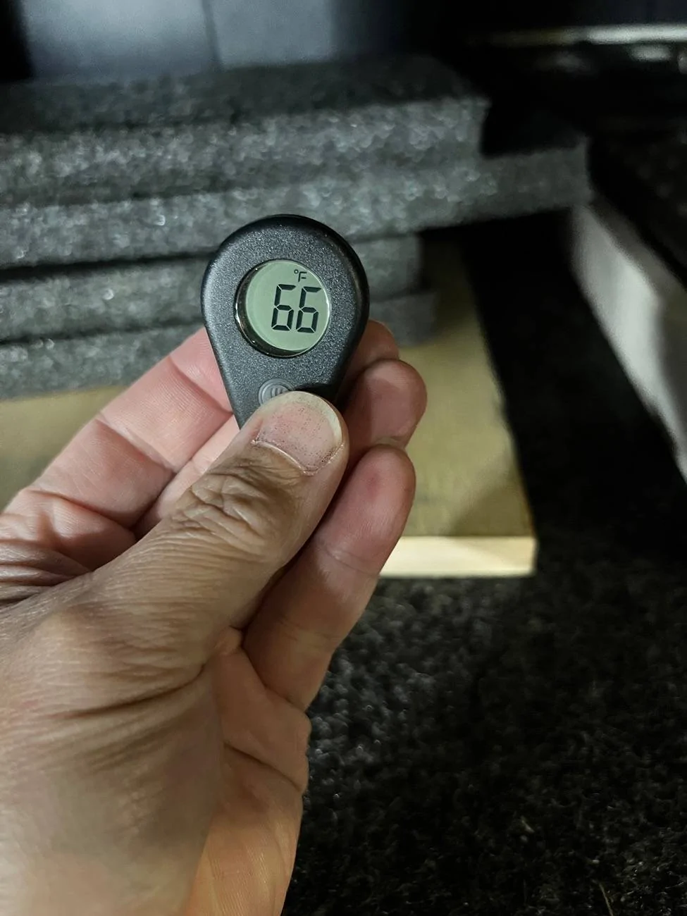

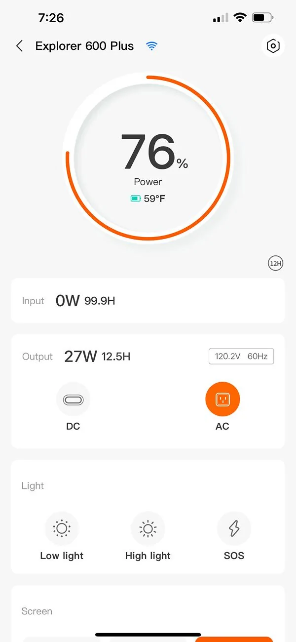

Roughly 40 minutes went by. You can feel the cap on the outside is warming up already. So with air flowing circulating if you will. Just by touch the opposite side of the vent is warmer when touching the steel cap. And yup we’ve got a 10 degree change already. Figure once all the interior warms up and the cap itself warms up, I don’t have any insulation stuck to cap, it’ll be nice and toasty. Oh and yes I already use an electric blanket inside too. I’m thinking I’ll get one of those tubes to seal of the two windows from cap to inside gladiator too so I can reach in there or run extension cords from the Jackery.

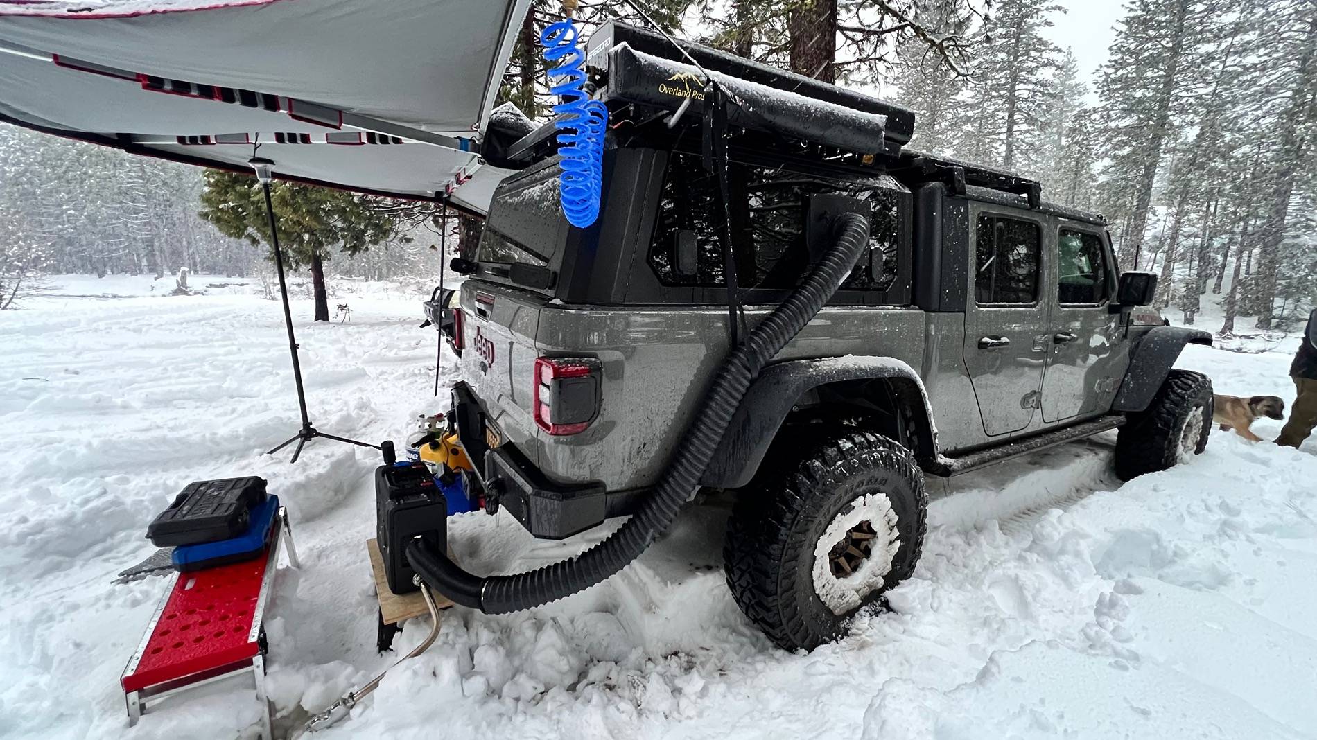

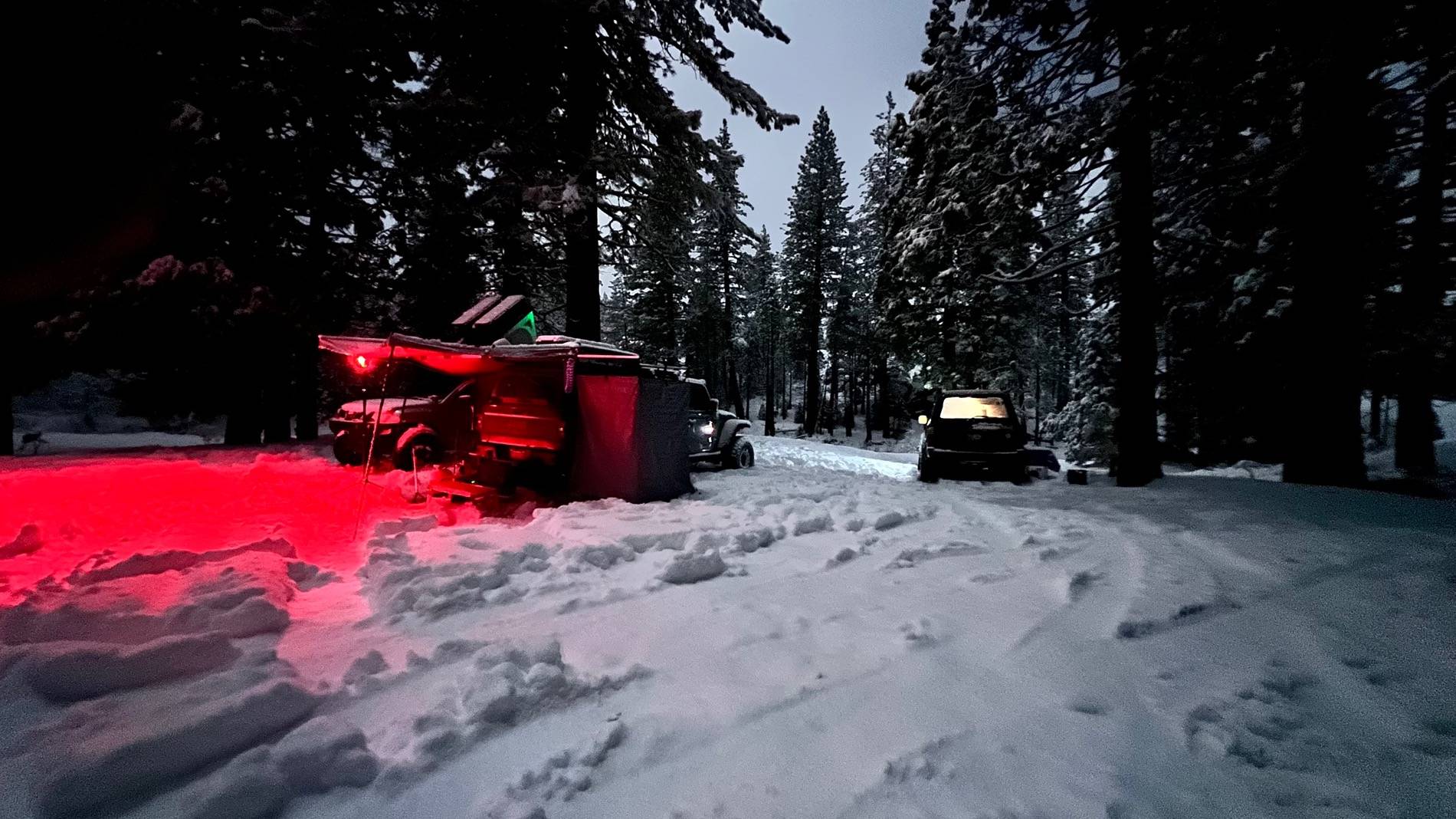

Camped out in the snow , zero carbon monoxide readings. At first start up though it was reading 10 points. But definitely could smell it was still heating up. But enough about, enjoy the outdoors!

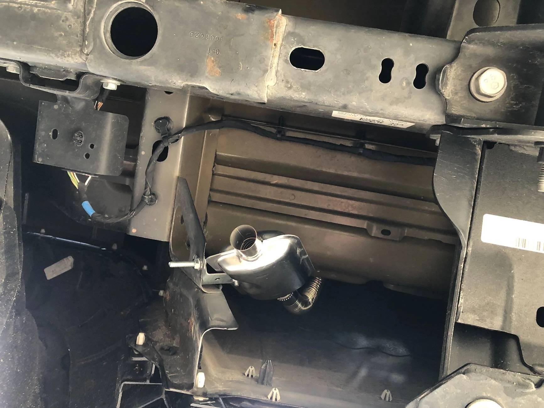

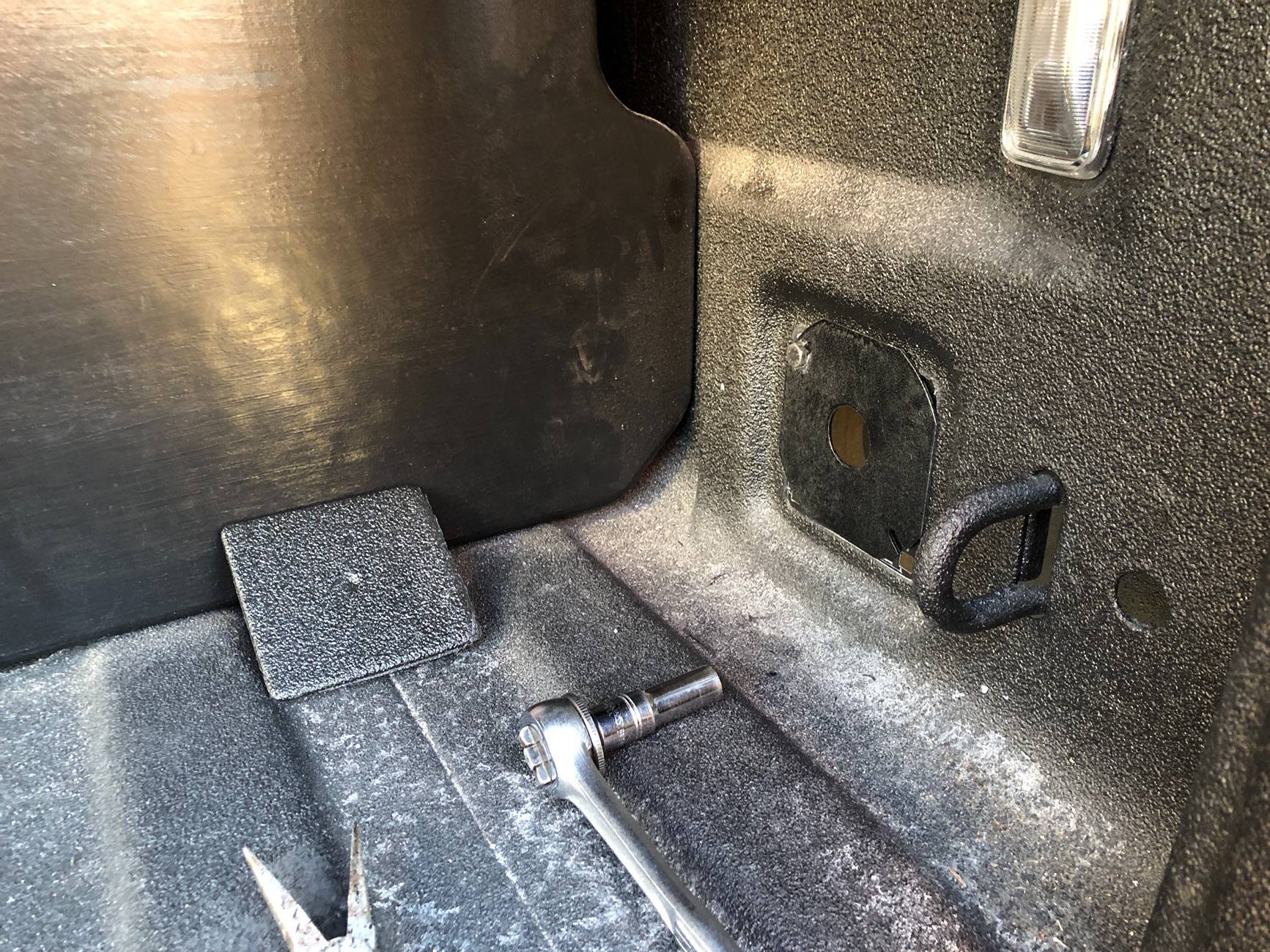

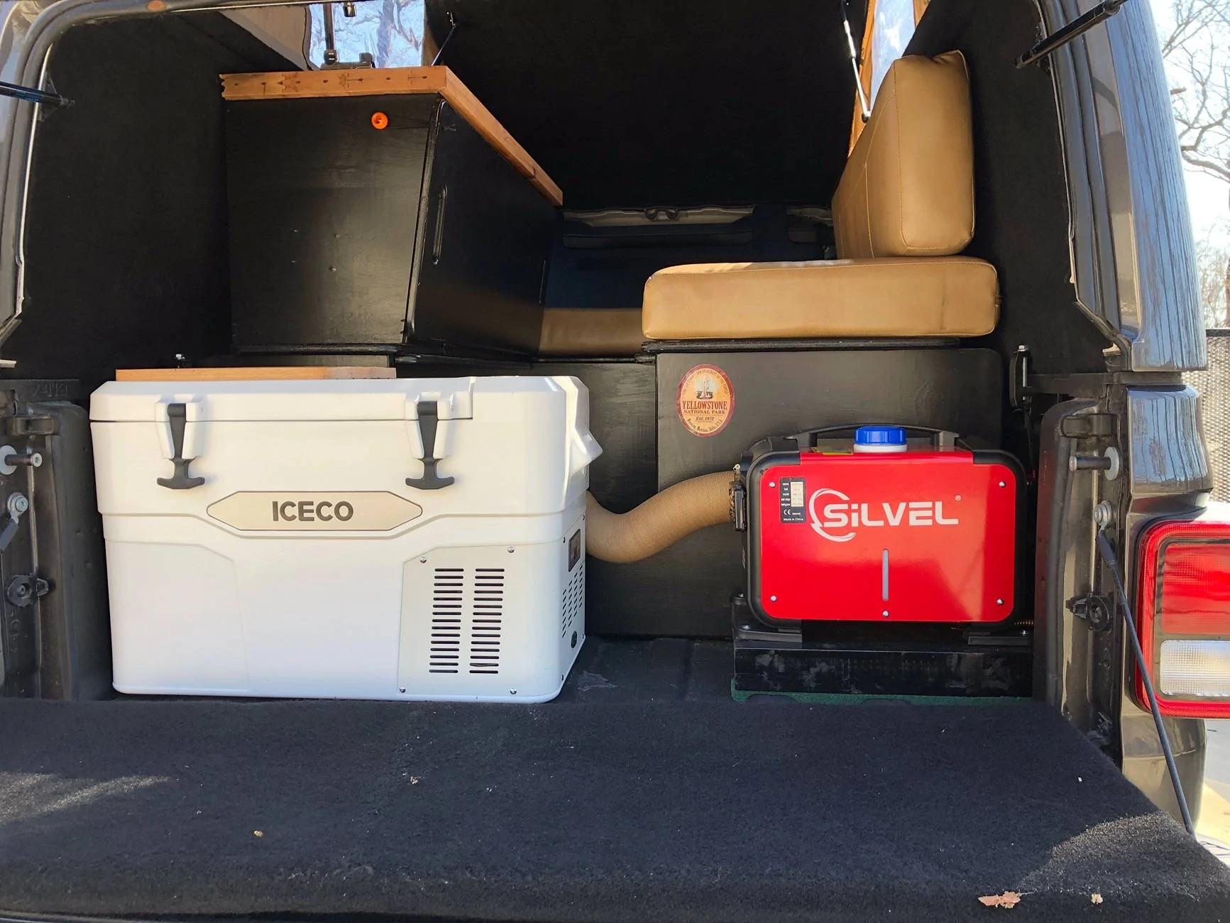

Nice setup! These diesel heaters are great for cold camping. I installed mine inside and routed the exhaust through the 120v accessory hole at the back of the bed. It's next to the tailgate, so it is easy to fill with diesel. Since it has a remote control, I turn the heat up or down while in bed.
Just remember to have a CO monitor if you install it inside.
