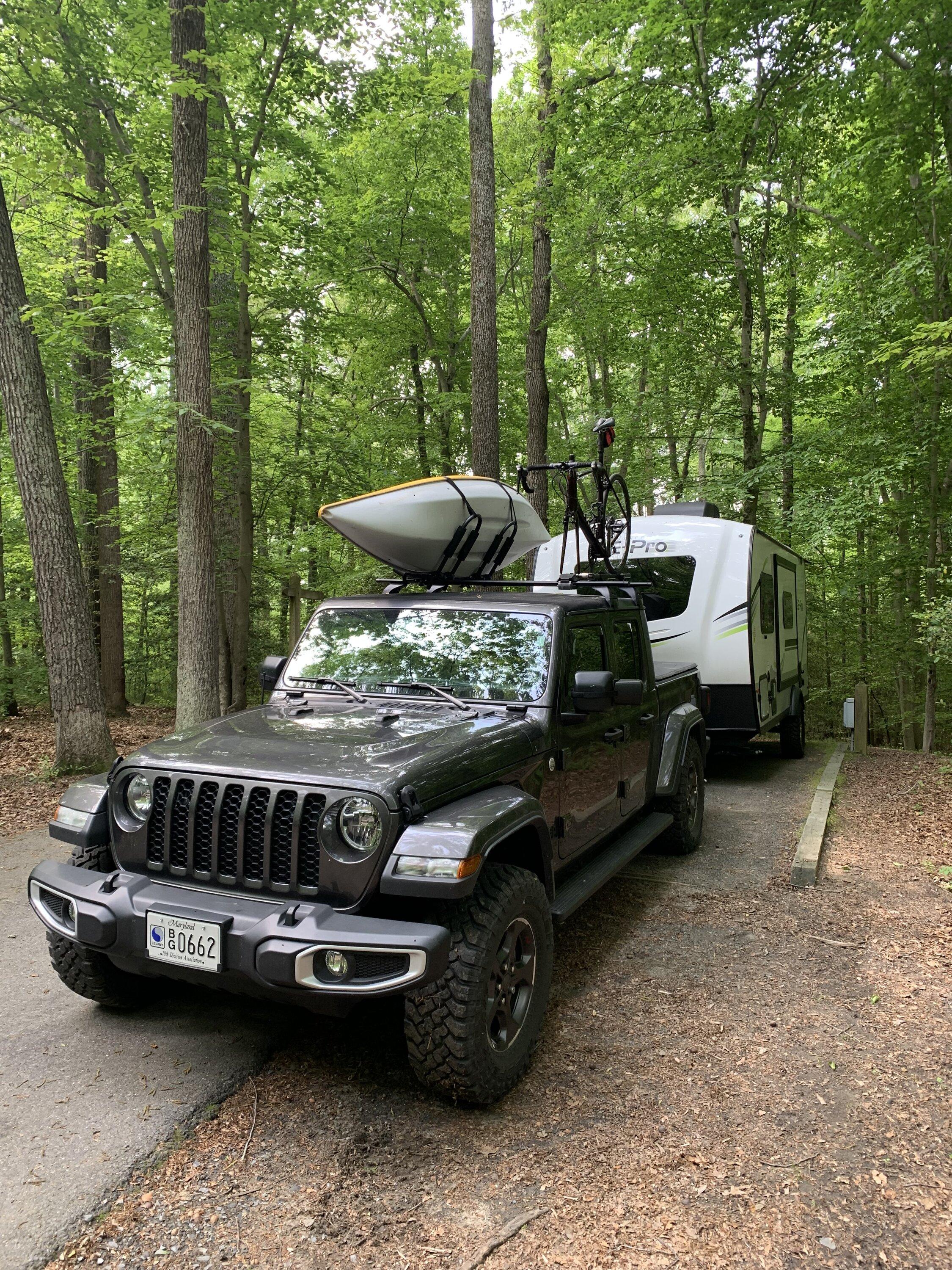

After this subject string I started looking, and low and behold, Mopar makes a set for the JT, $240, fit the rain rails, but specifically says not to attach to the front removable panels. If they sell them I would think they have been vetted to work in this application
MOPAR rails (installed/located per MOPAR instructions), 10' kayak on Curt holders; road bike on Yakima bike rail.

Looks good. So thats what the mopar rack looks like. Im getting that rack, mostly due to it being designed for the truck. I have two 10' kayaks so will use a double Curt holder in a side by side set up. Anything unique w putting the holders on? Are they stout enough for interstate runs? Appreciate it
For both the rack and the Curt holders, the first component installation required some trial and error with the instructions. Then the rest were easy and quick.
Regarding interstate driving, they should be fine. I’m still doing the initial towing 50mph for 500 miles break-in period (separate from the new vehicle break-in). So at 50 mph with occasional increases to 55+, I had no problems at all.

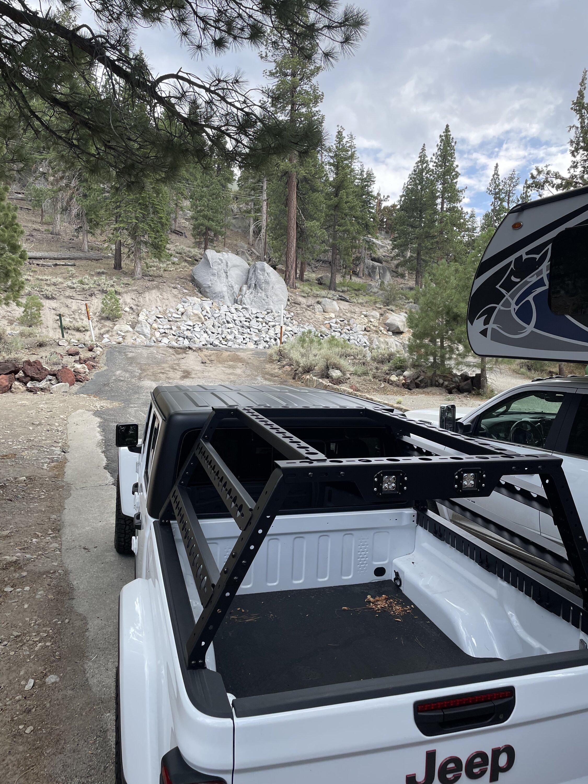

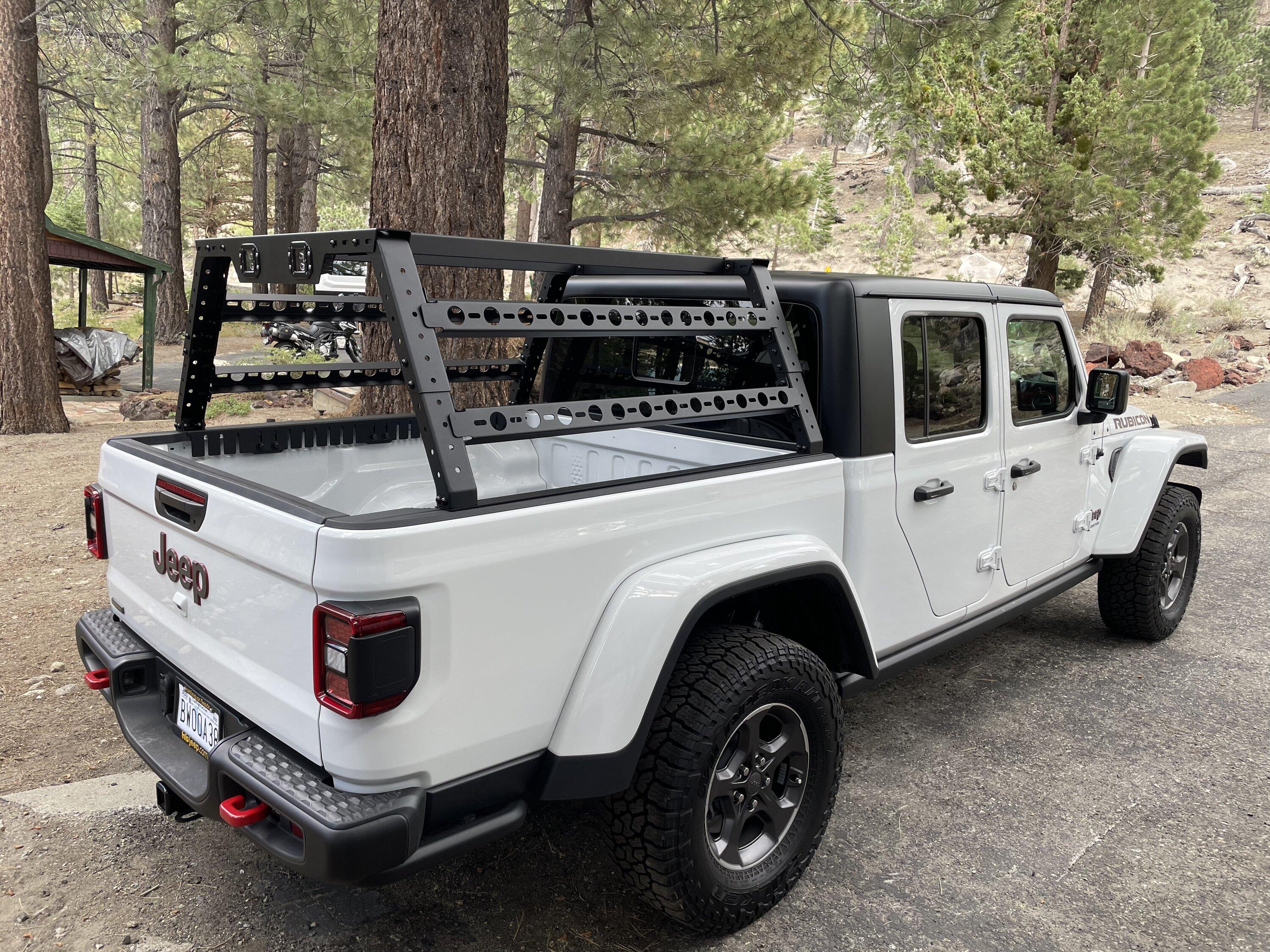

The Front runner still has drilling into the top but the front supports look like they would take most of the weight and you wouldn’t have to worry about uplift with big profile wind catchers like kayaks etc.
I just picked up a Max modular lookalike on eBay for $450. Had to drive to Rancho Cucamonga but it was worth it. Super beefy so I can carry lumber if I have to. I’m looking for a roof rack to secure the front of long pieces but trying to be realistic about weight limits. I don’t want to drill into the top but I don’t want to pay $3k for a full cage either
Jeep Gladiator Need some help picking a roof rack 22D6DA0C-6CE9-4D2F-ABD9-2B64EF23F5E5
Jeep Gladiator Need some help picking a roof rack 1DEAD73E-2D44-4EBA-8670-13757165A02F
