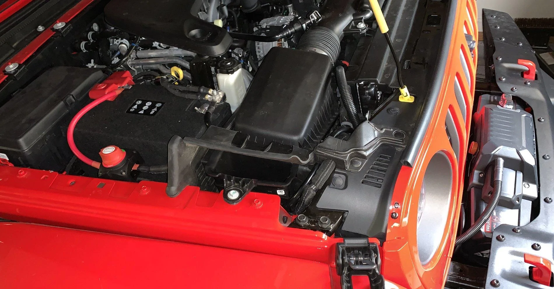

My Apex mounting. Rubicon steel bumper. Warn winch plate.
i moved the positive cable from the back to the side so it wouldn’t rub on the grille. I also had to cut down the engagement handle so not too rub on bumper.

Do you mind sharing with me how you re-routed the positive wire to side like that? That hole is perfect! What tool did you use for that hole and did you get anything to plug the original hole? Thanks!
The case is soft metal. Start with a small drill bit to center the hole, then use a step bit to make the hole big enough for the cable. Not to worried about the original hole, because that box is not waterproof. I'll probably stick a whiskey cork in it.

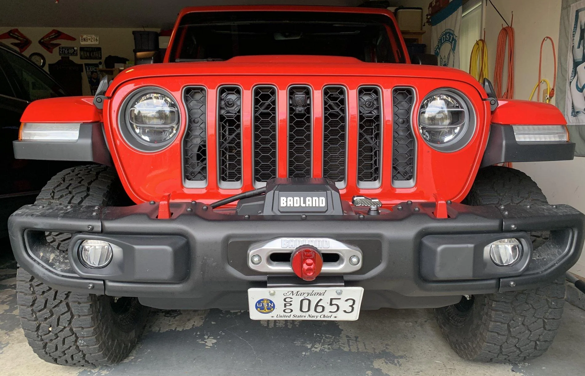

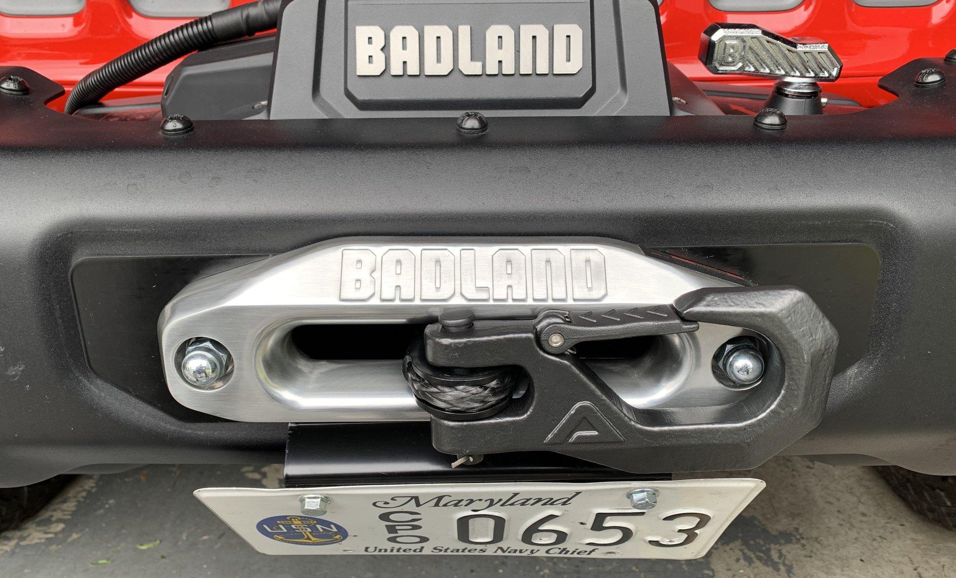

Warn winch plate with Poison Spyder spacer plates from Northridge 4x4. Need to get longer bolts for the hawse fairlead, but pretty happy with the install.

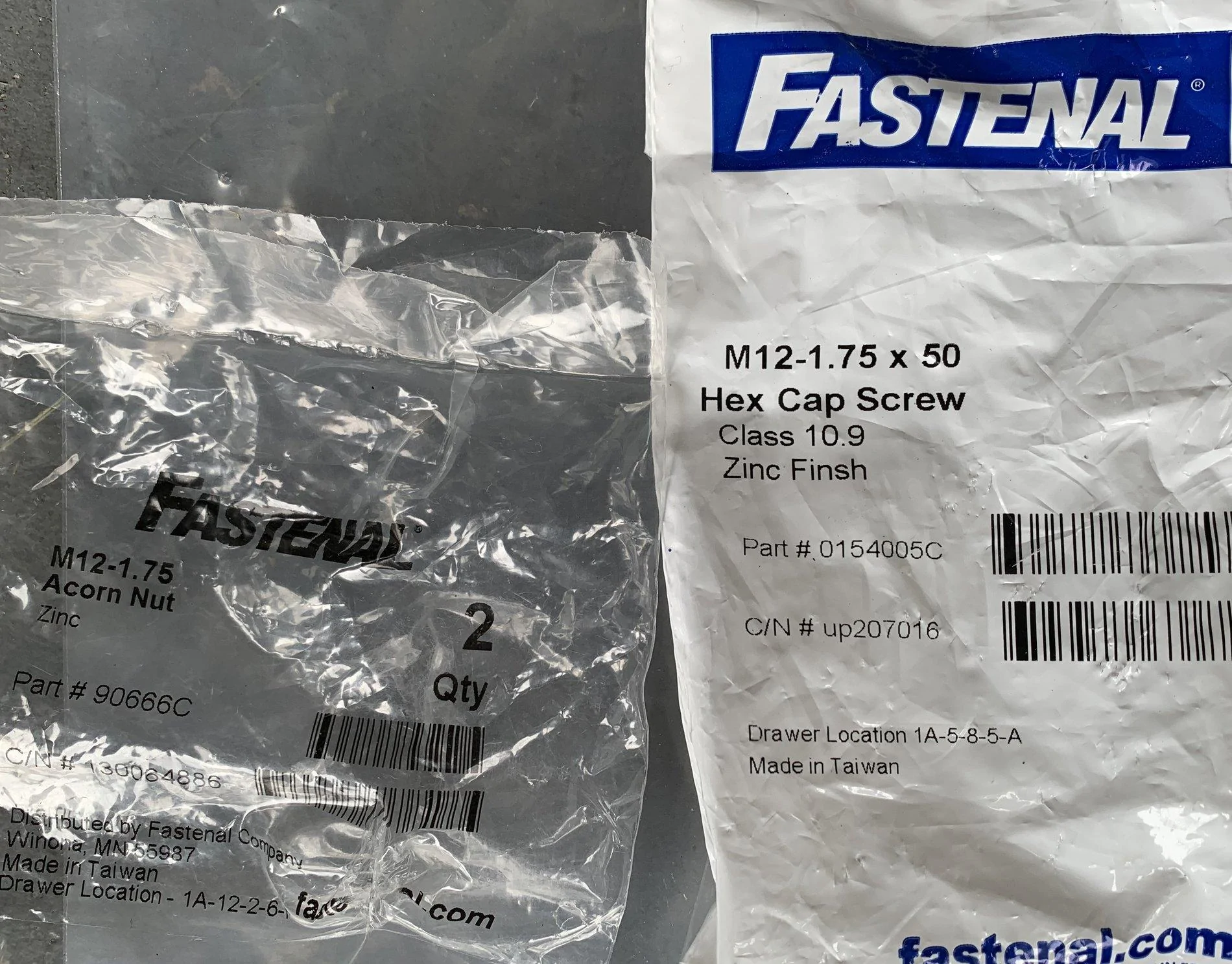

Went to Fastenal and got some bolts and acorn nuts. The bolts supplied with the winch are Grade 8.8 M12 x 40mm. I went with Grade 10.9 M12 x 50mm, because they are stronger and longer but more importantly that's all they had in stock.

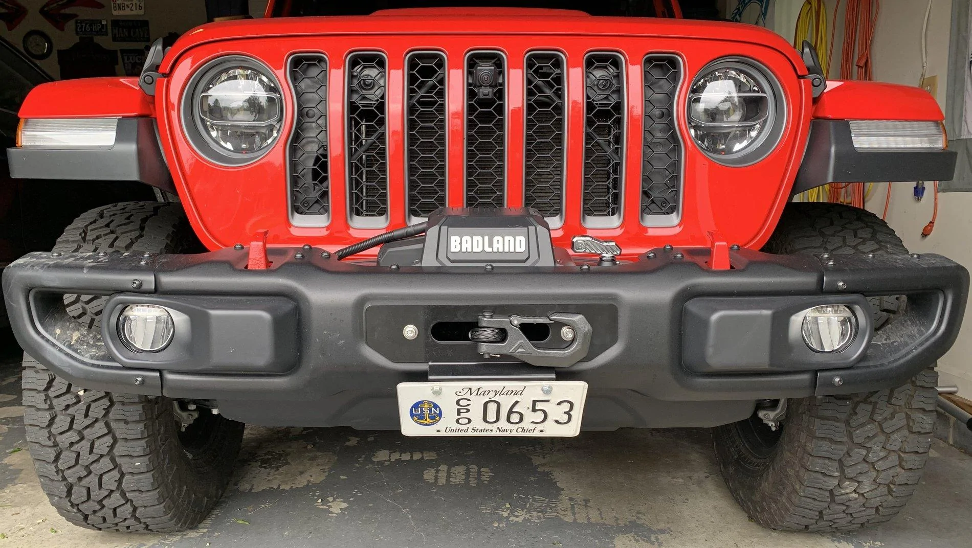

Great price! Have fun with the install, I just completed mine with a shackle mount.
