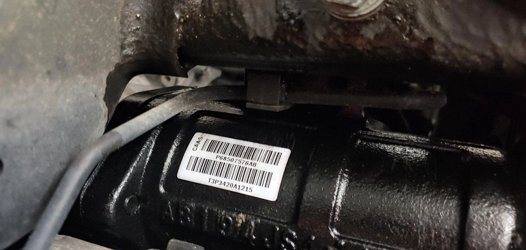

2 SEP 2020 UPDATE:
2020 Jeep Gladiator (JT) Rubicon
Ordered 9 June 2020
Received 21 August 2020
Got it back last night and while it does drive different than before it went in, I can say it is a definite improvement.
For those following this thread and waiting their turn for the repair, here is the pertinent info:
TSB#: 08-074-20 (dated August 10, 2020)
Original OEM aluminium steering box PN: P68418449AE
New / Replacement OEM steel steering box PN (IAW TSB): P68507576AA

OLD original 2020 gear is gray/silver because it's an aluminum housing.
NEW or replacements are all black because they are painted steel housings.
NEW replacements should currently be AB part number. The first ones in 2020 were AA and the part number in the TSB was AA but that was superseded.
Jeep Gladiator New JT Gladiator Steering Issue TSB 08-074-20 (for "Improved Steering Feel") 20210506_123436_HDR
THIS is the latest TSB I could find, dated about January, 2021 and it does not include 2021 models.
