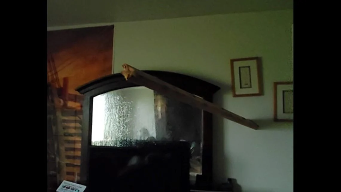

I drove mine in winds in EXCESS of 80 mph and I was going 80+ and passing other vehicles in a mad rush to get home before the storm from hell hit us. And I didn't have trouble keeping the truck going where I wanted.
(I have found now that the winds hit 140 mph - and here's a pic from the INTERIOR wall of a house not that many miles from us - the town where I was raised - yes, that's one of multiple 2x4s and yes, that's an interior wall )
Wow that is crazy. I have had my Gladiator for 1 year today, and it finally drives right. 364 days of crap driving, but i am ecstatic it is finally fixed!
