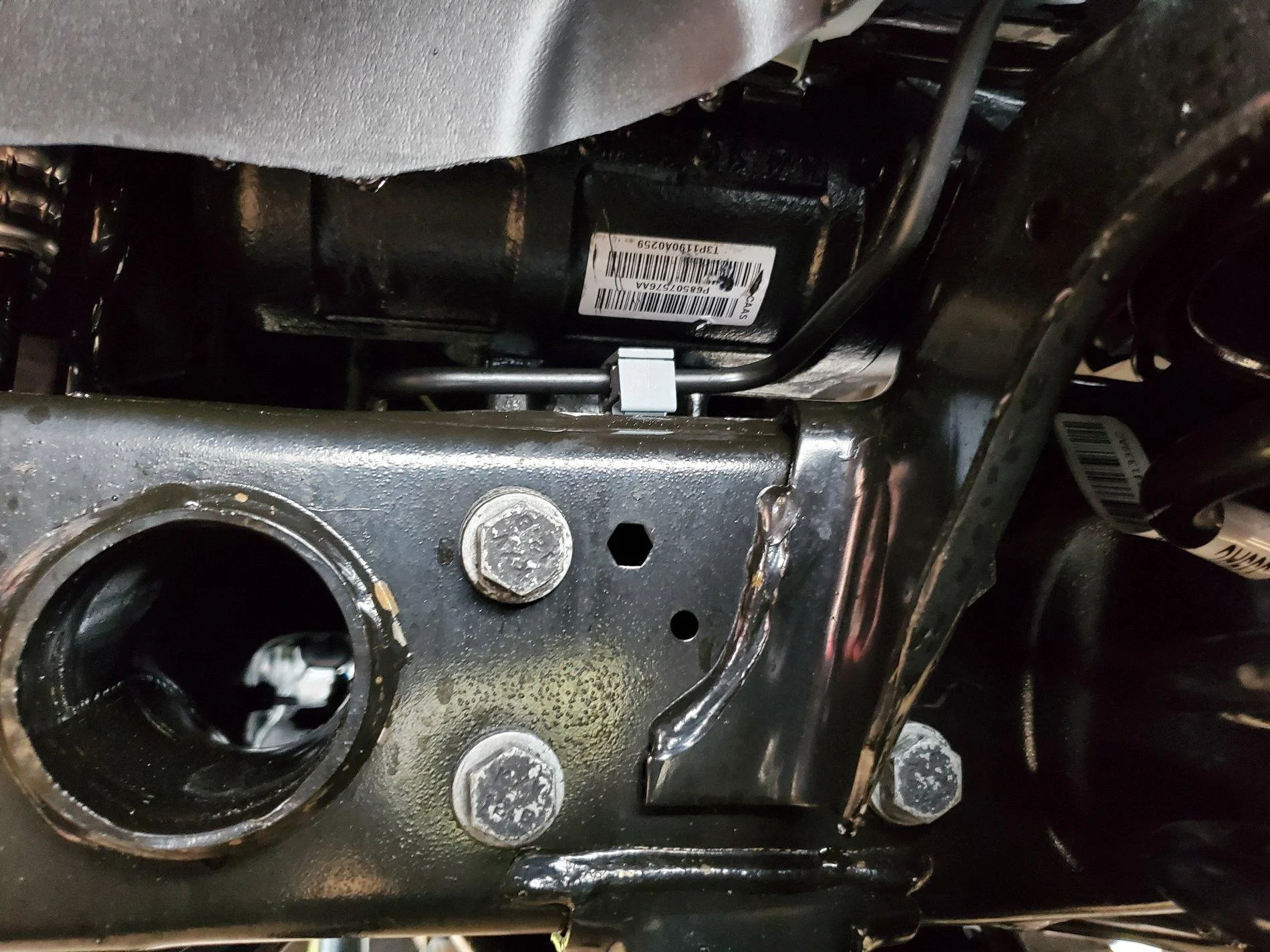

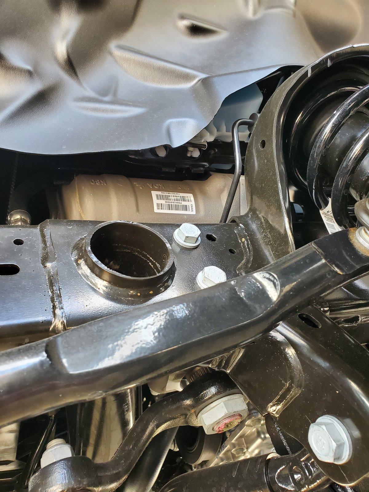

Dropped mine off on Saturday (8/29) with the service department of the dealer from which I purchased.
Conversation with the service advisor (SA) elictited their response that they were aware of the TSB and that of all the JT's they have sold, they have had only had 1 other complaint to date.
I replied that I really found that hard to believe or that those other owners are unware an issue might actually exist.
My description of the issue to the SA continued with included statements of having driven other JT's both with and without the problem, as well as having someone else drive my JT, and then adding the phrase "fearful of my safety while driving on the interstate while working abnormally hard to maintain my lane alignment."
The tech looked at it yesterday (8/31) and confirmed there was indeed something amiss that matched my description of the issue. The part was ordered and should be available today (9/1). As far as the bolts go, I am not yet aware of their status / availability for my replacement task.
I'm looking forward to checking out the repair results.
2 SEP 2020 UPDATE:
2020 Jeep Gladiator (JT) Rubicon
Ordered 9 June 2020
Received 21 August 2020
Got it back last night and while it does drive different than before it went in, I can say it is a definite improvement.
For those following this thread and waiting their turn for the repair, here is the pertinent info:
TSB#: 08-074-20 (dated August 10, 2020)
Original OEM aluminium steering box PN: P68418449AE
New / Replacement OEM steel steering box PN (IAW TSB): P68507576AA
Pictures for reference:
Old:
Jeep Gladiator New JT Gladiator Steering Issue TSB 08-074-20 (for "Improved Steering Feel") Old Aluminium
New:
Jeep Gladiator New JT Gladiator Steering Issue TSB 08-074-20 (for "Improved Steering Feel") New Steel
TSB Parts:
Jeep Gladiator New JT Gladiator Steering Issue TSB 08-074-20 (for "Improved Steering Feel") FB_IMG_1597157685009
