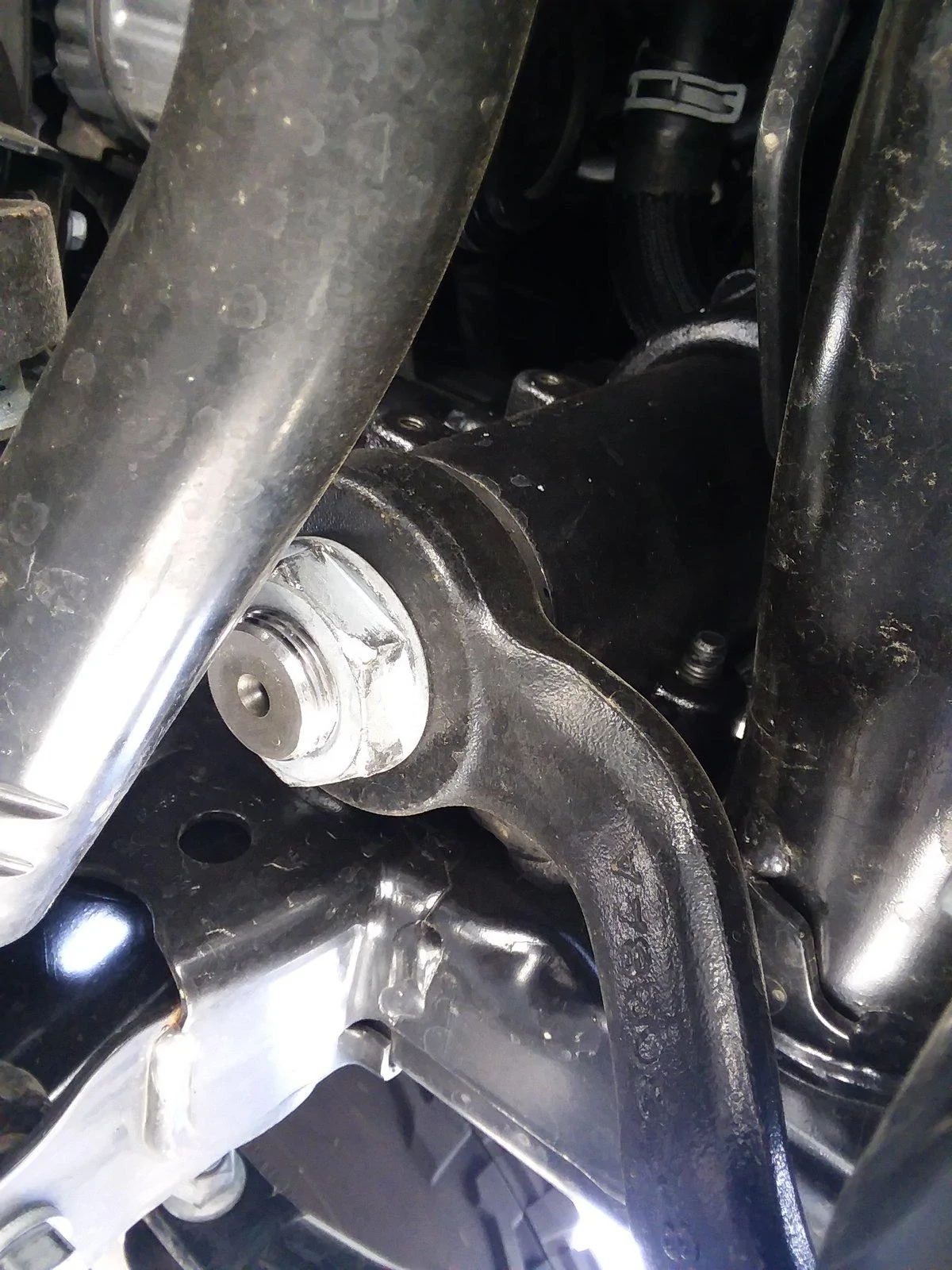

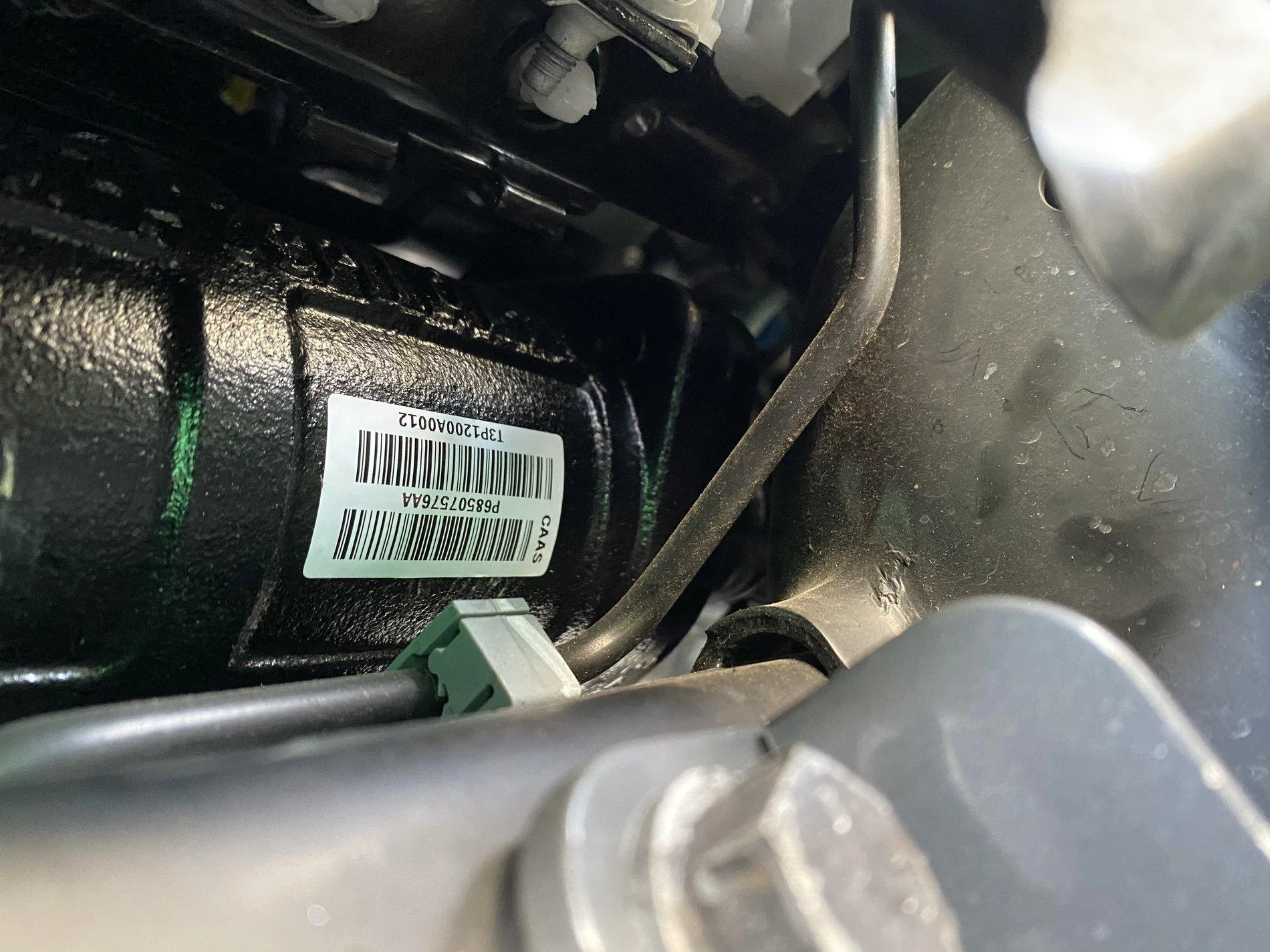

New steering gear installed today. Couple QC questions.
1. Aft bolts look normal with approx 1/2" exposed threads but the front bolts are very long with approx 3" of exposed threads. Are these the correct bolts? Doesn't look right.
2. Who much tow-in should there be? I roughly measured approx 1/4"
Note: Jeep drivetrain is sock to include Rubicon 33" tires
Regarding steering improvement, I did notice a different/improved steering feel on the way home. It feels like steering inputs at higher speeds are now slightly dampened and/or the rate of correction is reduced. Too early to really tell but tracking also seems to be improved. Looks like they did a good job, no big messes and fluid level was topped off though steering wheel was no longer centered, off just a little.
Thanks, Jack
That does not look right. Are those loose bolts? How about a couple more pictures from different angles?

Here is a picture of mine, just snapped it. The dealer used the wrong bolts on yours. I wonder if they are from the hardware store or the old box...

I just crawled under mine and can say it does not look like that
