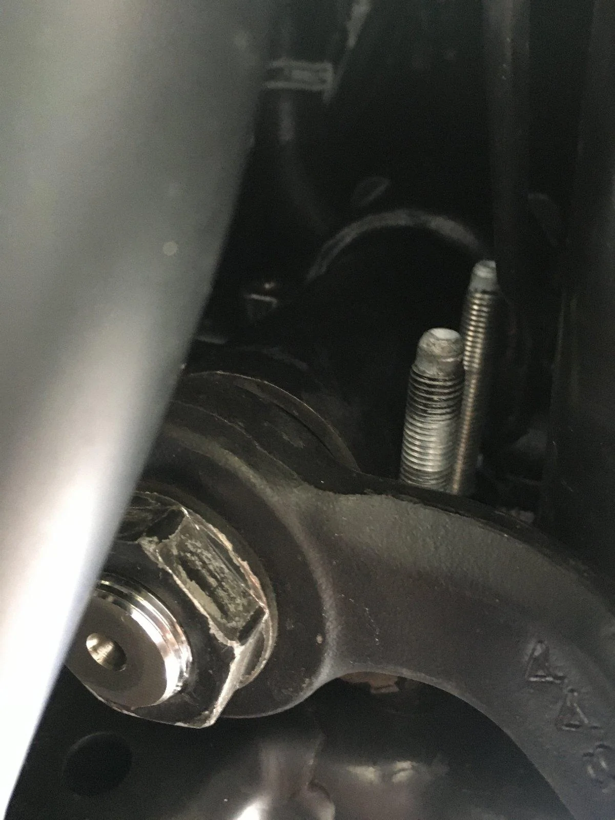

New steering gear installed today. Couple QC questions.
1. Aft bolts look normal with approx 1/2" exposed threads but the front bolts are very long with approx 3" of exposed threads. Are these the correct bolts? Doesn't look right.
2. Who much tow-in should there be? I roughly measured approx 1/4"
Note: Jeep drivetrain is sock to include Rubicon 33" tires
Regarding steering improvement, I did notice a different/improved steering feel on the way home. It feels like steering inputs at higher speeds are now slightly dampened and/or the rate of correction is reduced. Too early to really tell but tracking also seems to be improved. Looks like they did a good job, no big messes and fluid level was topped off though steering wheel was no longer centered, off just a little.
Thanks, Jack
Those bolts ain't right.
Toe on mine has always been 1/4" and that's pretty typical for other vehicles. Don't know the Jeep spec in inches, they tend to do degrees.

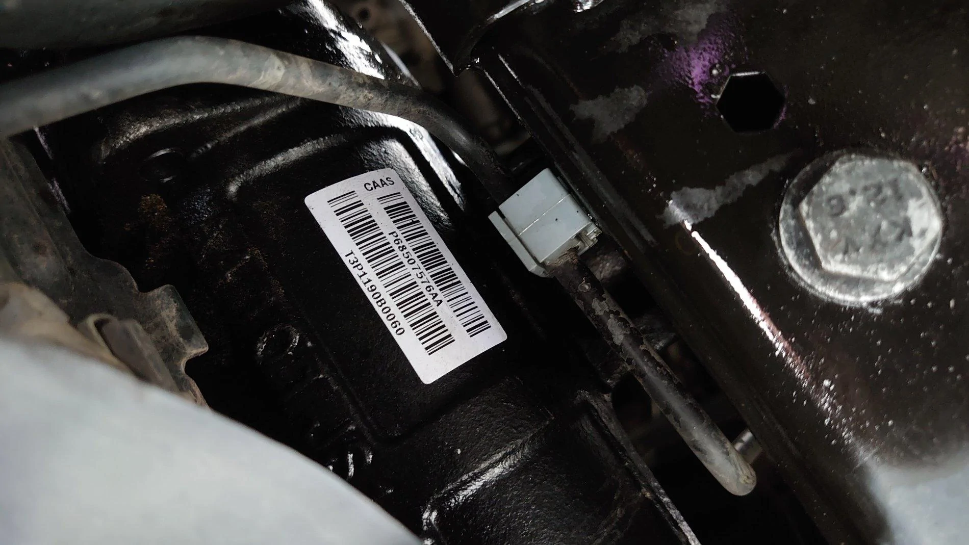

Picked mine up today! Checked and all seems good, got the right part and wow, drives nice so far! I will be taking him on the highway tomorrow to see how he handles. But so far, just around town, I could definitely tell the difference. At first, I was over correcting, cause that's what I used to have to do, so I might need to get used to not having to do that anymore. :)
Oh, my sister said she noticed a difference while riding in the passenger seat.
I went to the Laurel, MD Jeep dealership. If you are in the area, they were pretty quick about it to, didn't give me any issues.
