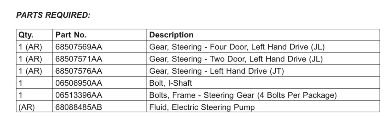

I have a process question. When does the service/parts department order the parts required by the TSB? Are the parts ordered when the appointment is originally scheduled so that the parts are on hand when the jeep arrives on the appointment date or after the Jeep is at the dealership for the first appointment therefore the customer has to schedule a second appointment for the work to be performed?

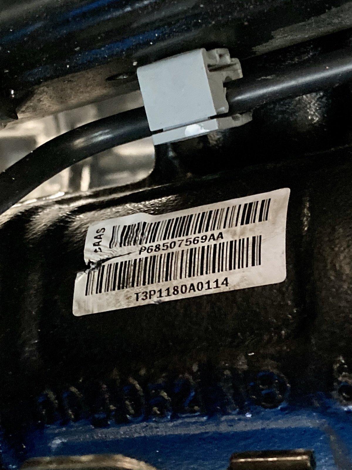

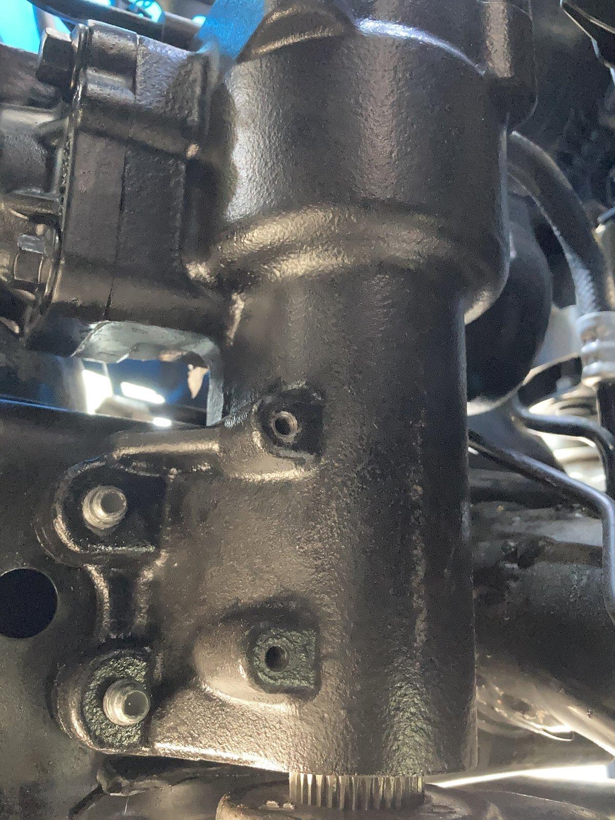

Currently sitting in the dealership for the second day in a row. After 2 weeks waiting for the part, I brought it in yesterday. After they completed the swap the steering was actually worse. Much more play. Also got a new "notch" feeling that other have described as an added bonus. They said it will need an alignment so I had to bring it back today to have that done. Alignment complete and no improvement whatsoever. Now they are suggesting that the replacement box might be bad. I bought the Jeep new 2.5 week ago and it has 900 miles on it. I'm astounded by what a complete and total cluster this has turned into. Beyond disappointed.
I remember seeing an earlier post about the boots missing threads but it being a non issue. Is that correct? Because this is what my new box looks like:
Jeep Gladiator New JT Gladiator Steering Issue TSB 08-074-20 (for "Improved Steering Feel") 41CFDA32-EC5E-44B3-B1B3-34E354EEC15B
Jeep Gladiator New JT Gladiator Steering Issue TSB 08-074-20 (for "Improved Steering Feel") 2E6A1A75-CC13-4EC4-B547-230705589DAD

Has anyone figured out the notchy feeling? It’s driving me crazy. Dealer is stumped

Sorry to be the bearer of bad news, but you got the part for the JL
YES! Love it. Classic dealer incompetence. Typically not this negative but these guys bungled this from the start and it's been a headache throughout. I just spoke with them on the phone and they admitted the mistake and are ordering the correct part. Mind you, this is after I had to tell them to perform the software update (per the TSB) after they told me the fix was complete and hadn't done it. What a mess-
