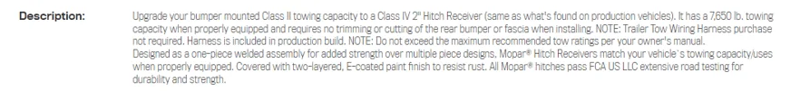

Horse trailer - in case of emergency only - not a regular job.
This is the hitch they put on - say the sport is already prepped for hauling 7650
It's only rated for 7650 if it comes Factory equipped with the Max Tow package. The major components of the Max Tow package are cooling fan and alternator upgrades, along with progressive rate springs to handle the weight. These components can be separately added, after the fact, but it doesn't change the rated towing capacity or the numbers on the factory printed door labels.

Wow, they’re scum if they’re trying to pass off bolting on the Mopar receiver as being the same as Max Tow. Any ordinary person would read that and be totally unaware that they’re not actually “properly equipped” as caveated in that blurb
To be fair, the receiver is quality and I’d have no hesitation moving a horse trailer around the yard and in emergencies. Just know the cooling isn’t there.
I couldn't find any numbers other than the weight of truck on the door label. I'm still waiting to see what they actually did but my hopes are not high.
