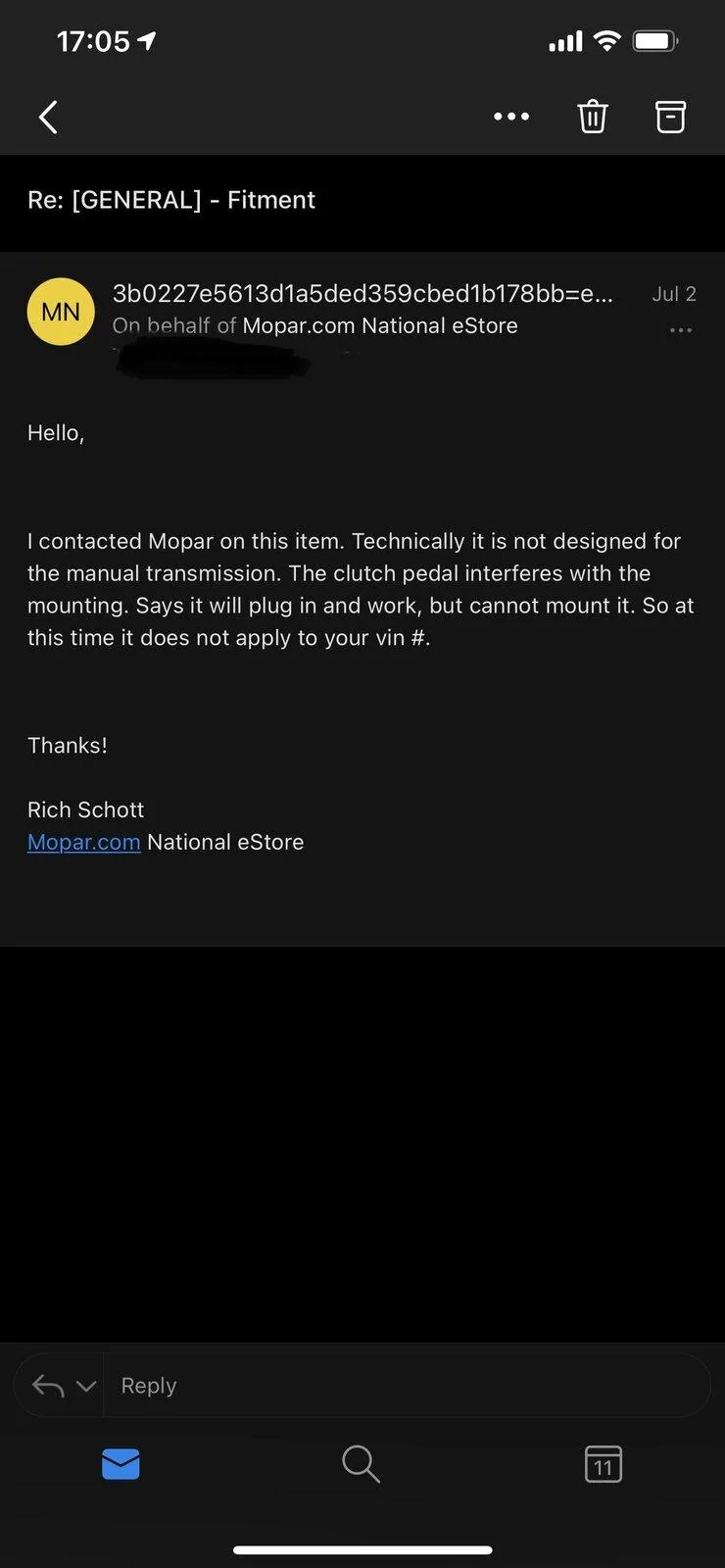

I asked about this and eventually received this answer from Mopar. Should not be a difficult obstacle to overcome.

I'm not a gear head by any means, but how does the clutch interfere with the lighter port for mounting?

There is a little box that also mounts under the steering column that plugs into the wire harness.
So I've got one now that plugs in and works, and doesn't interfere with clutch at all. Is this mopar different in how it's connects? I have the tekonhsa
40,514
54,041
Easy solution - move the box install to a different spot,
It's where it was made to be mounted. It's on a bracket that attaches to the area at the left kick panel, and it's not as small a setup as some others are.
It's not different other than their mounting plate, instructions on where to mount it, size of the control module itself.
There's the knob - goes in the 12 volt outlet area, there's a cable from the knob/dial to the controller itself, then a cable from there to the truck's harness. Pretty much like most of them. Basic stuff.

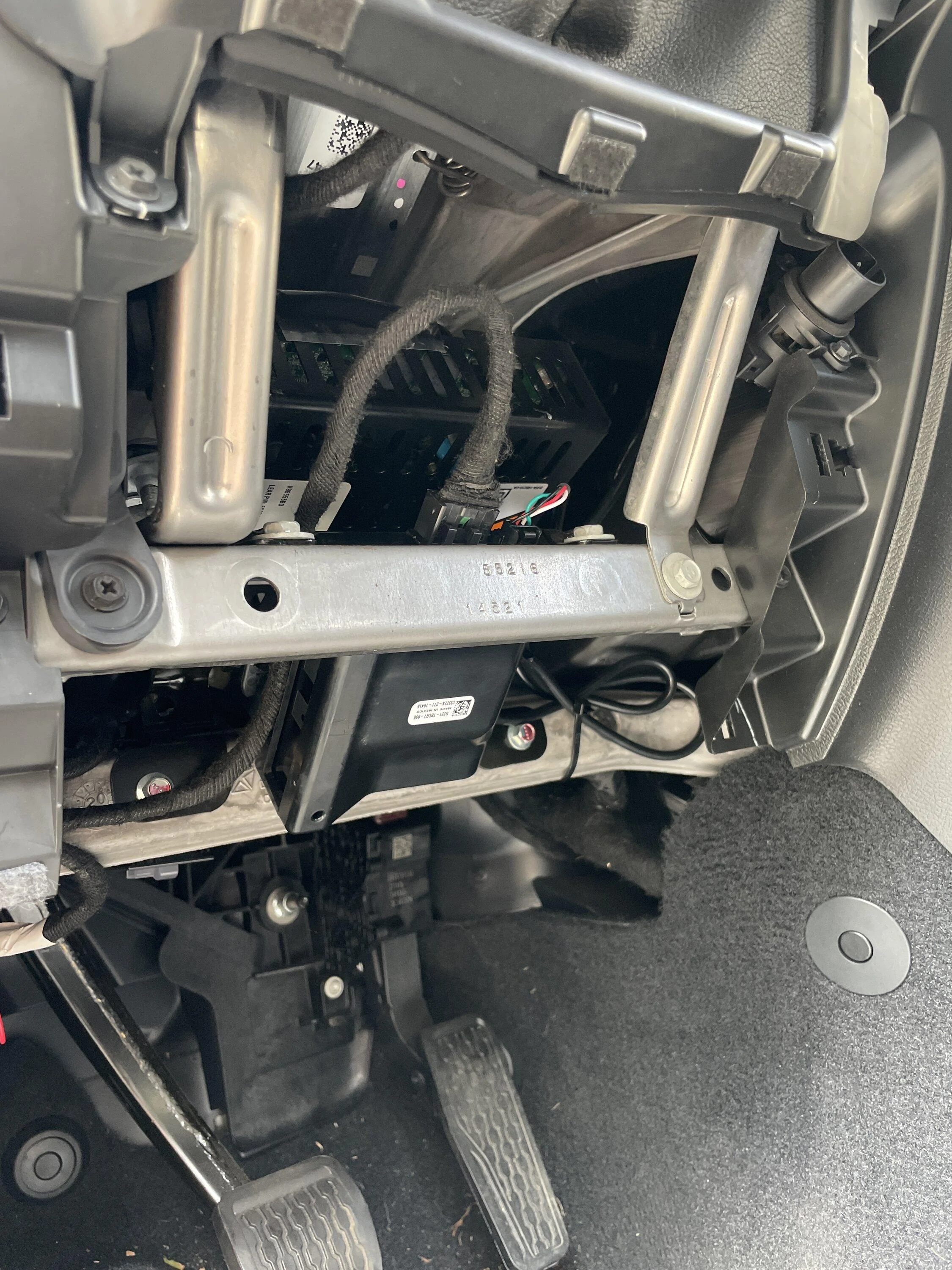

FWIW I literally just finished installing the Mopar trailer brake controller on my MT Mojave. It works great, all I had to do was get creative with where to mount the module. There’s physically no way to mount it on the aluminum bracket where the instructions say to do so.
DocGladiator
Aug 11, 2021
Chesapeake, VA
2021 Jeep Gladiator Mojave
And for those of you are probably going to ask where I mounted the black box: I took off the steel back plate and just used some zip ties to mount it under the steering wheel. I’m sure some of you more fab savvy than myself could easily come up with an even better solution. But mine was fast and easy and required no drilling.

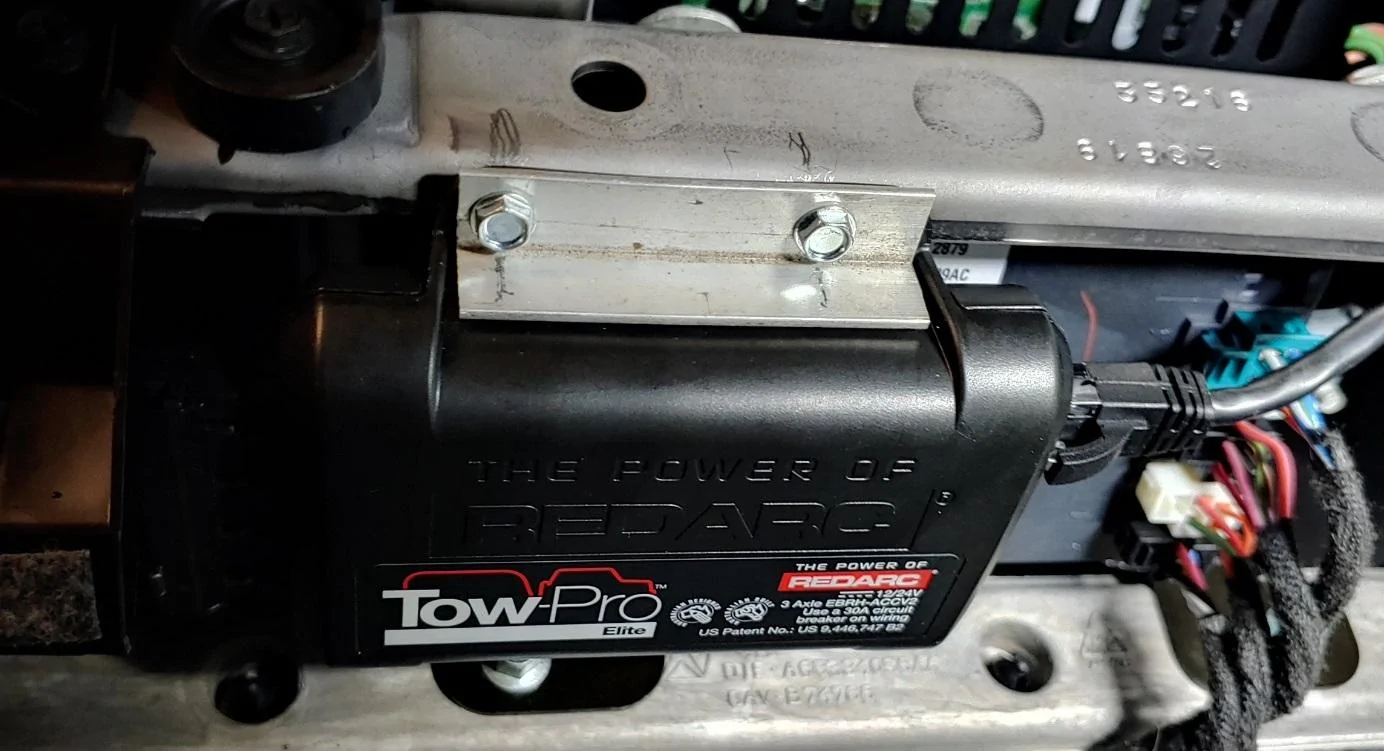

I had thought of doing similar - mounting it in the same area I had a REDARC controller......
