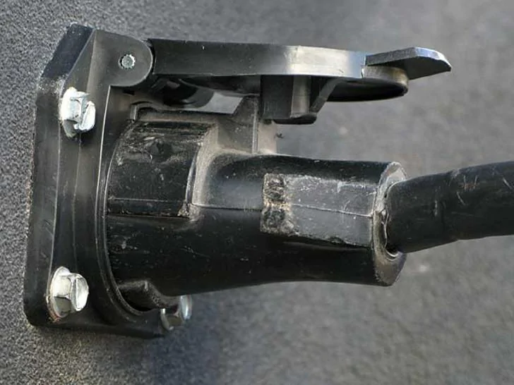

Anyone having trouble with the Echo working loose? it hangs pretty far out. I know they give you a strap to retain it but looking to hear form folks that it's not a problem.
not one issue. I didnt realize it until I got the echo but the 7 pin plug has a little notch of plastic on the opening that holds the echo in there (See pic...not of truck...rando google image)
I used to use the retention strap but it flew off a while back. I do have a short Velcro strap I got from amazon that I use for long trips just for piece of mind but the little notch does its job well.

Yeah, thanks. I know this tab is there to retain things but was curious if with the Echo hanging so far out it has a bit of leverage and weight to cause it to droop and perhaps work it's way out from under that tab. Just looking for confirmation that this isn't a problem and it sounds like it isn't.
