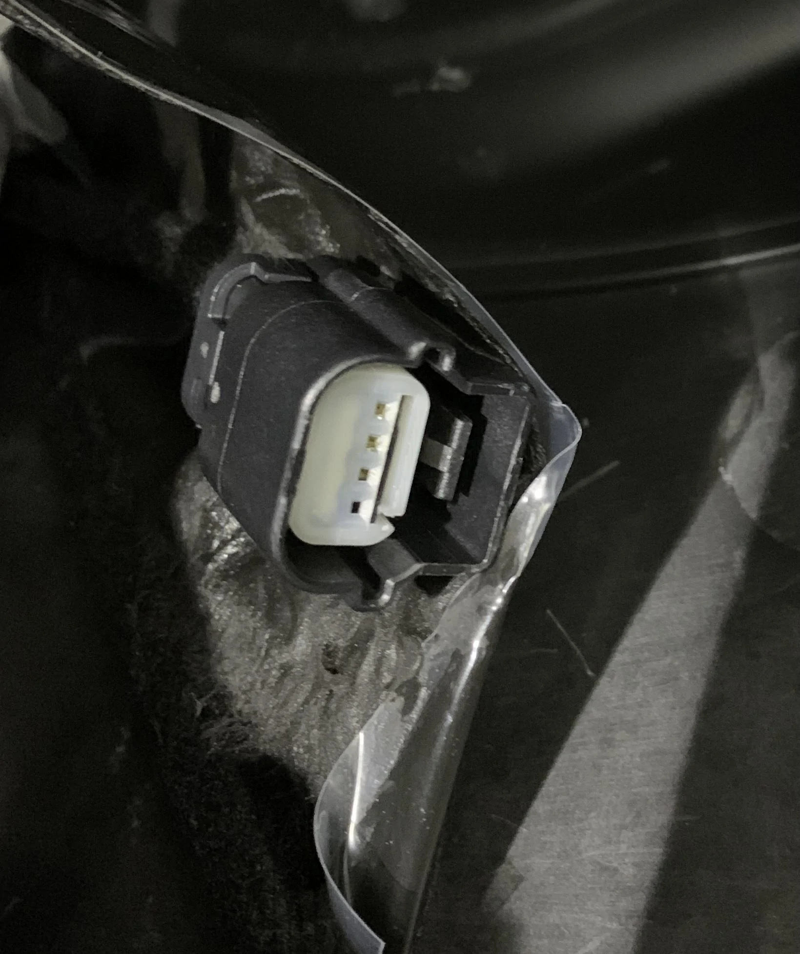

I recently installed the Mopar trailer brake controller in my Gladiator that was built in February of 2022. There was a second wire harness connector not used for the trailer brake that was tucked into the area where the module gets bolted in place. It was held there by a several square inch sheet of a sticky substance with a plastic backing sheet. Anyone have any ideas what this is for? Picture attached.

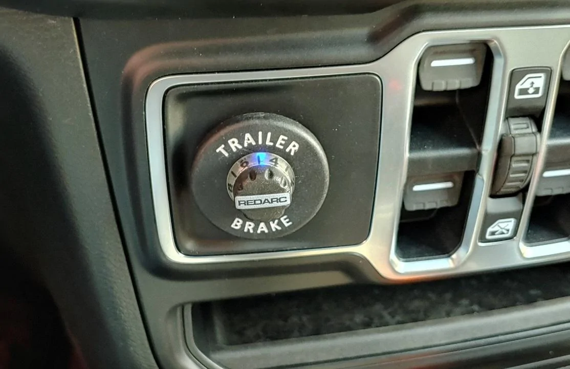

Unrelated, do any of the 3rd party options (excluding Mopar) fit in to the same dash spot? That is unused space for me, would like to use it when I add the controller.

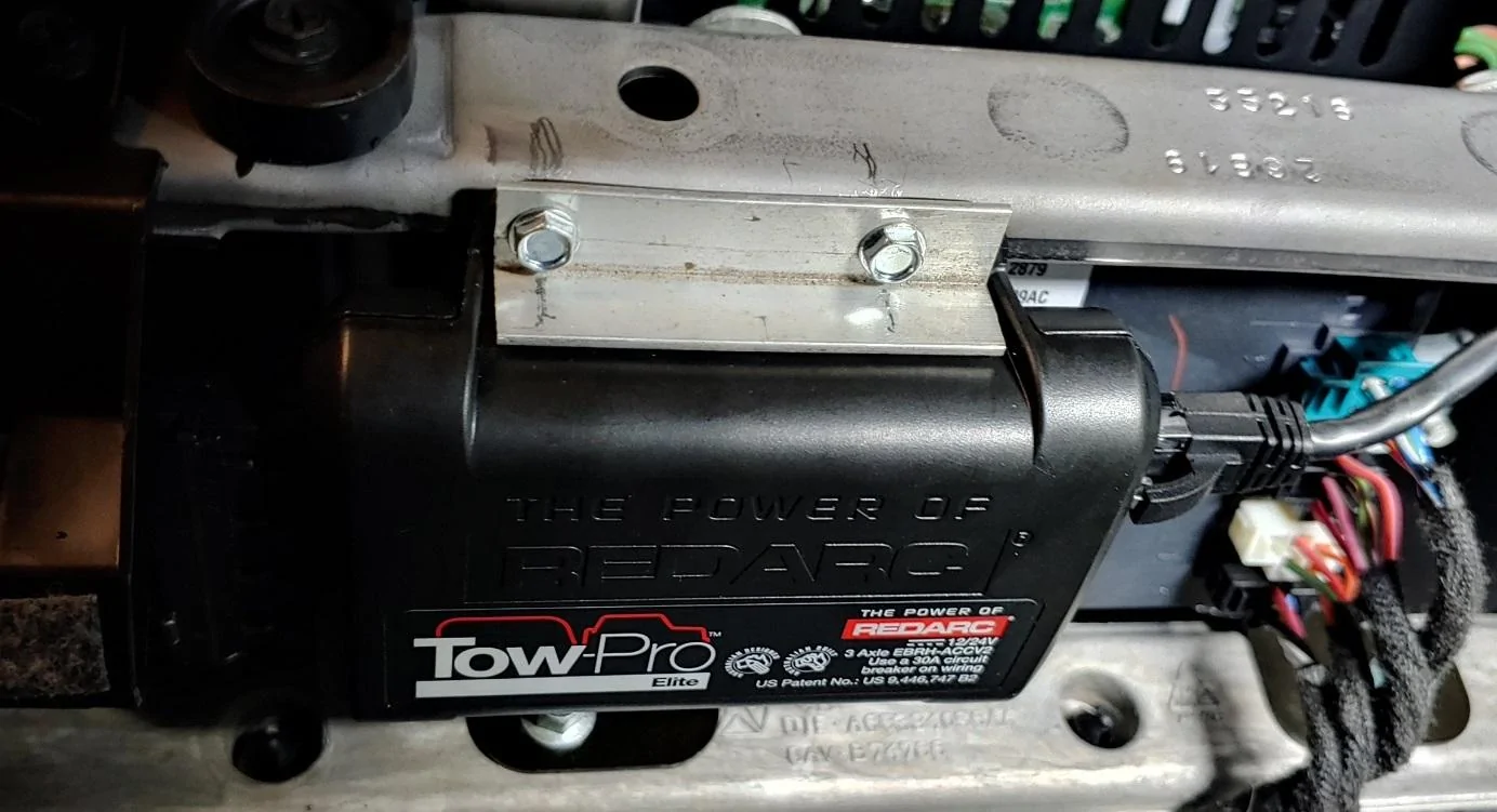

This is how I installed a Redarc controller in the 12v outlet area which is how the MOPAR version goes.
Jeep Gladiator trailer brake controller for 2022 Jeep Gladiator 18-20200915_144204_HDR

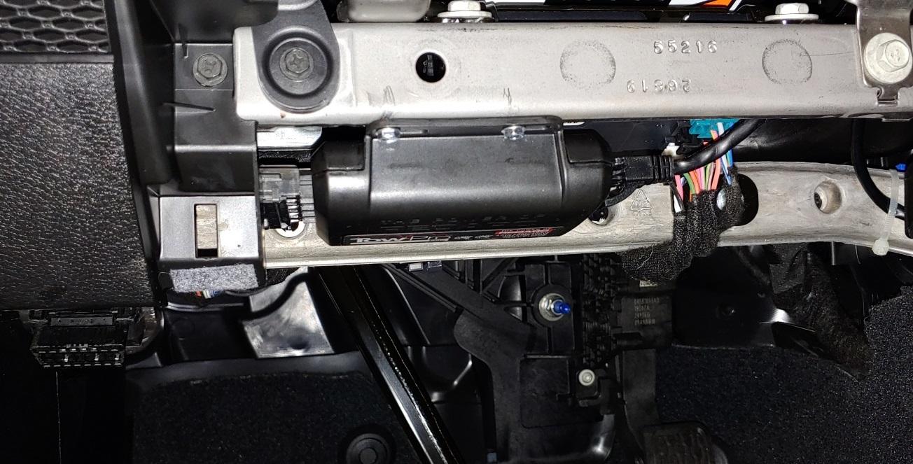

I put the box here, behind the panel under the steering column, but later added a small aluminum bracket to help support it...
Jeep Gladiator trailer brake controller for 2022 Jeep Gladiator 11-20200915_111801
Jeep Gladiator trailer brake controller for 2022 Jeep Gladiator 13-20200915_114640_HDR

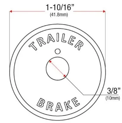

The 'ring' above is pn# TPSI-003 ($9.50 on the Redarc website)
