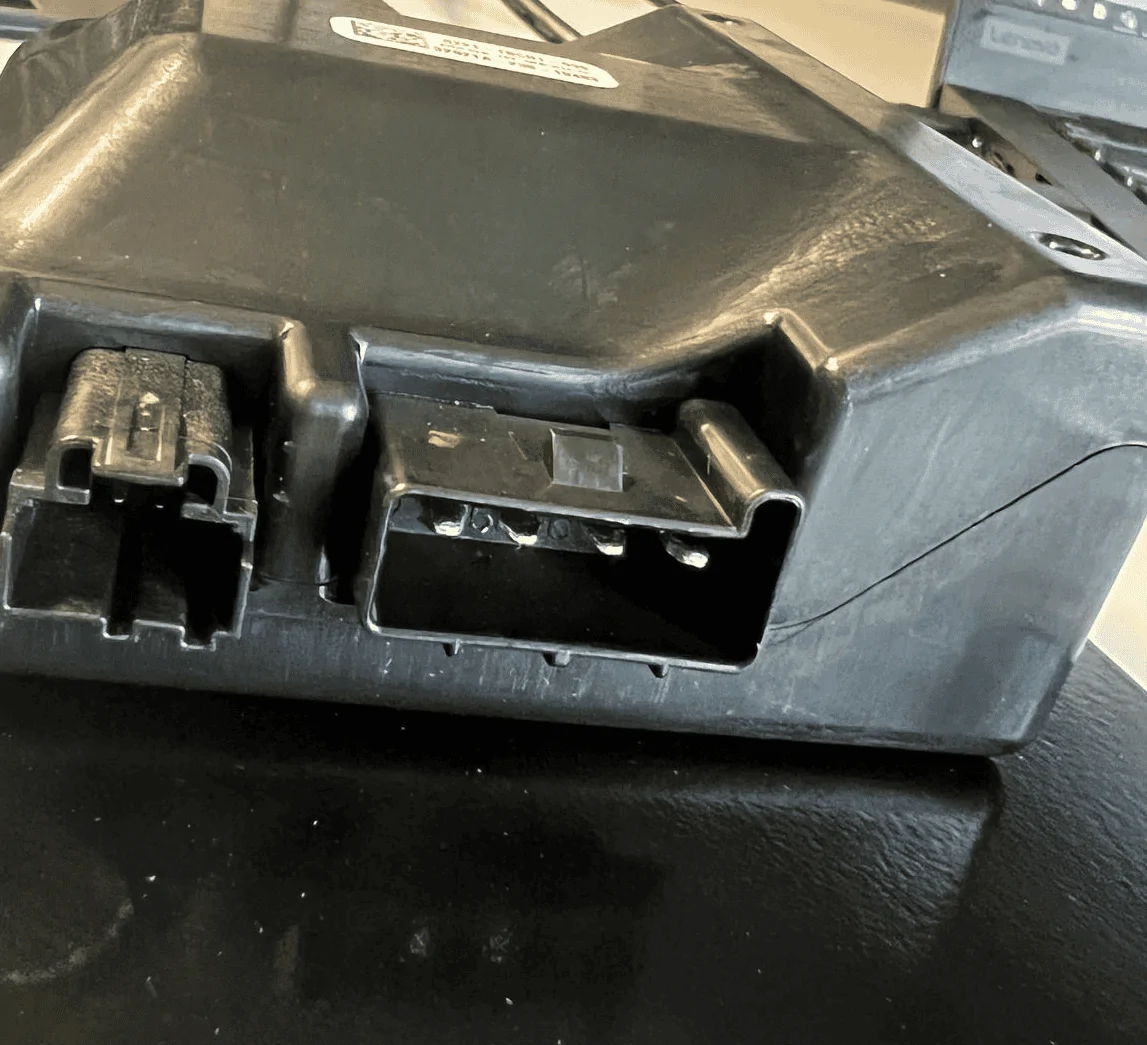

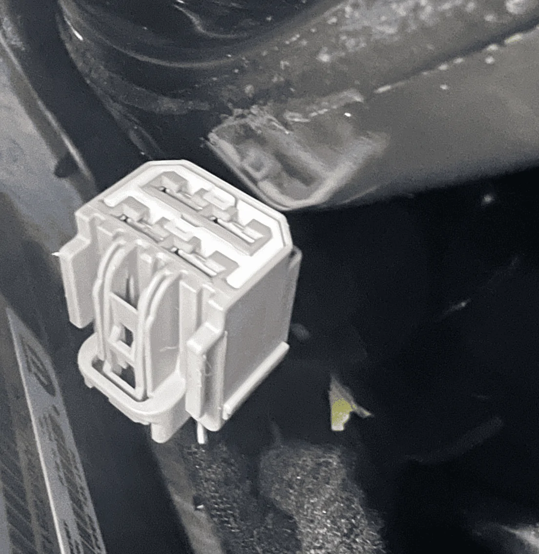

Hey Gang,
I've got a 2022 JT, and a Mopar TBC, and the plug under my dash does not match the controller module to be mounted under the dash :/
Jeep Gladiator trailer brake controller for 2022 Jeep Gladiator 1649278660198
Jeep Gladiator trailer brake controller for 2022 Jeep Gladiator 1649278683938
Is there a harness that can adapt this? Potentially the Redarc TPH-022?

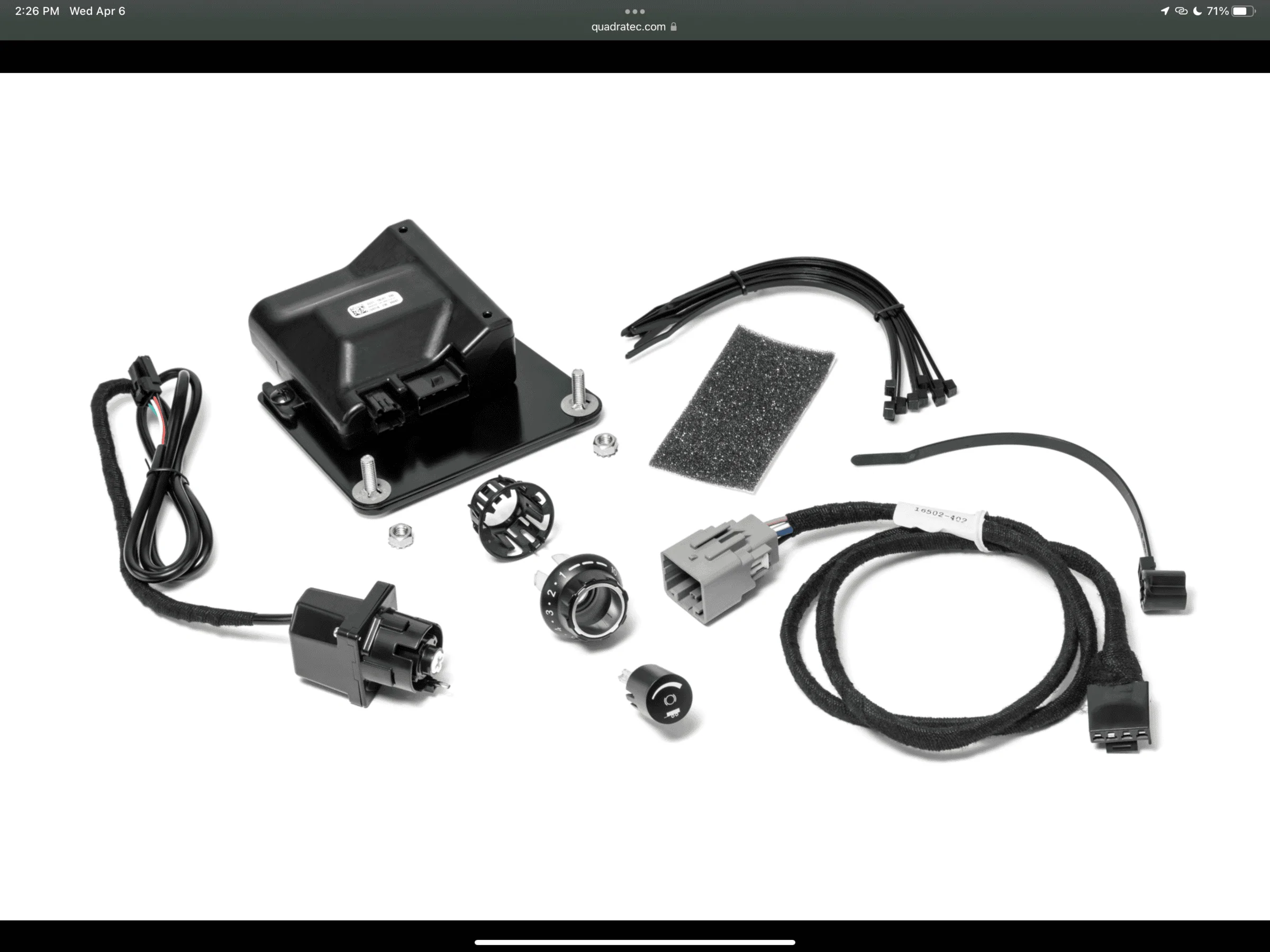

Hey Gang,
Should’ve came with a cable to go between that plug and the control box. It’s the cable on the right.
Jeep Gladiator trailer brake controller for 2022 Jeep Gladiator 047F7FD2-17B4-4DCF-A672-CBD82A6D1875
No sooner did you post this, I found the missing harness underneath my passenger seat, must have dropped it. apologies for the misdirection.
Thank you-
